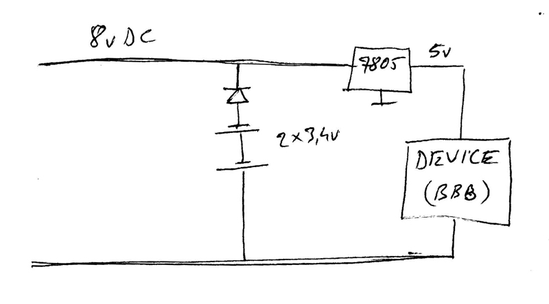

I think to suggest you a very simple, but efficient UPS, or backup solution, which may fit well for the currents used in this project.
Actually there is not exactly an UPS, but more a backup solution to sustain the system while it shutdown.
The absence of 8v can be detected and initiate shutdown sequence. The battery will deliver power to the system at once the diode is unblocked by the absence or too low 8v rail. An quite small cap at the output of the 7805 regulator it can compensate for diode`s switching time. Here is however about very short switching time...
It may be added a charger circuit for the battery and all this "design" put it on a PCB (same dimensions as BBB). A backup cape...
As the battery will be in use very short time, its power can be delivered very long time without charging, but a very simple charging device it can be added.

Hi Jean-Louis
Well, there is illustrated here the idea back a such solution. There are not all the hardware details. But, in my opinion is a cheap, effective and safe solution. It need only to be a little bit more elaborated.
The principle here is that the diode is blocked when it have a higher positive tension level on its cathode, than on its anode. When the higher tension disappear, or goes lower than another one (anode), then the current flows in the desired direction (become open). Using a resistor divider on 8v DC rail one can get a 5v level which it can be detected (as 1/0) further in the BBB system. A "0" on this line, will start a shutdown sequence, or it can simulate pressing of the power down button for BBB, or something else.
At once the 8v rail get lower than 7v on another side of the diode, this it open it, and the battery is connected to the system. Time response in this is as low as the diode time response (extremely low). I`m not sure if the system can actually "feel" this interruption/pulse in DC power...
When battery is coupled (or just after that), the system it runs already its shutdown routine. This mean the system it will be on battery only few seconds, before it stop. The shutdown sequence it can be also elaborated and developed more to cover some other needs, as the time for run it is plenty... It can be run it f. ex. a voice syntheses software which may say:Good bye, I`m shooting down...
When the 8v rail is back, the diode is blocked again and all is all right.
The 8v Dc rail it can well be 9v DC from a very usual 1A wall power device. A reasonable balance it may be in the choice of the higher tension than the battery one, to not load unnecessary the 5v regulator, and increase its dissipation. For 0,5A and 8v-9v on its input, such regulator it feel very conformable with, and an heat sink it should be minimal (natural cooling).
It may be also added a charger solution to this device. for the two flat phone batteries serial connected.
A such solution is defiantly not difficult to put it on a PCB (backup cape). I have some other priorities right now, else I could present a full functioning solution. But maybe someone else it could go further to hardware develop this idea (if necessary...)
