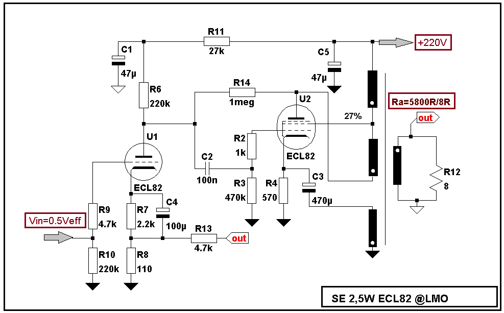

I've already asked some power supply specific question in another thread and received quite valuable information. Now I would like to share my ongoing building experience of my first tube amlifier.
Initially I wanted to build the EL34 amplifier but I quickly dropped it for a simpler and less expensive idea. With some assistance I picked the ECL82. Initially I thought I'd simply follow someone elses lead but then decided to study the ECL82 datasheet, read some schematics and articles and come up with my "own" design. As much as one could call it that, take the datasheet suggestion and make a few design choices.
I decided to operate the ECL82 with a B+ of 270V and a OT impedance of close to 8k. The equipment driving the amp will produce up to 2V rms at maximum volume, therefore I did not bypass the cathode resistor of the triode to reduce overall gain. The rectifier is a EZ81. Per datasheet the EZ80 should have worked but required higher PT secondary. PSUDII complained about exeeding the EZ80 maximum ratings. I wanted to play it safe and settled on the EZ81 instead.
I am not new to electronics. Learned the "Radio and Television Technician" trade in Germany after highschool. I worked in the electronic repair business for many years, first in Germany and later in Canada. Nearly a decade ago I switched careers and entered the IT field. Designing and building electronic circuits, be it analog, microcontroller or RF (amateur radio) has always been a passion. But until now I never got around to building with tubes. In my youth I restored a few tube radios (even repaired a few tube TVs) but otherwise only worked with solid state gear. Recent events in my life have brought back memories of the warm sound of tubes, the smell of heated dust and the glow of the tubes. So here I am building a tube amp.
The schematic of the first cut of the design is attached. I'd really appreciate some input as to what I've brewed here, good or bad.

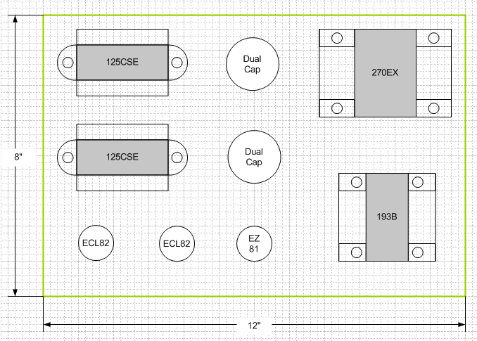

I am now laying out the chassis. I understand that to reduce magnetic coupling the OT and PT should be a 90 angle to each other. Looks like it should be possible to get everything arranged on a Hammond 12"X8"X2" or 12"X8"X3" aluminum chassis. I thought about bolting the choke to the rear wall under the PT. I think this should place the choke into the 3rd plane and reduce coupling between it and the other transformers.

Hi Adi,
regarding magnetic coupling two tips:
1) If you are not restricted to optical symmetry, move the xfrmrs to opposite sides, see my ECL82PSET
2) If you use a steel chassis, magnetic coupling is possible through stray magnetic fields induced in it. Put non-magnetic chims under the iron, so that the iron cores do not touch the chassis, 1-2 mm will do nicely. Alternatively, I use rubber grommets as "bearings" for the screws holding the xfrmrs, which also decouples mechnical hum (a chassis is a resonance corpus).

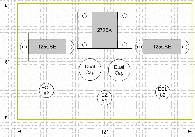

The top of the chassis will be open. It has to look nice but not at the expense of performance. Here is a drawing that places PT on one side and OT on the other. This way there is room for the choke on top. So I substituted the choke with a Hammond enclosed style. Thinking about wiring, it would be a bit awkward.
Does it matter how close the OTs are to each other? What about PT and choke, I would hope that orientation between power transformer and choke wouldn't matter that much.
As far as rectifier is concerned, the GZ34 was already recommended. The Hammond transformer even has a 5V winding I won't be using. I didn't like the idea of mixing sockets and tube styles.

Consider increasing the current through the triode. The ECL82 datasheet only suggests one or to setups. However the triode is infact very similar to the ECC82. An examination of the ECC82 will show you that you can reduce the 220K resistor to 110K and the cathode resistor to 1.1K. This will double the current through it whilst keeping the overall plate voltage. Well worth trying. I did this on my ECL82 preamp and it allowed me to increase the plate to plate feedback I was using.
Talking of plate to plate feedback, I would suggest that you at least try introducing a 160K resistor between the anode of the triode and the anode of the Pentode. This reduces output impedance and will help to linearlise a tube which is not noted for its linearity.

I think that is a very good design, especially considering it is your first tube circuit - congratulations!
The ECL82 was a good choice. You can expect a very nice sounding amp. I have built a similar amp also using the Hammond 125CSE output transformer and it performs very well indeed with great bass and all. I use the 5000 ohms tap (yellow) but you can experiment with that to suit your speakers.
I would second Shoog's recommendation on increasing the current through the triode. I actually use a load of 100K and a cathode resistance of 255 ohm which works very well, so you might like to experiment in this direction.
I would not agree on the addition of feedback though. While it does make the amp measure much more lineary, it sounds a lot better without. Feedback takes the life out of the amp - you can easily verfy this experimentally.

"You say the triode of the ECL82 compares to the ECC82, but shouldn't it be the ECC81?"
That was off the top of my head - so you could well be correct. I can't remember exactly where I got that information. However my instruction to halve the load resistor and the cathode resistor works ( I have tried it ).
"I would not agree on the addition of feedback though. While it does make the amp measure much more lineary, it sounds a lot better without. Feedback takes the life out of the amp - you can easily verfy this experimentally."
I found that if the partial feedback was overdone then indeed it did rob the end result off life, but 160K proved a good compromise - gaining the benefits of lower output impedance whilst retaining the sound quality. Its so easy to try this that I would recommend an experiement just to see if you like the end result.

The triode section has a max current of 3.5mA and an amplification of 70, with a max plate dissipation of 1 Watt.
So 170V at 0.5mA looks about right to me.
I would also suggest trying some negative feedback. The distortion may get a bit messy in a pentode circuit like this without it. Also it provides more useable power too.

The schematic makes sense to me. However, there are linearity and damping factor issues.
The linearity of pentode mode is significantly improved when the screen grid B+ value is stable. Zener regulating the screen grid voltage at approx. 150 V. is definitely something to consider.
NFB in 1 form or another is necessary (IMO) to obtain an adequate damping factor with pentodes. The 125CSE's multiplicity of taps can work to your advantage. Think about the "exolinear" topology of Doug Piccard (Bandersnatch). Instead of connecting the triode's load resistor to B+, connect it to a tap on the O/P trafo's primary. You will have to forego the B+ decoupling network, but that is usually OK in a 2 stage circuit.
I calculate that the 220K resistor would drop 110V, leaving 110V on the plate. This would give a dissapation of 110 x 0.0005 = 0.055watts. So theres a good deal of margin to push more current. If going for plate to plate feedback you need more current or the feedback will swamp the triode.
