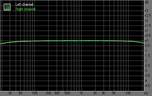

First at all, why did you knew that it was rolling off? Did you used measurement equipment to check it? Or did you use any software tester like rightmark and a soundcard?
Because I have, and mine outputs straight as a line. Please, do that before making assumptions based on subjective impressions. Post your picture from rightmark too so we can aim to diagnose your problem.
Going from metal films to carbon composition is not going to make any objective difference.
Can you post rightmark measurements of your build? I wanna see how they compare to dedicated FFT software. What soundcard?
So now its subjectively flat? Because to such a degree of treble loss you describe it should have been a very serious problem. Most likely oscillation. Do you have long interconnects on input/output? What type of wire construction, shielding?
Yes, it is now subjectively flat. Sounds about the same in response as the NAD C160 preamp that it replaced. The interconnects I am using are 1 meter Belkin. The test build is fairly amateur. I've used what I had to make it work before I rebuild it into something nice. I did have some small signal shielded coax for the input and output. I also used some solid core copper telephone wire to finish connecting the jacks and volume control to the coax. It isn't pretty but I just wanted to test the circuit before I ordered any more parts.

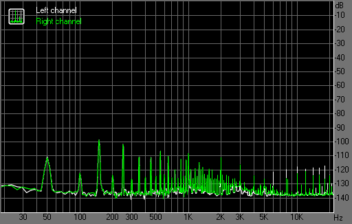

Sure I have made my measurements. Give it an eye and you will see some odd differences.

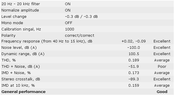

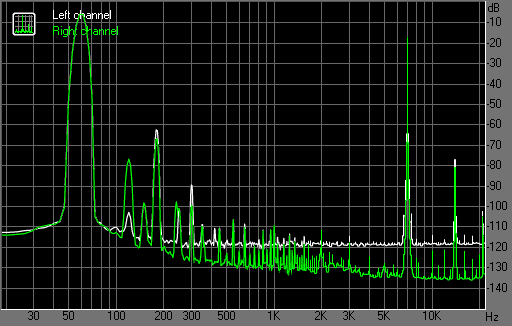

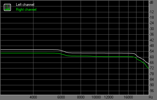

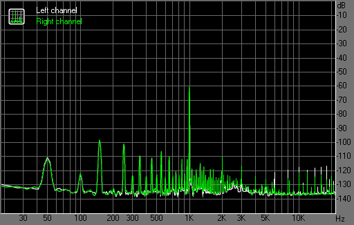

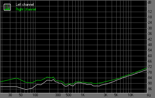

My soundcard is an EMU0404 USB wich has been changed the dc blocking capacitors for some pannasonic FM's. I made a loop with two homemade TR->RCA cables from its output to its input. Then I placed my DCB1 with its LDR volume control inside the loop.
I will upload here my measurements WITH the buffer. In my next post are my measurements without the buffer,
enjoy them
enjoy them
The software is Rightmark Audio Analyzer. And it is a very easy and effective software to use, I encourage to try it. You have to connect the output of a soundcar to the input o fthe same or another sound card in the same computer. Run the software, is free, and put between input and output as many audio gear as you want to measure in chain.
Be careful with doing things like hooking up a power amplifier. IT WILL MAKE FIRE.
Preamps, buffers, and in general all line level devices use to be safe.

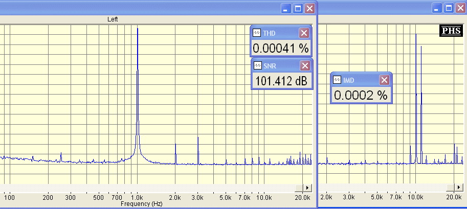

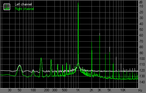

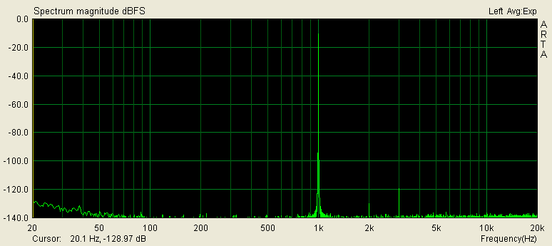

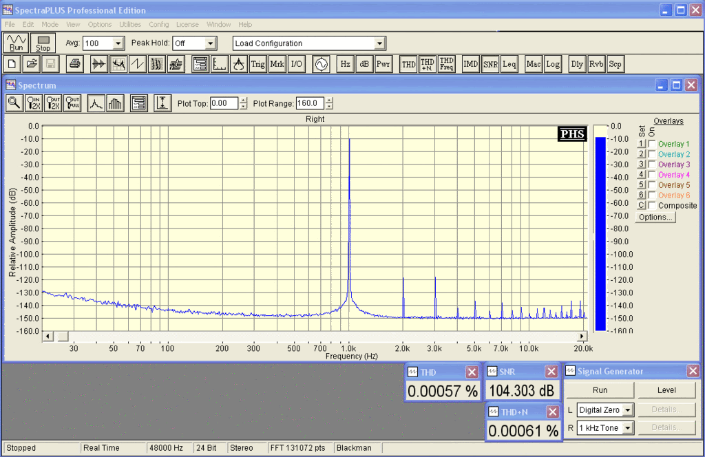

I see much harmonic noise. Does it still have it when you loop the card alone? You may need to ground lift. Mine FFTs you have seen recently. This pdf one is Grufti's. He had posted long before. My system shows the floor down to -140dB to the right with the DCB1 in, so the needle on Grufti's shows also its root along with some interference in the EMU to the far right which is in its loop with those software settings.

Why you wonder? Its there in the Emu Tracker's solo loop. In Grufti's it ain't. But it can reveal 10dB less so it hides some loop gremlins. Its mainly the settings to get the floor so low and the artifacts created.
The simple thing to see is that the DCB1 just lifts the noise floor a bit and improves the distortion. -130dB to -140dB (ref 0dB=1V), give or take, given the card and software beyond 1kHz is seriously silent. Must be one of the cleanest things line.

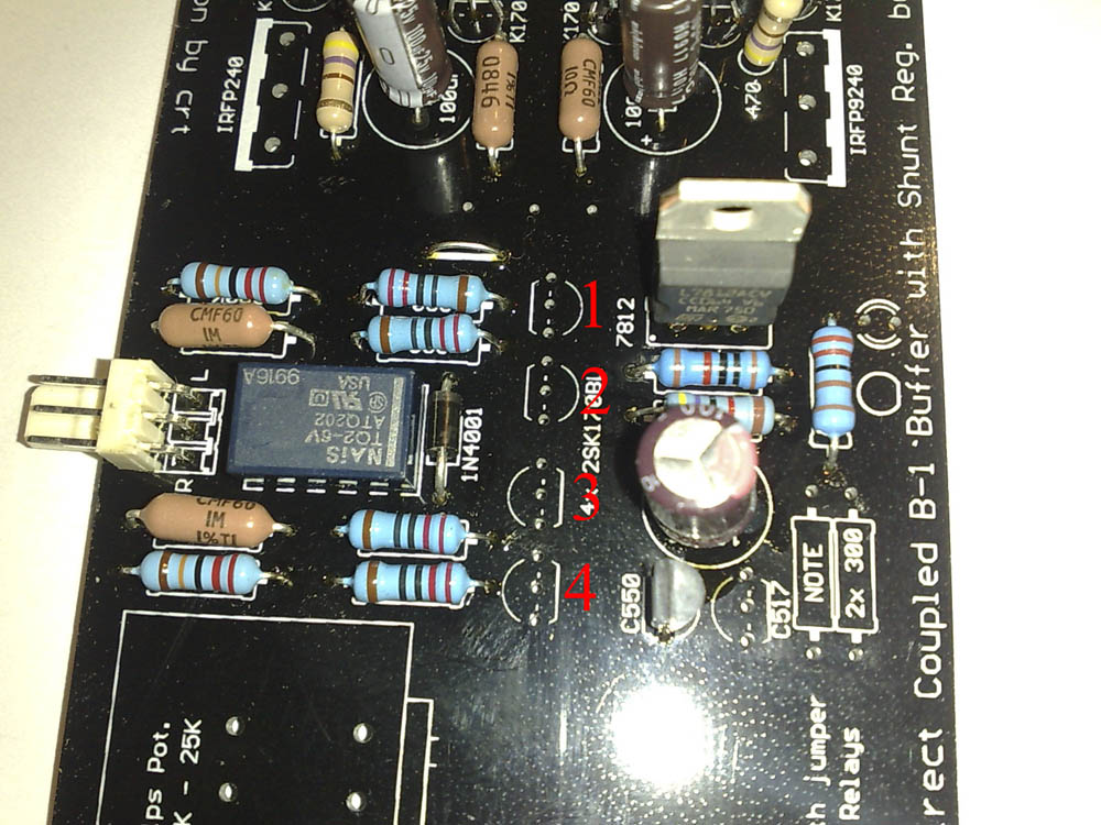

I've pointed the pins for measuring voltage on the pic.
What value should I find there ?
I found -9.48 and +10.14v at the pins.
-26 and +25.6 at the 2x68R.
Correct ?
Is your transformer more that 15+15 AC when measured feeding the project? Your Vout(s) are OK. If your filter capacitors are 35VDC and there is sinking to the Mosfets, then the 15VDC Vin-Vout isn't a problem. Its expected to be about 10-11V most difference so not to create surplus heat. If you can tackle that, it will be safe. Are you taking those measurements on a fully stuffed board?
