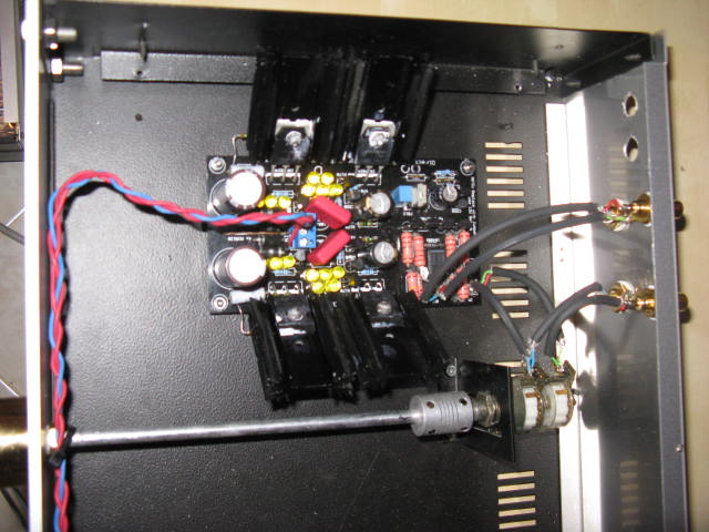

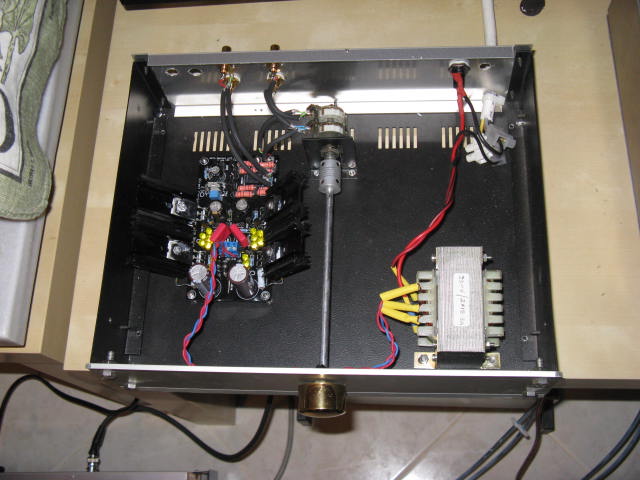

Just completed my second DCB1 with a Wima MKS 1 mF cap.
Transformer this time is an EI core, diodes Schottky, resistors Takkman carbon film, and a DACT 10K attenuator. Also R1 is with one 27 and one 10 ohm resistors.
I can say that this is a big improvement compared to my previous built with normal diodes, LDRs, Takkman carbon film, and a toroid transformer.
Main differences seems to be more extended at the frequency extremes and music seems to be with more body.
Thanks everybody again.

I bet they are hot, being smaller than mines and setting more or less the same CCS. Mines are biggers and run quite hot, but you can hold your finger on them without long term burnings :p
So WTF!! They are power mosfets, they are made for heavy duty use :redhot: :hot:
BTW, after some weeks of daily usage, all I can say is that the DCB1 is the best preamp I have had in my system. Clear sound, no noise at all and an amazing definition :)
Nice. Are those sinks OK, or too hot? Could go on the box floor too. Especially if reinforced with an aluminum plate. But if its reliable as it is, forget it.
Voltage drop on R1 is 1.9v, so current must be around 260ma. Heat on the fets is 53 celcious max, after been on for 2 days continuously, so I do not worry much. I have my phono shunts run a lot hotter for a bout a year with no problem!
