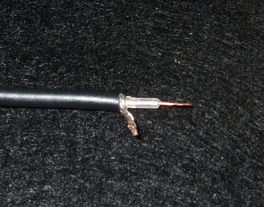

Lookie! Was remembering wrong. The central conductors are just copper on mine. Stripped one to photo. Its Italian made only thing I know. Got 10 metres from a typical electronics shop once, don't remember for how much, maybe for less than a tenner.
