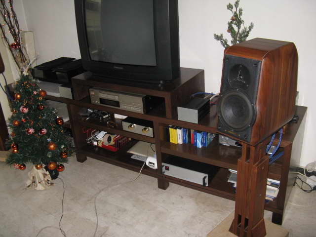

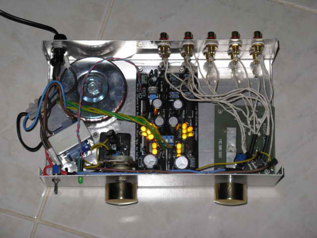

The last few days I did some critical listening to my symetric B1 with LDR's.
I have setup my build, so it has two outputs, one through B1 and one only with LDR's . Power amps were PD gainclones biamping my Sonus Faber Electa Amator 2 speakers. Input impendance around 11k.
Overall, I preferred the sound with the B1. Bass was better and music had more drive. But upper in the spectrum, especially with female voices there was some sibilance which was not there when I had the LDR alone. Resistors used are carbon generic, really nothing special. I already ordered some Takmans to replace them. Wait and see what happens!

Nice build Vgeorge.
RE the sibilance - just don nothing for a week at least. As Uriah has mentioned previously, there definitely is a burn in period with this preamp and given a week or so, it may go away naturally.
Fran
I will leave the pre playing for some more time and report if I hear any changes.
Anyway, I ordered some resistors already.
