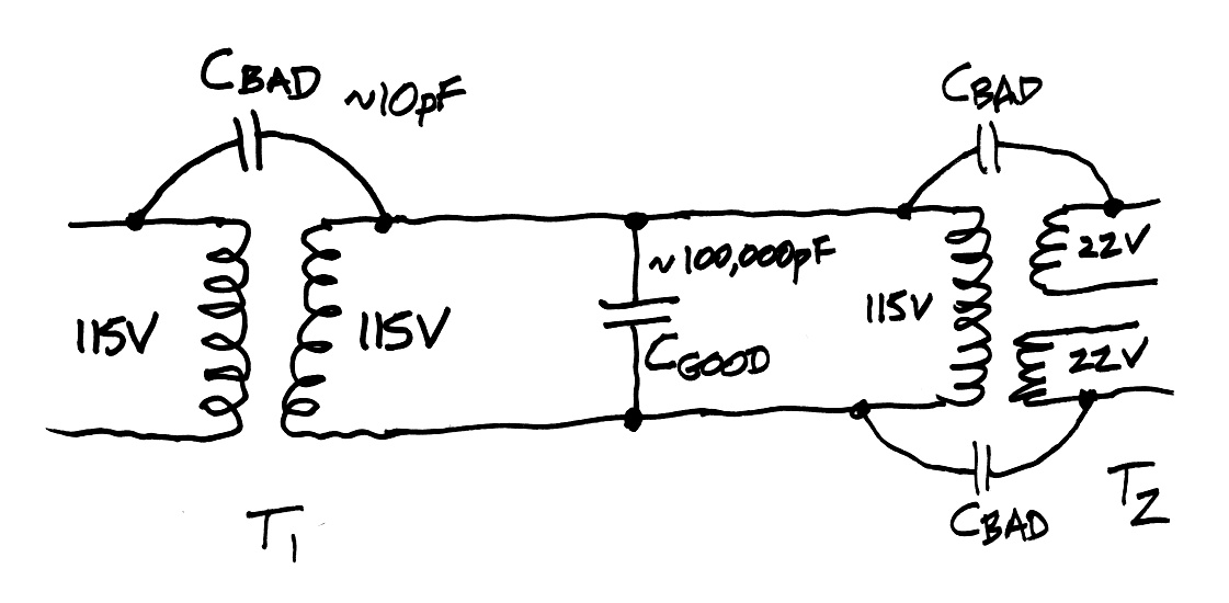

Here is an extremely easy way to vastly decrease the capacitive coupling between the AC mains (primary side) and the dual secondary outputs. It adds only two electronic components and requires no modifications to the printed circuit boards. Schematic below.
"T2" is the existing power transformer, with 115V primary and dual 22V secondaries. To that, we add new components "T1" and "Cgood". T1 is a 1-to-1 transformer, with 115V input and 115V output. Cgood is an 0.1uF (100 nanofarads ; 100,000 picofarads) capacitor.
As Gary Galo says, there exists capacitive coupling between primary and secondary of every transformer. I have drawn it as "Cbad" in the schematic. Its magnitude is somewhere between 1pF and 100pF depending on the physical geometry and construction details of the transformer.
Cbad forms the upper leg of a (capacitive) voltage divider; the lower leg is Cgood. Since the impedance of Cgood is a factor of ten thousand lower than the impedance of Cbad, mains borne noise and RF interference is attenuated by a factor of ten thousand times. This is a far greater improvement than you can ever get by merely switching from a single toroidal transformer to a single split-bobbin transformer.
And it's simple.
And if you are truly insane, you can cascade N of these 1-to-1 transformers in series, and get attenuation of (10,000 raised to the power N) times.

I have an isolation transformer that could be T1, and my T2 has dual primaries. So just a cap across the output of the isolation transformer which connects to the existing transformer primaries?
That's interesting.
There's a difference between modifying an existing PSU and starting one anew.
For an upgrade, the added two components approach is attractive.
For new construction using a split bobbin plus the 1:1 transformer and cap can be included (and the PCB designed to accommodate 'em). Or you can get a measure of benefit from just choosing the split bobbin device. Belts, suspenders, or both.
Ultimately, it's a question of the degree of benefit. Is this (either) worth doing in any event? Why don't we see either of these "solutions" included in more designs?
And is including the chokes beneficial? (I was looking at the whole raw supply and the entire rational for it.)
Similarly, Wayne's inclusion of the bridge for grounding seems a good idea. Should it be included in all our projects' supplies too?
