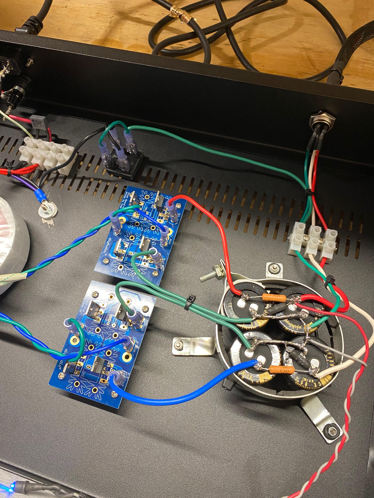

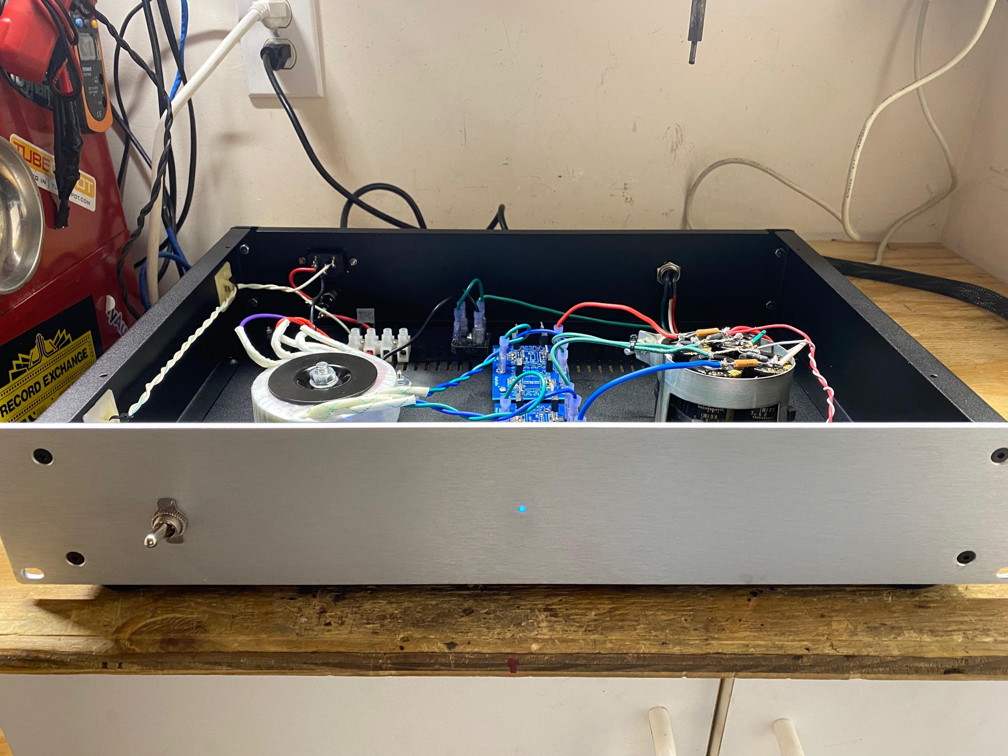

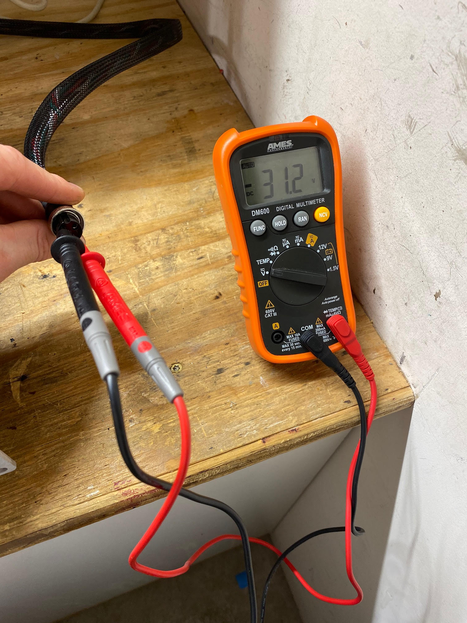

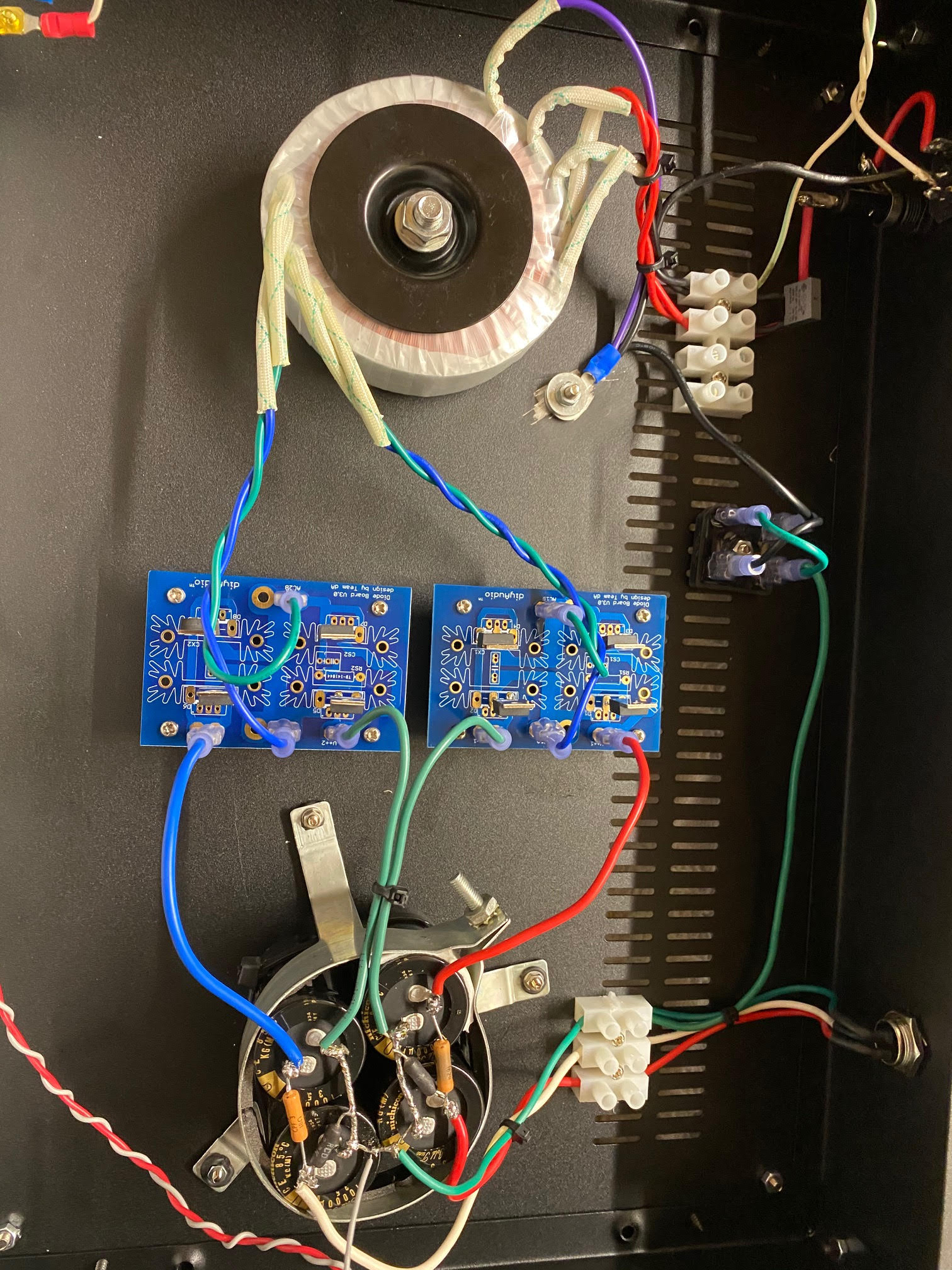

With the help of 6l6, his build guide, and the schematic, I was able to find some spare parts and put together this Power supply for my Pearl 2. I just used some spare diode boards from thePower Supply boards and wired some Nichicon Gold caps together. I am getting 31V and -31V... The cord I made with some spare braid sleeve I had, some heat shrink, and some connectors I found on Amazon. I am proud to say this was the first time I really spent a lot of time reading a schematic and trying to understand exactly what components needed to be where and why.
I've built a BBa3FE, F5, F6, F4, M2x, and the amp camp. I think this one is going to be the most rewarding!
Let me know if anything looks incorrect. I am working on the Pearl boards and other chassis right now!

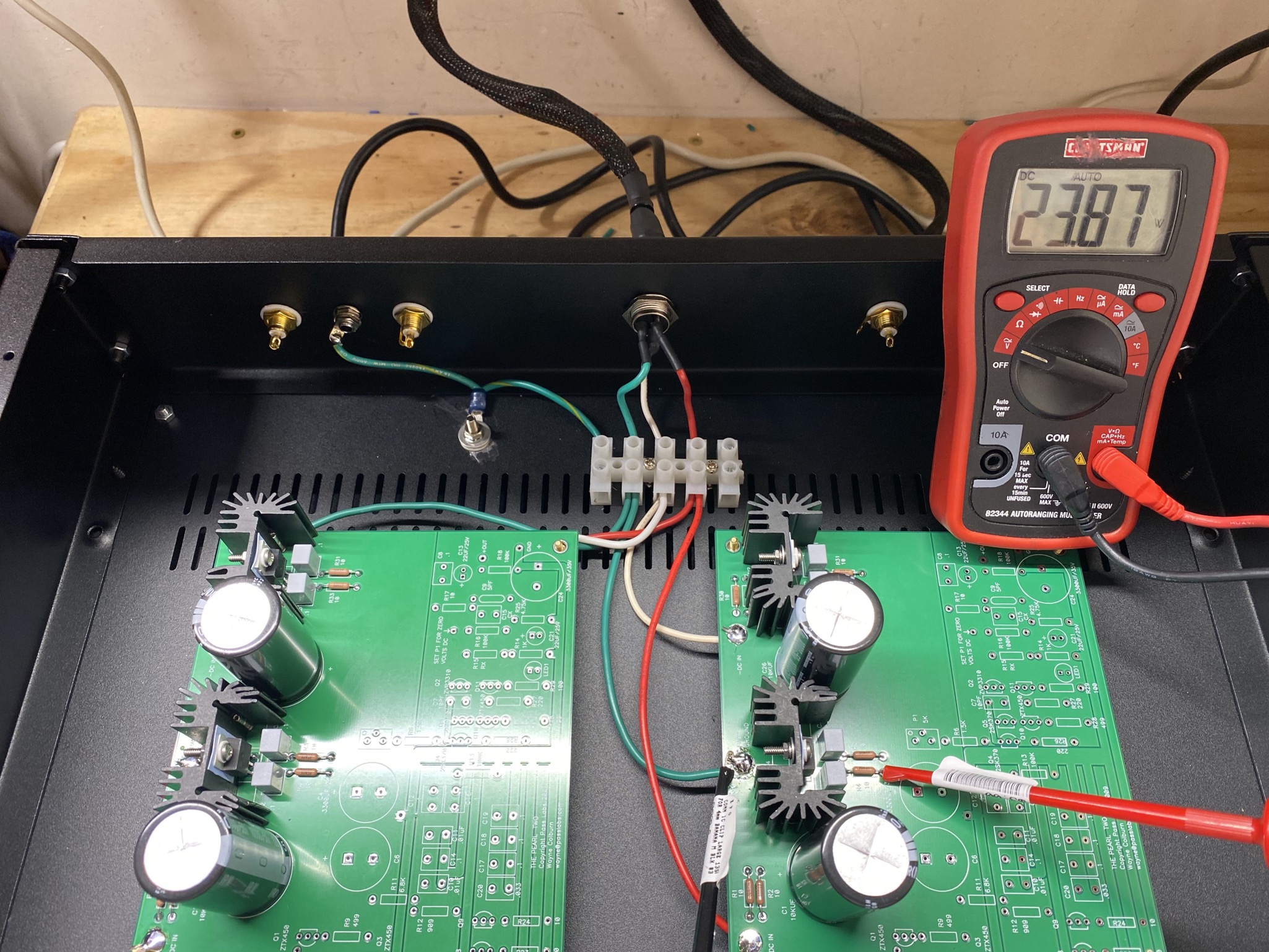

Thank you! I just finished pre drilling all holes for the Pearl Board chassis and tested the regulators. I get right around +-24V on each resistor check point!

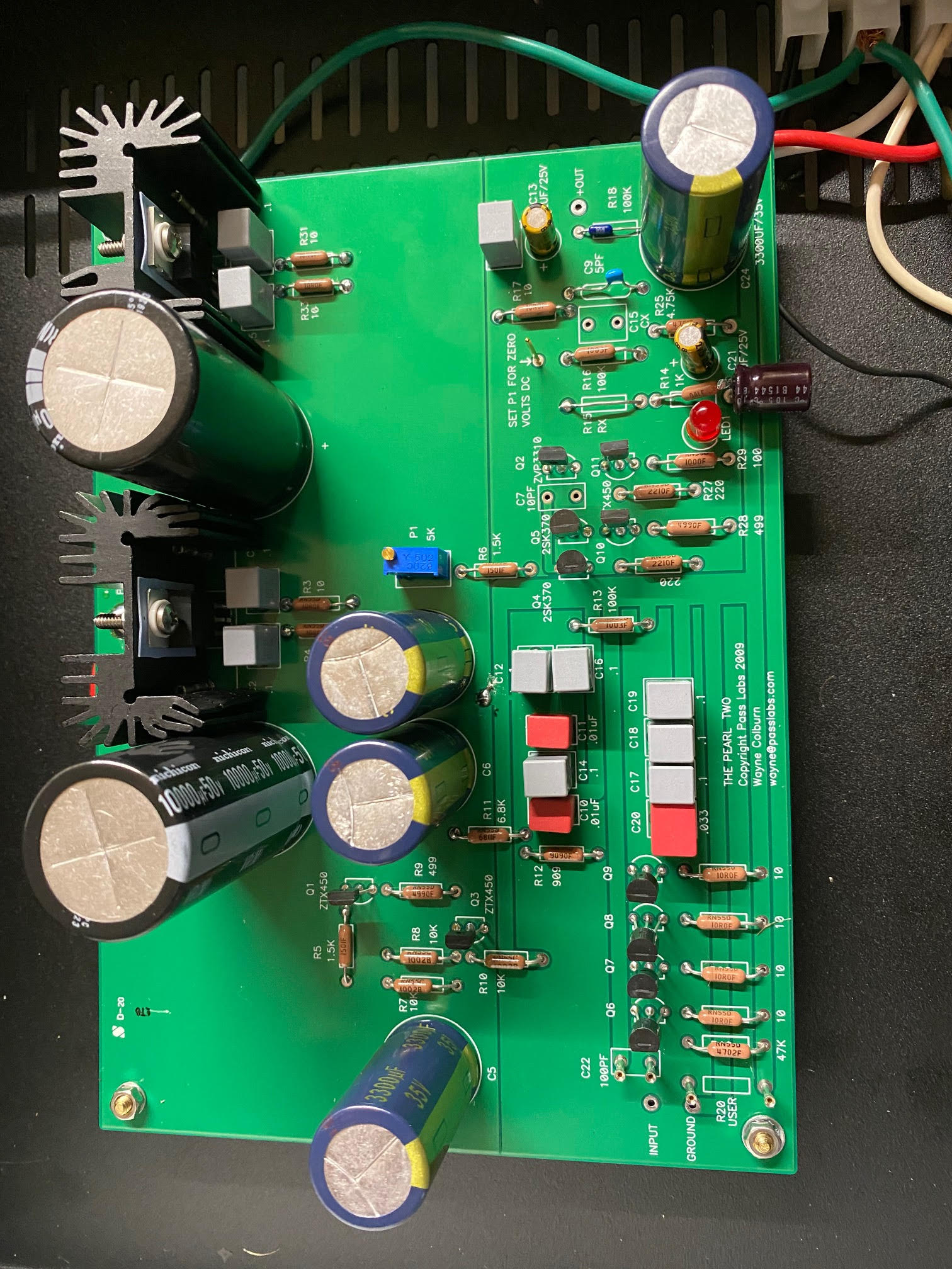

Time for bed then I’ll finish stuffing the phono tomorrow after work. I just have to stuff the boards, wire the rcas, add the grounds to the centers of the PCBs, then bias..

Can I follow the post notes on #1287?
C15 - Leave out ( I put a jumper in by mistake)
R15 - Jumper
C22 - Leave Out, no jumper
R20 - Leave out, no jumper
C7 - Can cause issues. Wayne after the Pearl 2 article was published recommends leaving out.

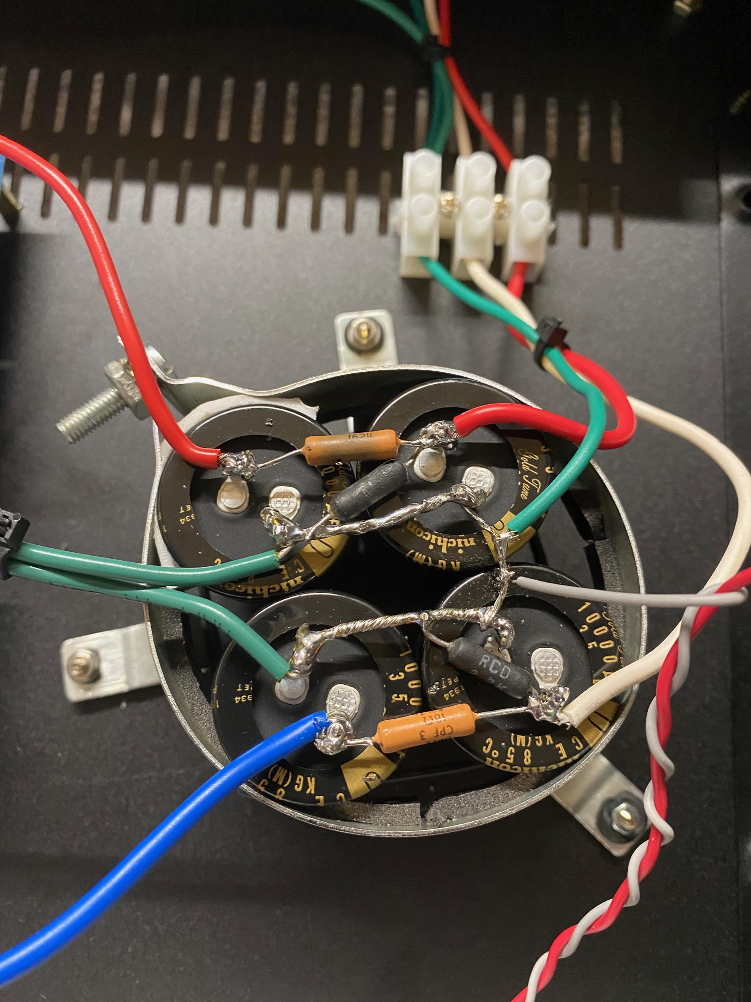

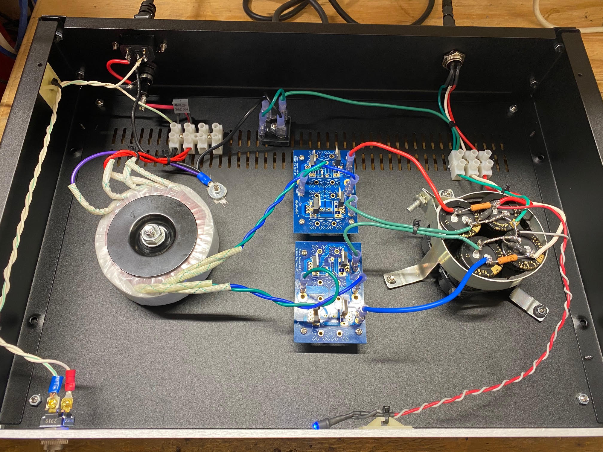

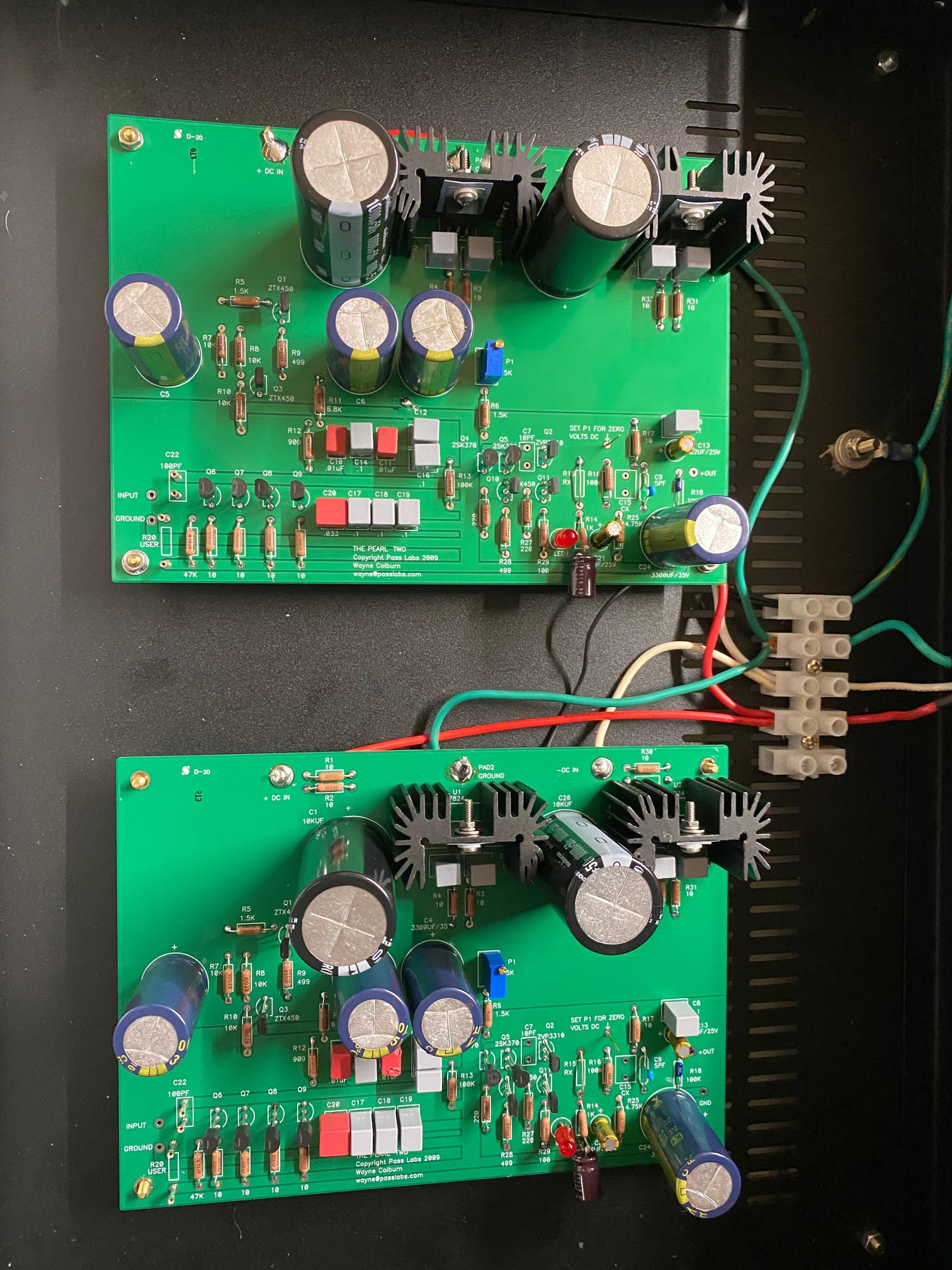

Bad news on the Pearl. I finished stuffing the boards today, plugged it into my DBT, and flipped it on. The red leds came on on the phono boards, but as I started to get my DMM for testing I noticed smoke.
After investigation I noticed it to be coming out of the dropping resistors (attached to my 4 PSU caps) in the power supply and NOT the phono boards.
I tested each board individually, checked my solder connections, and re-checked my wiring but each time I test I get the the same issue with DBT light on and dropping resistors on my PSU heating up quickly.
I also tried disconnecting and testing my power supply again and its fine. I did confirm the regulators were good before stuffing everything else.
I am using a 60W bulb and do not have anything bigger for my DBT.

Without Pearl Connected I am getting +-31V. I tested the pearl board regulators BEFORE installing the rest of the parts and was getting +-24V on the 10 ohm resistor test points.
You can see in the picture of my PSU caps the orange dropping resistor that is slightly burned.
