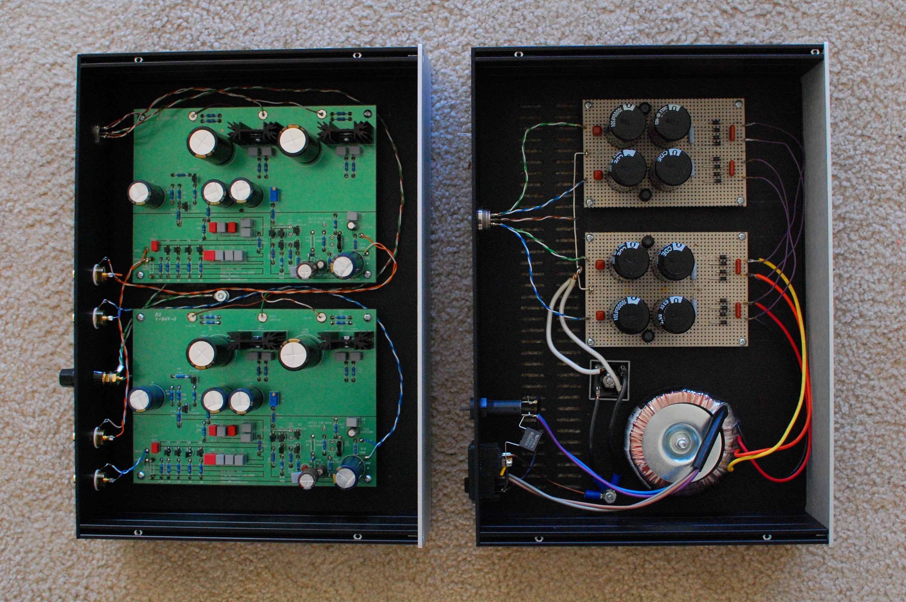

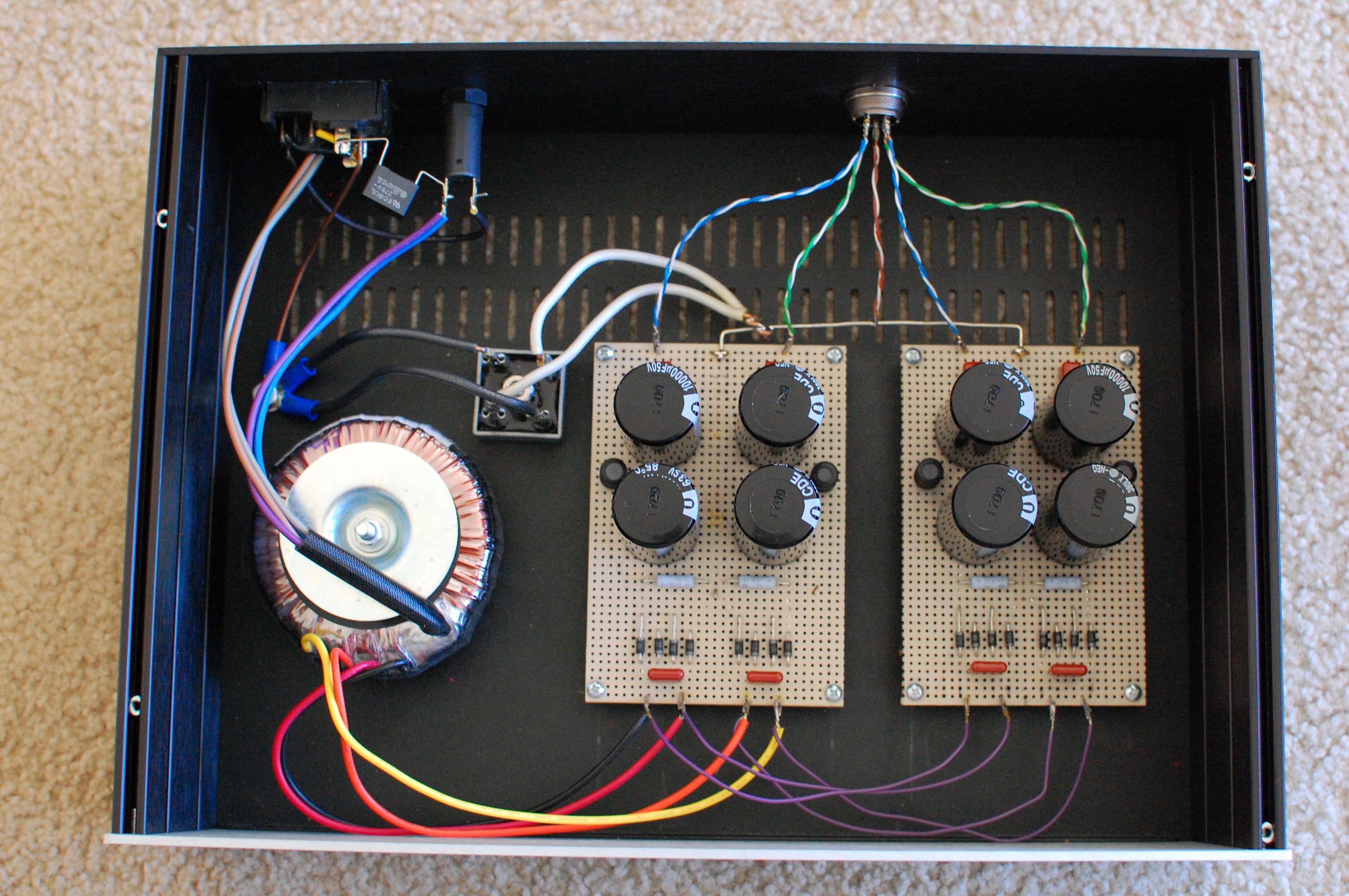

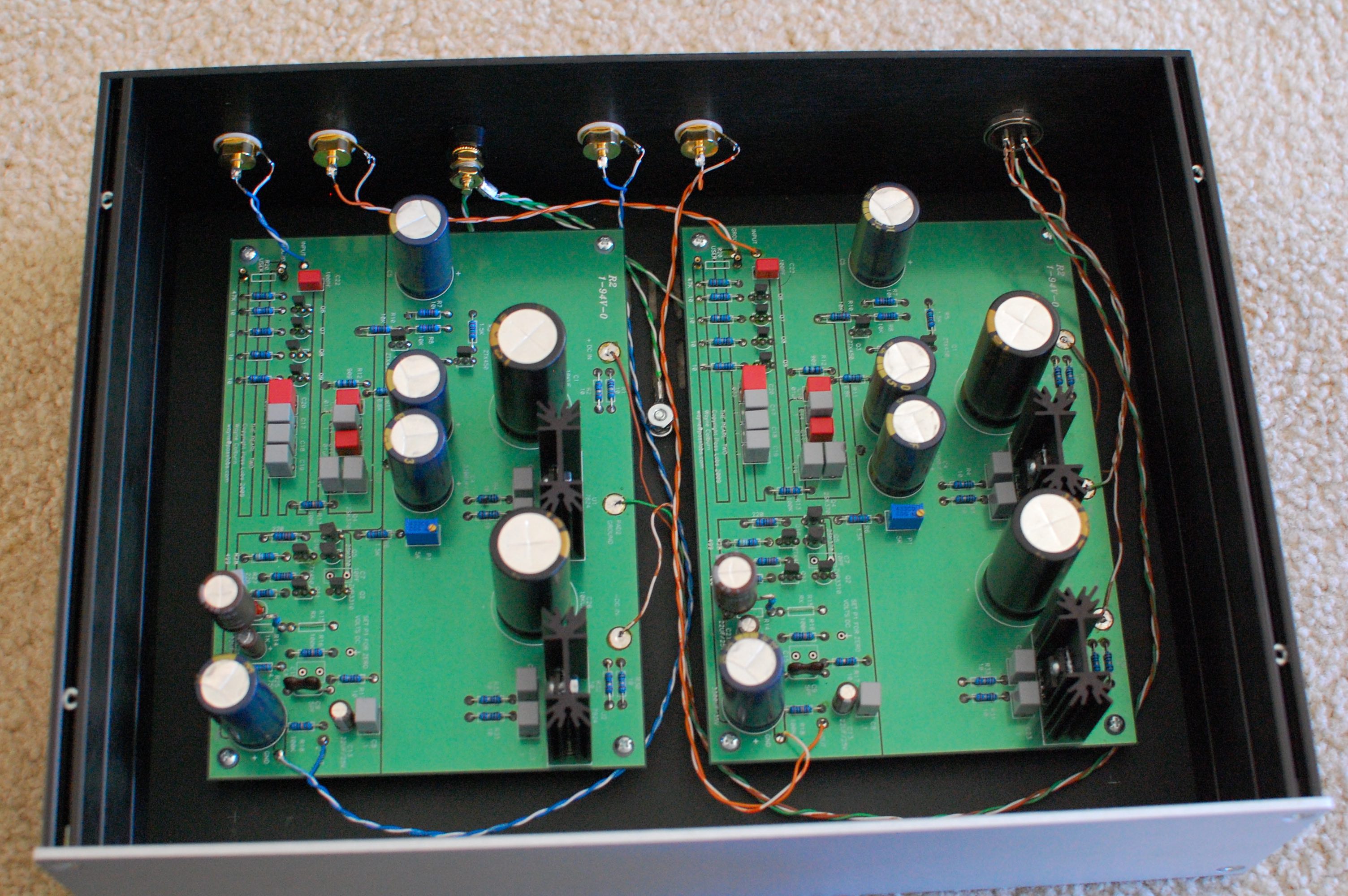

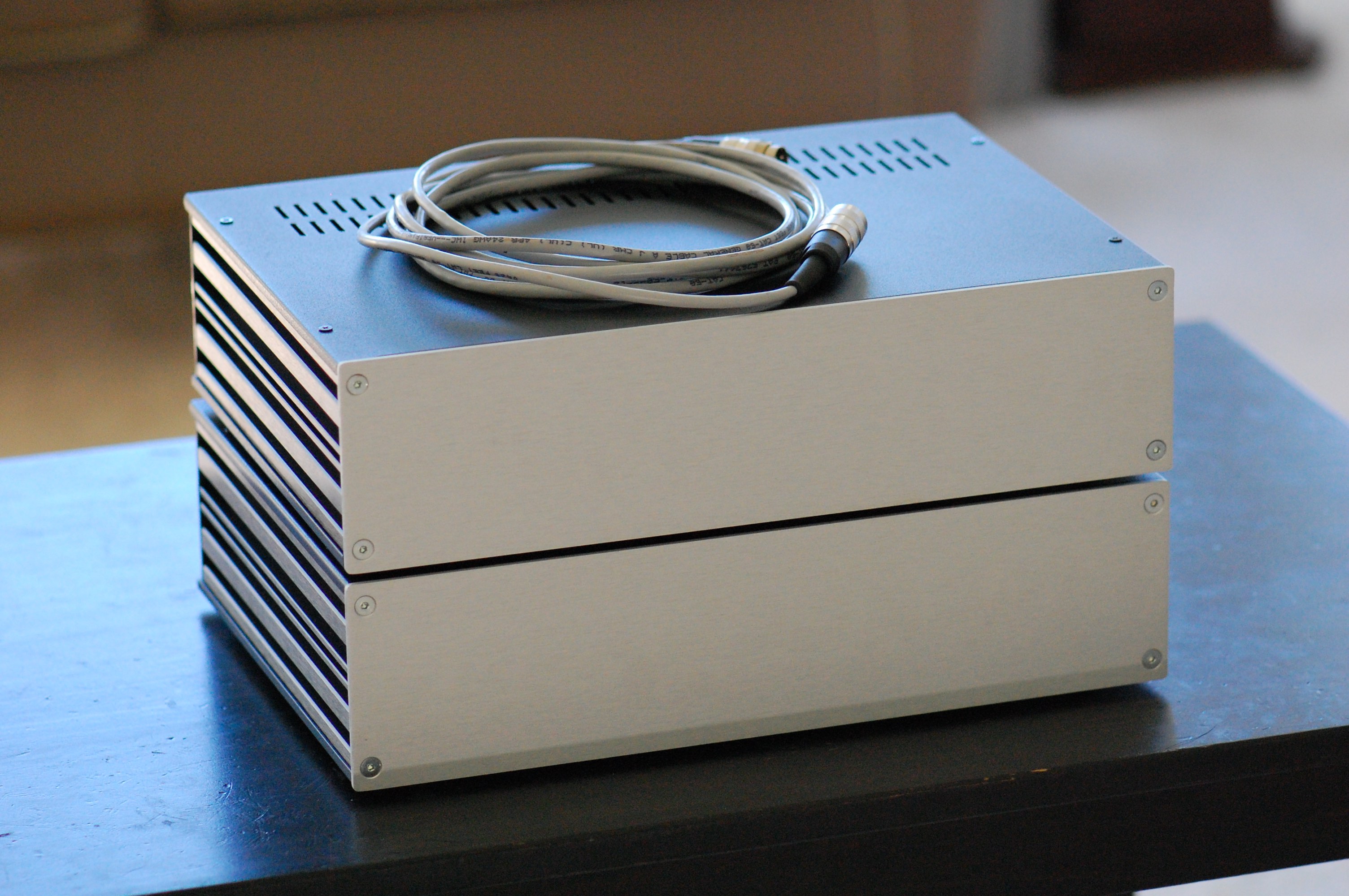

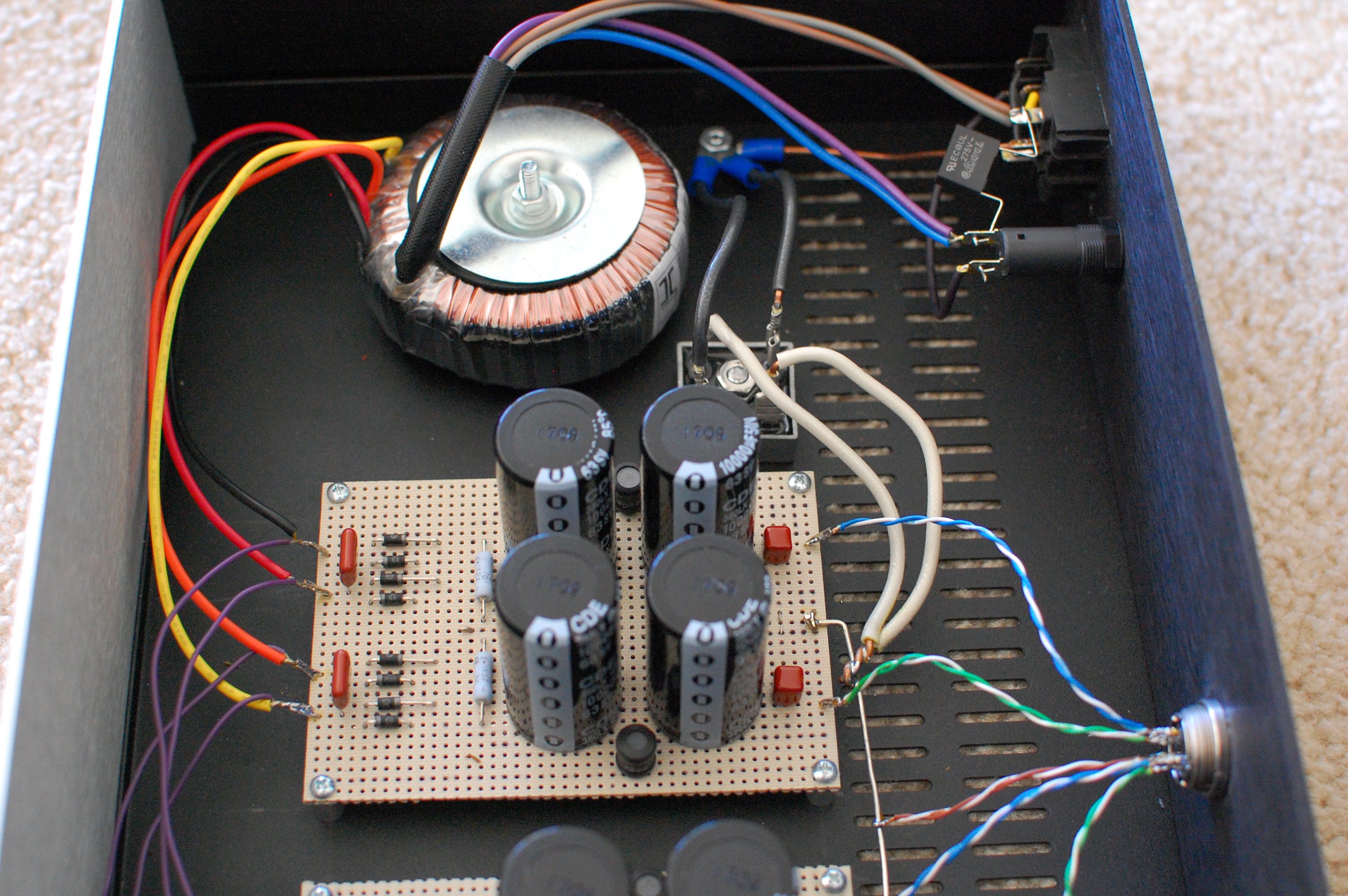

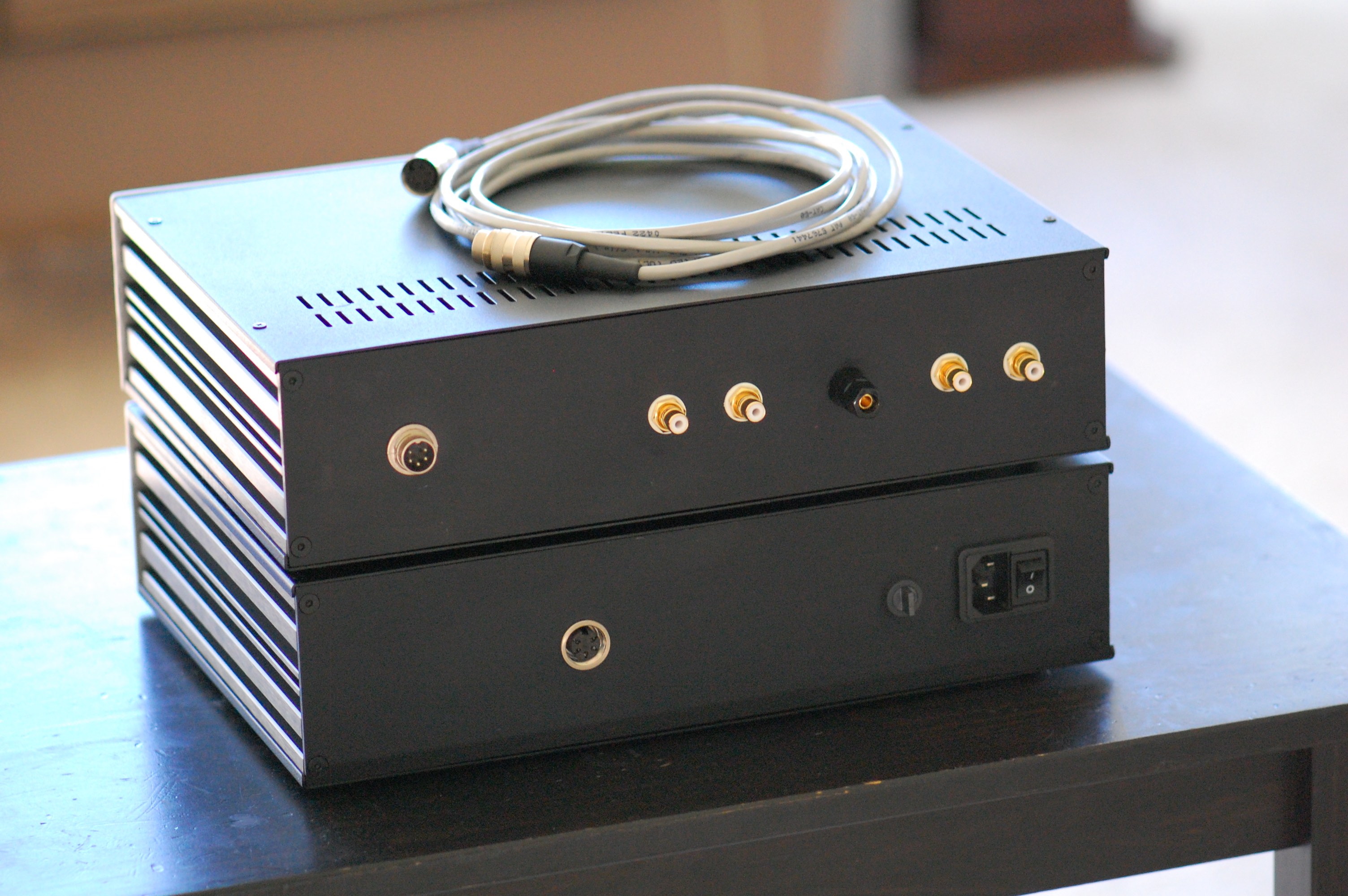

Finally had a chance to test out my Pearl 2 Build ... Lady Luck was with me and she played perfectly straight out of the gate . Many of you will laugh at me, but I guess I need to go buy a good turntable now (borrowed a friends for testing purposes ).
I built the gain boards stock except for adding a 220uF series capacitor to R14 to stabilize DC offset. The offset slowly and slightly wanders, but stays less than +/-1mV.
For the power supply I went dual mono after the transformer (24V secondaries), which was a minor mistake because I had originally designed around one supply for both channels, and after splitting it the voltage rails crept up to 35V leaving no safety margin for the caps on the gain boards in front of the regulators. Used CLC with 10,000uF caps and 6.8mH inductors that also had 14.7 ohm DCR (measured). I'm really happy with how the PS turned out, as it has ~0.2mV ripple, and will really keep RF down as well.
I was really concerned about hum from grounding and from the PS radiated noise, so I made my power umbilical 10ft long just to be safe. I definitely have avoided hum, its dead quiet except for a slight Mosfet hiss if I crank the volume up and put my ear right next to the speaker. For giggles I stacked the two chassis just to see what happens, and it stayed just as silent. Thank you to 6L6 and everyone else on their grounding layout advice.
The sound was excellent straight out of the gate with an entry level ProJect turntable and an Ortofon OM-5 cartridge. I'm curious to see what some burn in time will produce, and how it sounds with the Dual 505-3 that I inherited from my Dad but now need to pick up from my dear ol' Mum. My suspicion is that I will find myself bit by the upgrade bug wrt to the turntable.

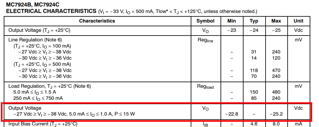

One thing about this build that is bothering me is while the 7824 regulator is putting out 23.98v, the 7924 is putting out 23.67. I verified that exactly +28 and -28v are going in from the PS.
Check your PCB to find out which semiconductor company made the 7924 regulator IC on your board. Then pull up the manufacturer's datasheet. I've attached a piece of the datasheet from ON Semiconductor below; yours may be formatted slightly differently.
The red box shows a guarantee that ON Semiconductor makes to its customers. Every single MC7924, no matter what temperature, no matter what output current, is guaranteed to deliver a regulated output voltage between -22.8 volts and -25.2 volts. It could be anywhere in that range. Some units that roll off the manufacturing line will be towards the lower end of the range, and other units will be towards the upper end of the range. (They follow a bell shaped curve, the so called Gaussian Distribution).
Wayne Colburn knew this when he designed the Pearl-2. It won't surprise him at all to hear that your 7924 voltage regulator's output is -23.67 volts ; after all, -23.67 is between -22.8 and -25.2. ON Semi met its guarantee. Don't worry, be happy.
Oh by the way, the guaranteed limits (-22.8V and -25.2V) happen to be 5% below, and 5% above, the -24V target. Is this a numerical accident? Oh no.

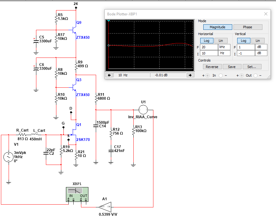

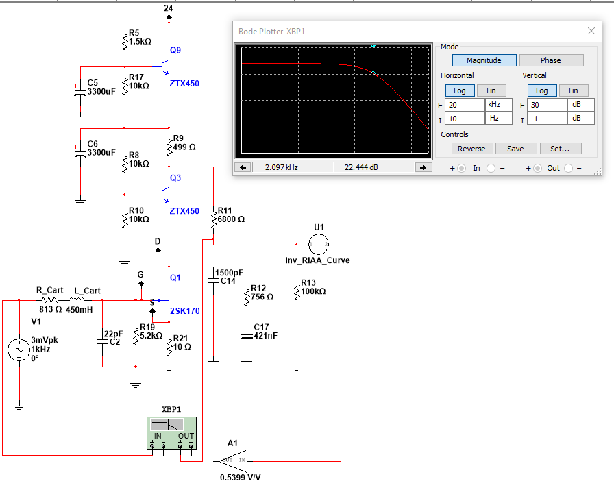

I’ve read the two Pearl 2 threads a couple of times over, and I’m still trying to wrap my head around this issue of high frequency signals from higher output MM cartridges causing overloading of the Pearl 2 second gain stage. I ran the math and it isn’t adding up, or I’m doing the math wrong. So I’m throwing this out here for discussion and to be back-checked.
Jackinnj posted that the issue is at high frequencies a MM cartridge can output a signal up to 70mV (if I’m mis-quoting, please correct me). So I choose a 70mV signal at 10kHz to run my calcs.
The 1st gain stage is +35dB or 56.2X, making the output of the 1st stage 3.94V.
At the RIAA filter network:
C10,C11 and C14 make a composite capacitor of 0.12uF, which at 10kHz has Z=133R.
C17,C18,C19 and C20 make a composite capacitor of 0.333uF, which at 10kHz has Z=47.8R
C12 and C16 make a composite capacitor of 0.2uF, which at 10kHz has Z=79.8R
Then we also have R11=6.81k, R12=909R, and R13=100k.
I’m going to call the node connecting R11 and R12 “A” and the node connecting R13 to C12 and C16 “B”.
Between Node A and ground at 10kHz we have an impedance of:
(1/133 + 1/(909+47.8) + 1/(79.8+100k))^-1 = 116.6R
So that at Node A that signal is:
3.94V x (116.6/(116.6+6.81k)) = 0.066V
This is then divided again (negligibly) by C12, C16 and R13 to produce a signal at Node B of:
0.066V x (100k/(79.8+100k)) = 0.066V (still).
This signal at Node B then drives the 2nd gain stage which has a 40dB Gain or 100X. So the output of the 2nd Gain stage is 6.6V. Let’s assume, to be conservative, that it is an RMS level, so we then have a max signal level of 9.37V(peak).
Since the rails are ~+/-24V, and the output mosfet is conservatively dropping 4V from the rails, the output stage can handle swings of +/-20V, leaving us with some headroom available before clipping.
So, in summary, I’m confused! There has been some knowledgeable people here discussing this issue, who I’m very inclined to trust, but my calculations say we shouldn’t have an significant issue. So what am I missing?
