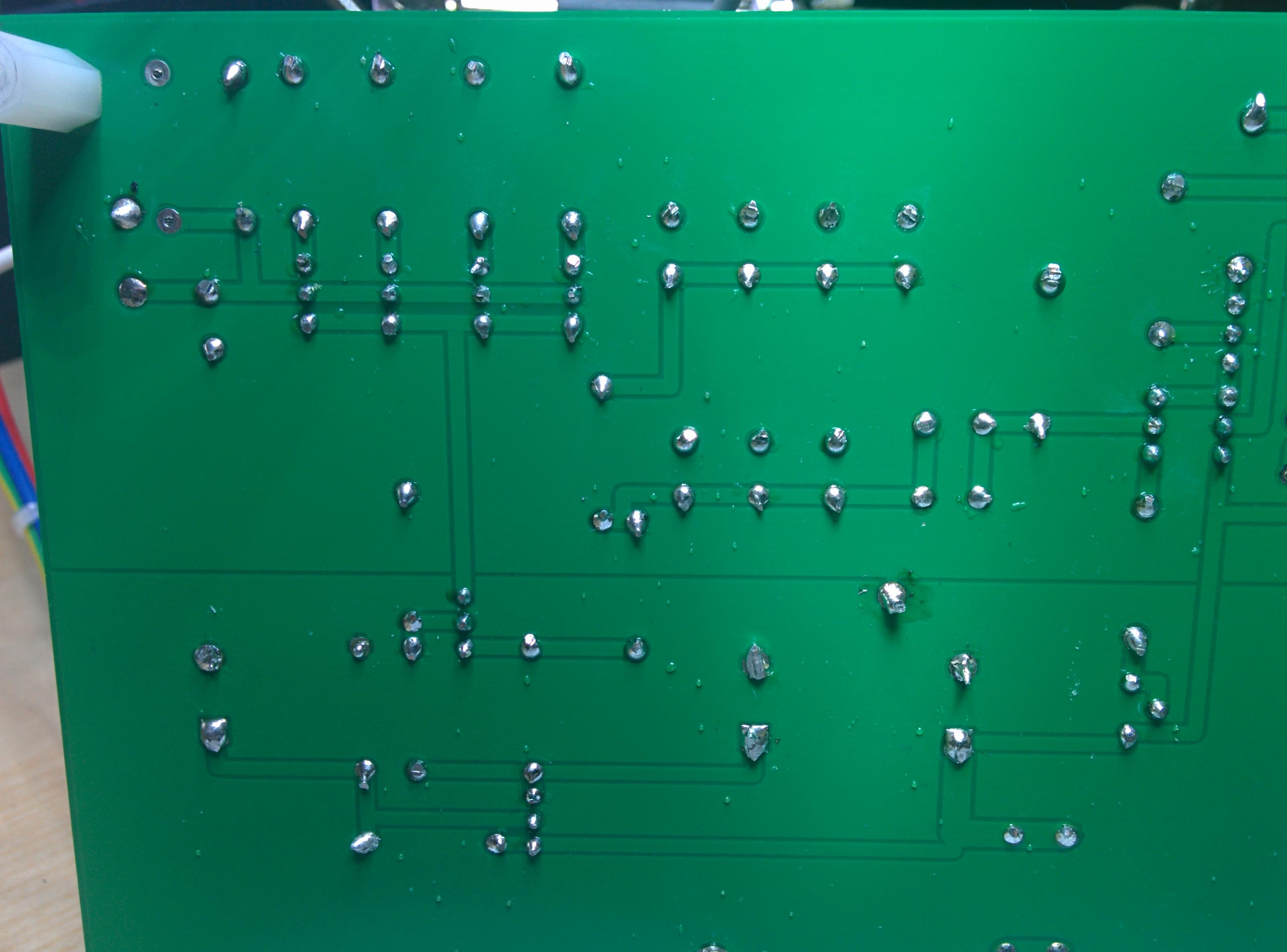

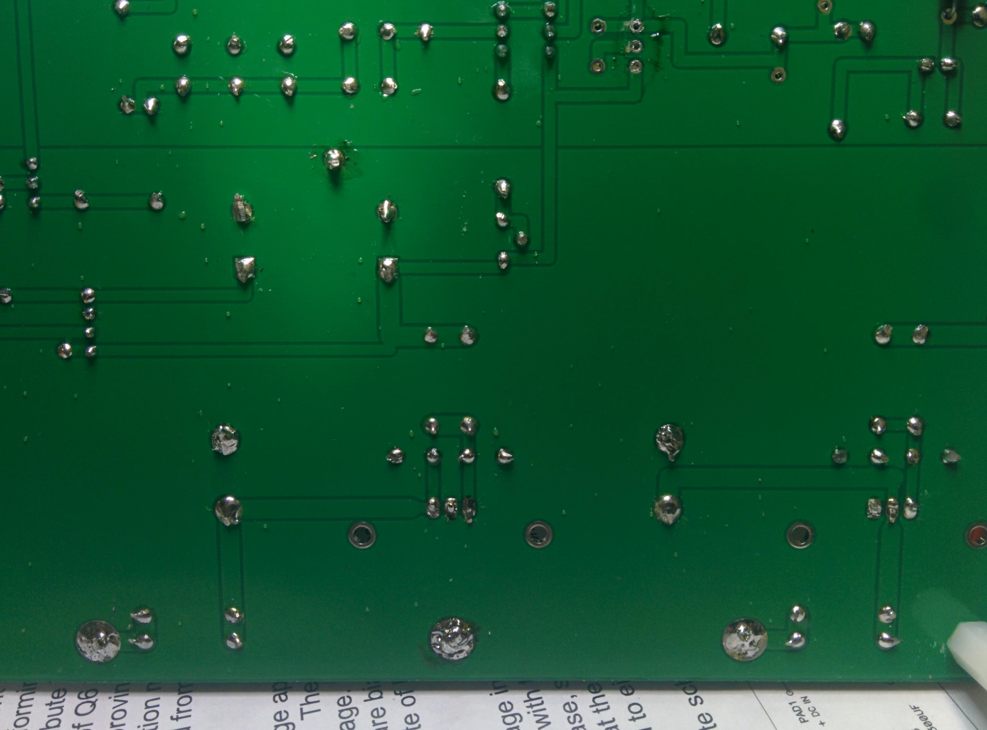

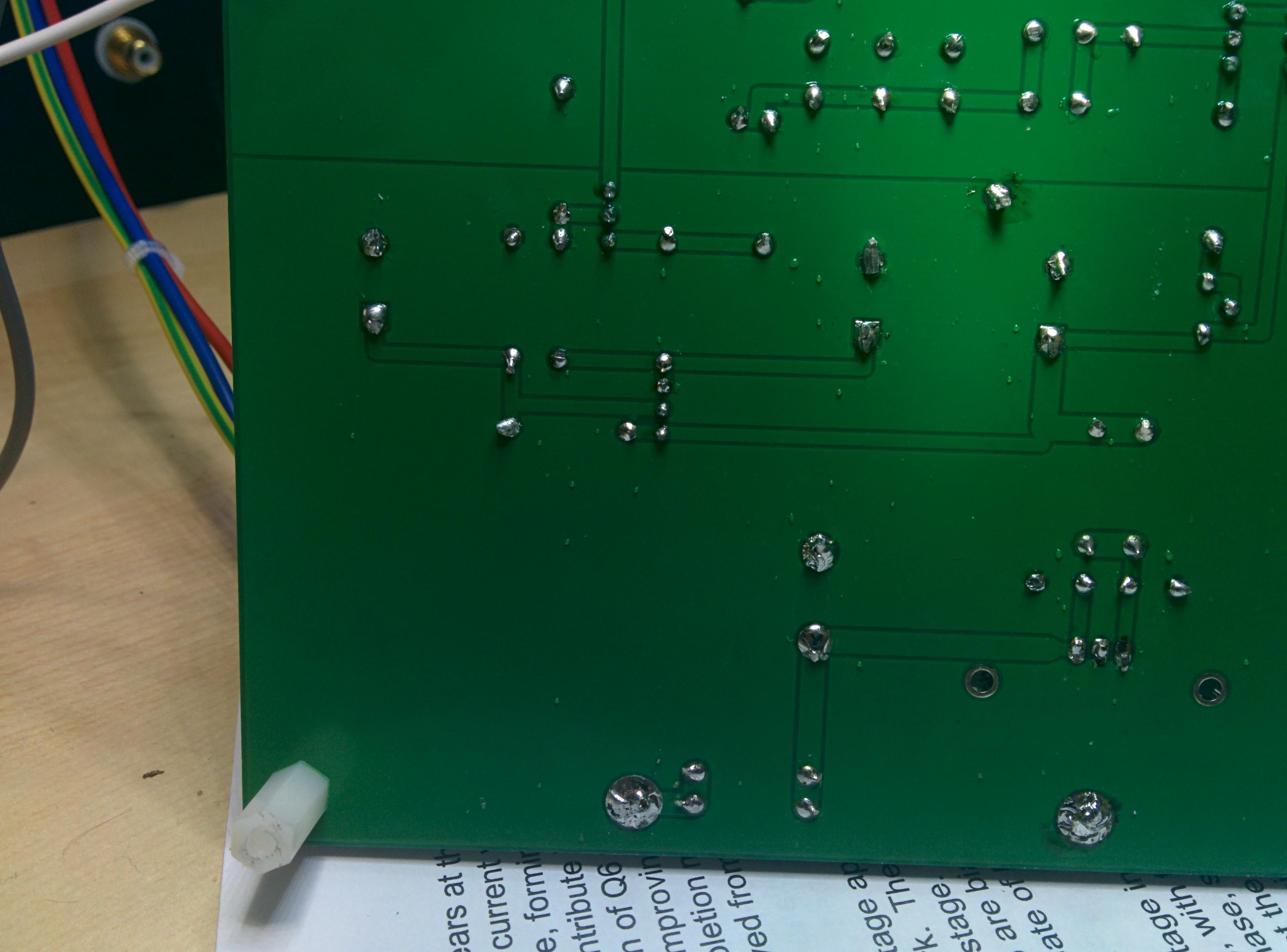

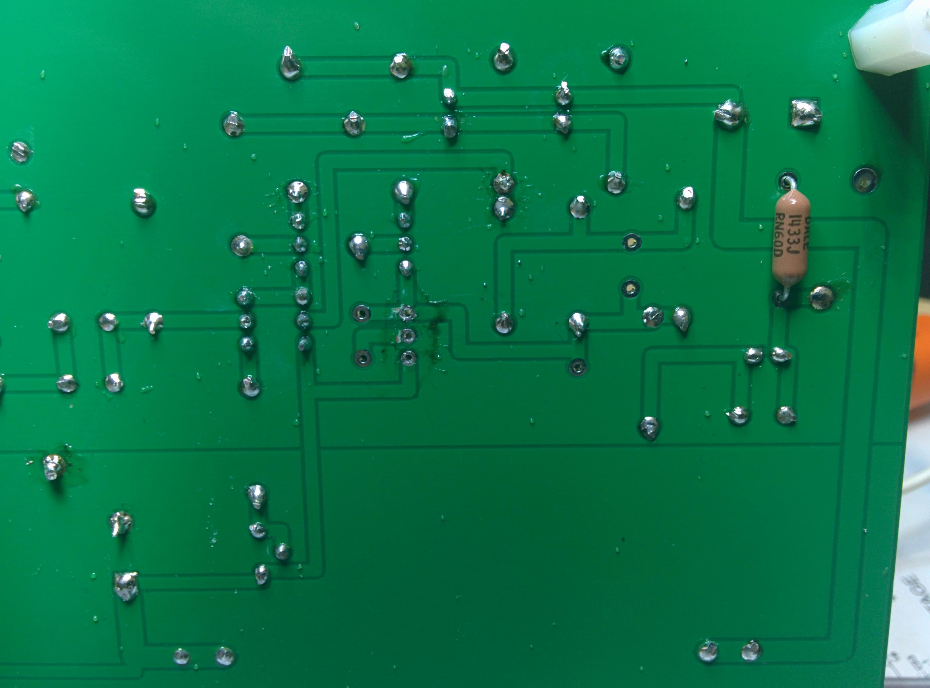

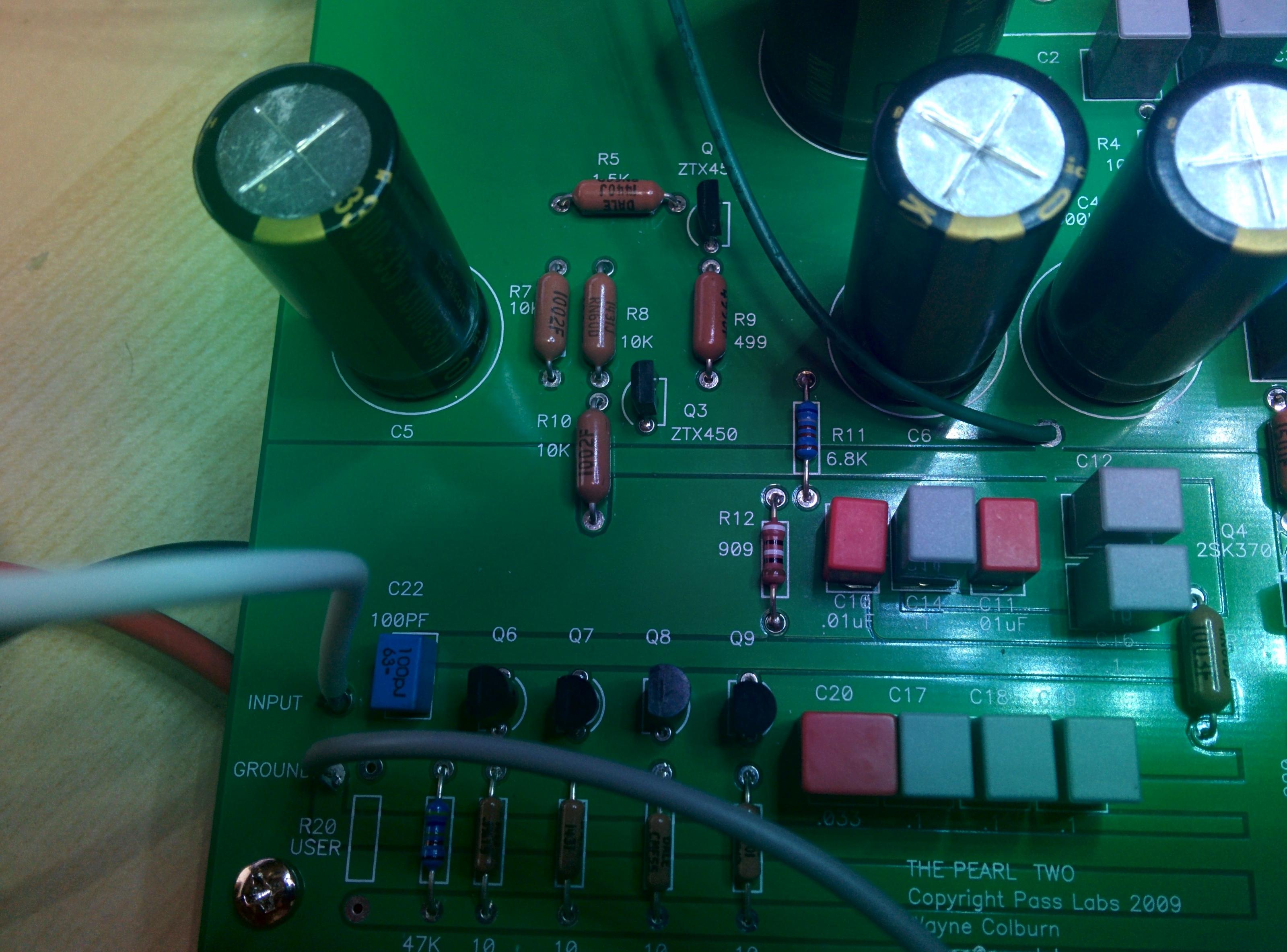

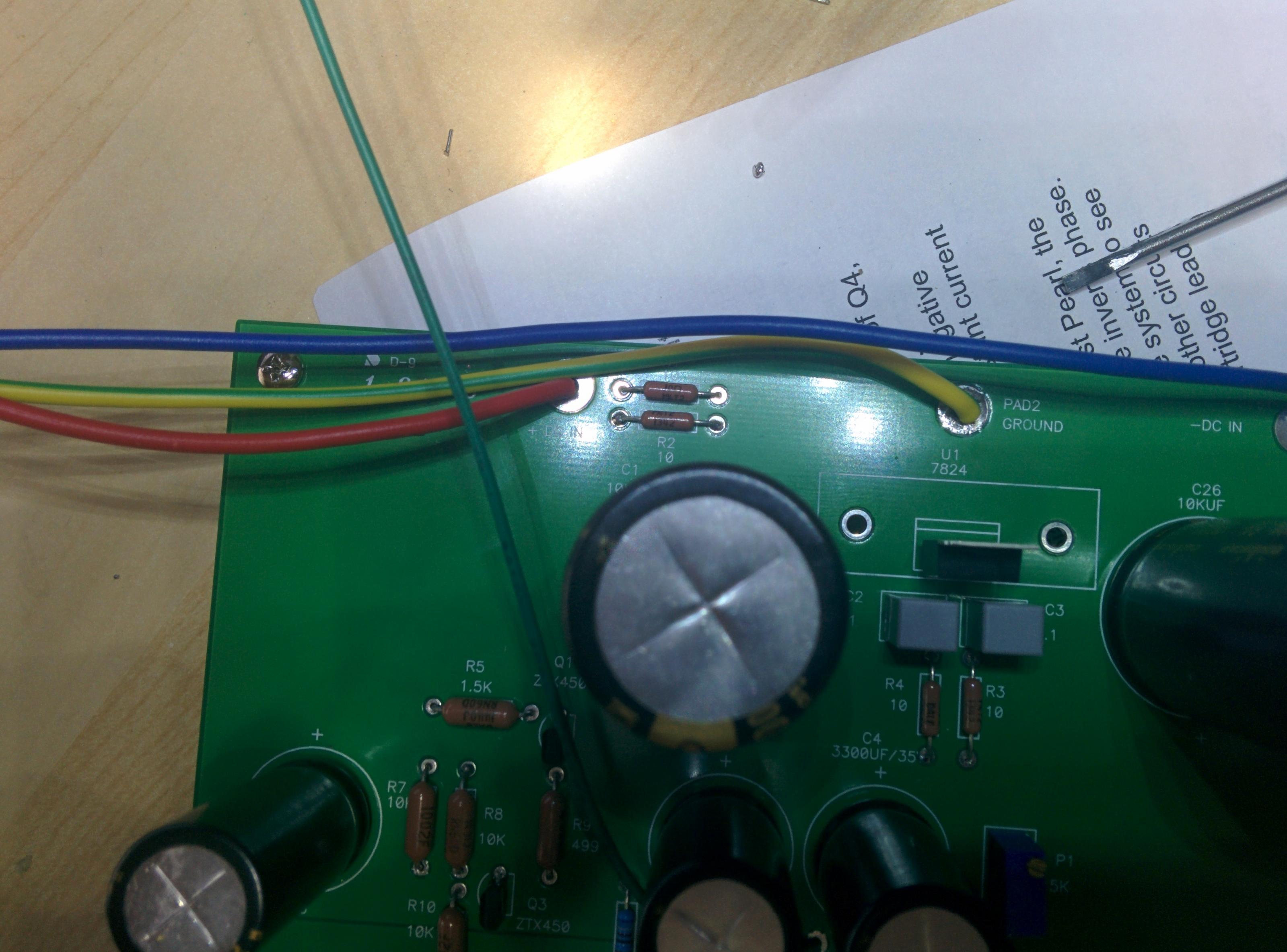

Some pics of the board.

Ive got great news. The ZVP3310 where bad i was killing it with my fingers. Installed new one with out touching it with my fingers and now i have .0009v at P1.
I installed 4 19.7 ohms on R21-24 and a 6K75 resistor on R10. My current readings are as follow.
Q3 Top:7.38v, Middle:7.37v, Bottom:6.7v
Q6 Top:6.71v, Middle:0, Bottom:0.121v
Q7 Top:6.71v, Middle:0, Bottom:0.121v
Q8 Top:6.71v, Middle:0, Bottom:0.122v
Q9 Top:6.71v, Middle:0, Bottom:0.121v
Q2 is so sensitive i don't even want to look at it...
Music IS coming through but its not clean. Ive got a high pitch noise that comes and goes.
Whats the next step?
