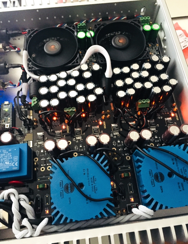

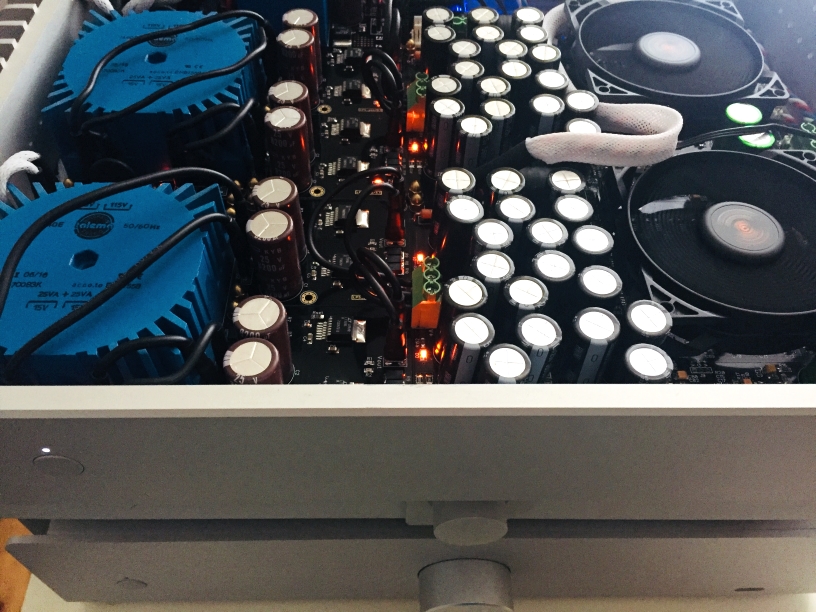

Finishing things up properly
After going through a couple of iterations for the power supply for this amplifier, I finally managed to finish this project. I re-used the aluminum enclosure my previous amplifier resided in to house this new one (it's originally an HTPC computer case).
Anyway, here are a couple of pics showing the end result:
The 90mm fans can be controlled dynamically using a temperature sensor mounted underneath the op amp array.
I'm quite happy with how this build turned out; thanks again to D. Self for the inspiration!

Any updates?
Well, it's been in use as my main amp for the past one year and a half or so!
I'm more than happy with the end result. It looks good and sounds even better. Some follow-up measurements I did late last year show that the objective performance is excellent as well, e.g., the THD+N is around -120dB or lower. I'd like to measure it more precisely, but-this being a hobby and all-I'm hesitant to invest thousands of euros or dollars in high-end measurement gear. ;)
Currently, I'm building an ES9038PRO-based DAC to go along with this puppy.
