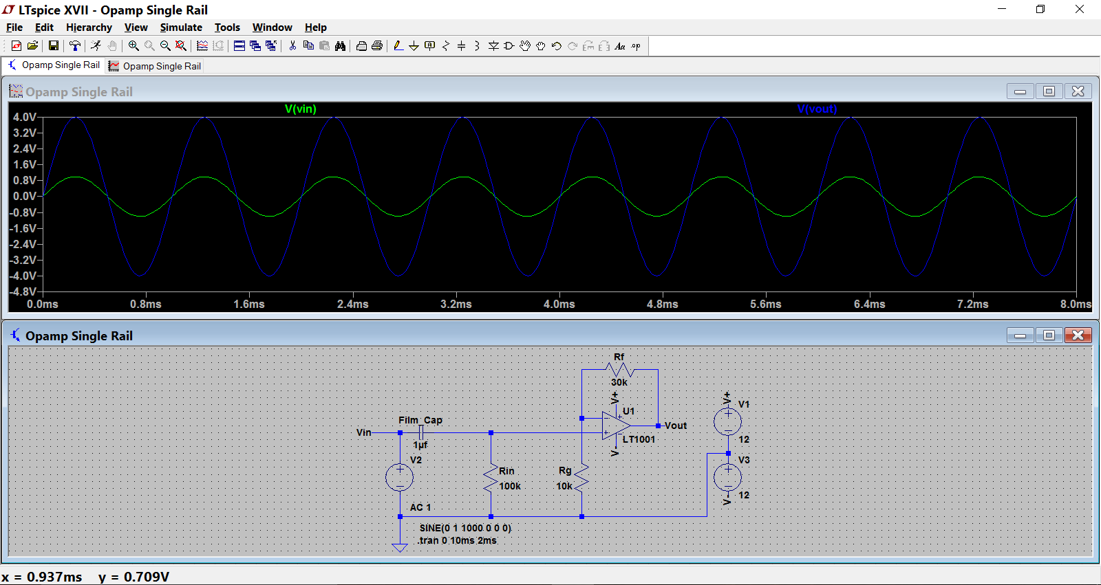

The two simulation programs that the majority use are 'LTspice' (click my signature line to see how that works) and 'Tina':
https://e2e.ti.com/blogs_/b/analogw...-free-simulator-tool-make-amplifier-sims-easy
A preamp is simply a small voltage amplifier stage to boost the level of small 'line level' signals. Its easy to make one with as much or as little gain as you want.

The TDA2822 wouldn't be a great choice tbh because it is more of a power amp (albeit a low power one) than a true small signal device. The problems would be noise (hiss) and also far to much gain.
What you need is an 'opamp' and there are dozens of suitable ones such as the TL072 and NE5532. They cost peanuts and only need a few resistors per channel to work.
