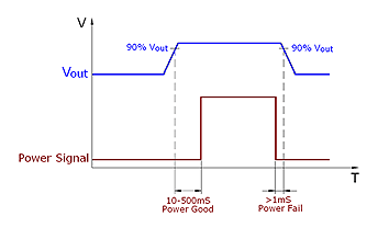

I've also been in contact with Teradak, a budget'y linear power supply company. They have a linear ATX PSU called the 800W(600W usable) Linear ATX Supply, and it goes for about $1700 shipped to North America. It's pricey, but significantly lower than the ~$5k that a 4 rail ATX Paul Hynes goes for. And with 800W I was looking at powering both my PCs with it in the Dual-PC Jplay setup I'm putting together. So that'd cut the cost in half, which is much more manageable.
Unfortunately I didn't use my brain all that well and didn't consider the power-on sequence being separate for both computers, so using a single 800W ATX Supply for 2 computers it out the window now.
*yes, I'm aware that some mobos aren't picky with their start up power sequencing, but I'm not looking to bet on that right now. I'm also using server motherboards, which I bet aren't going to be as forgiving as a mini-ITX that is very likely to be employed in some DIY scenario.
I was given another solution by Teredak, however, which is with their smaller 210W(usable) ATX Supply. I can buy 2 of these guys for ~$500 a pop, and I'm in China, so shipping is negligible. That's then $700 less than the original, and it's got the correct power-on sequence that I need! And at $500, I definitely can't DIY one for that price. Not with the kind of chunky aluminum chassis this comes with.
Here're some shots I was sent. Tell me what you guys think of it, and well, with the new route.

Sorry to sound harsh but my view is:
A lot of extra money for no real gains, look up simultaneous switching noise that the PC will create itself.
A lot of extra wiring with no regards to any possible EMC problems that this is going to cause and it will cause EMC problems. I don't even see any ferrites on the cabling or any filtering inside the unit. As to the PC end plugging that lot of cables into the supplies is bypassing the PC case (an major EMC barrier) and adding effectively antennas to the PC.
Power supply should be in the same case really. From past experience with these sort of things I would be surprised if the set up with an external linear supply would pass EMC testing, and EMC problems lead to signal integrity problems.

Hi Marce,
thanks for being the first to actually reply regarding my questions. There seems to be an interesting tangent going on there that I'm going to clip soon if it doesn't get back on track. I can see the underlying issue, whether it's worth it to go with a full 2 PCs or some other combination, however I think we're a bit futher off base now and arguing something that belongs in another thread. We'll see.
Firstly, I've read a lot of positive reviews from the "a motherboard inherently has switching supplies on it, so linear supplies can never fully take care of that", but then someone tries some sort of multi-rail Linear PSU and it sounds good. In fact, if you read back just a few posts you'd find someone commenting on just that. Most of the time I hear someone saying "it can't sound better, it's science", but they've never tried and can't tell from experience. You, on the other hand are saying that you have, but with less than positive results. Interesting, mind filling me in and what you tried? Help me see further whether I can see the parallels in what I'm talking about now.
And then about the cabling, I think you may have misunderstood some part of the design. There would be one umbilical connecting the PSU to the computer chassis, then inside the protection of the computer chassis all of the looms would go to their respective slots. Once inside, this is no different than a normal computer power supply. As for the umbilical that ties the two together, this is common with any low or high end component with an external PSU. Nothing wrong or out of place there that I can see.
Now on to the EMC(or EMI compatibility/control) issue, that's a potentially different story. I've never seen computer wire looms with ferrites on them, but I think about $5 could solve that problem if I wanted to give it a shot. Which now that you've mentioned it, I think I might. And given that we aren't talking about Delta Electronics here, I bet the EMC testing was indeed on the slim to non-existent side.
->Because I've also been going down this path for a while, I have EMI absorbing/reducing material, copper shielding tape, and copper shielding braids. So I'd say once I get it all into position, I'll start shielding all the looms anyway. I can report back on any difference if I hear one.
As for internal PSU filtering and EMI mitigation, that is true and I don't really see anything like that. There is a smaller transformer inside the blue, plastic housing, so potentially that's it? But yes, no chokes, and not raelly any by-pass caps, that's for sure. Any ideas on how to increase anything like that, from a basic point of view. I know you've ruled out this PSU, but if you were to think about improving some part of the internal EMI control, without overhauling it all, what would you do?
The problem with PCs is not noise getting in....its noise getting out. As you may have gathered, its pretty noisy in a PC and for all the digital stuff the PC doesn't care and it doesn't matter and they can be built at a reasonable cost, so all the effort goes into keeping the noise in the PC then passing CE etc is easier. Adding that umbilical may allow this noise to escape, a decent ferrite would help here.
My own view of these things and from working with other stuff where analogue and digital meet (its more common than people think) is for the best analogue fidelity isolate the last stage with the bare minimum digital (the DAC or ADC) components in that last section.
As I said I was possibly being unduly harsh, but for practical reasons. it is something to watch out for.

Here's a pic of a small circuit board I've been working on to manage voltage monitoring and ATX power on sequencing. It monitors 12V, 5V and 3.3V, provides power to the motherboard at the right time and manages the PWR_OK functions. At its core is the TPS3510. C1, C2 and C3 are placeholders for now - they provide voltage slew rate control to protect the pass transistors.
