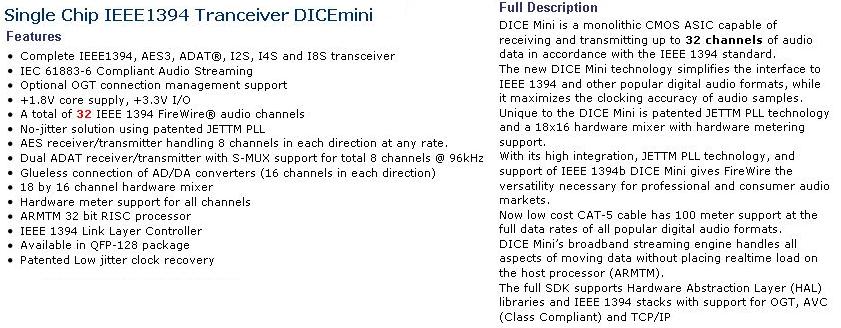

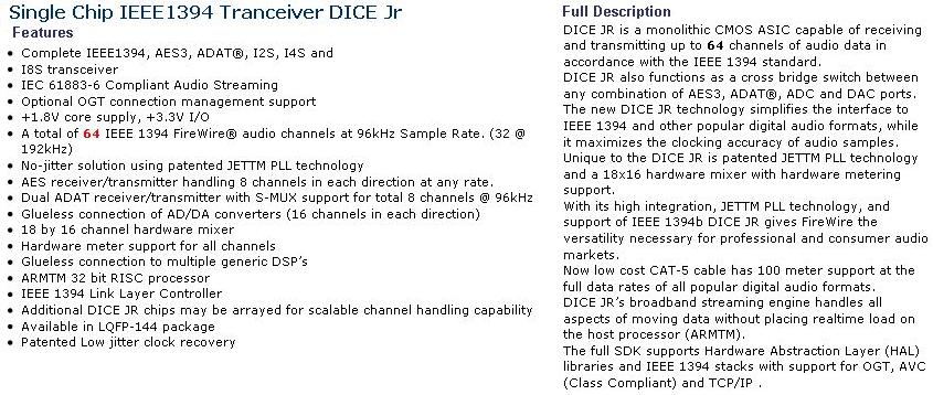

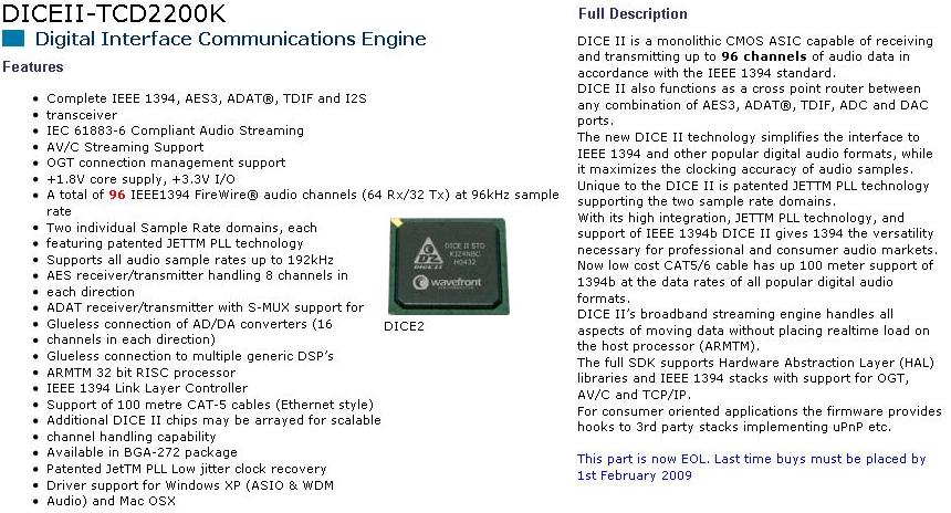

Can we use Digital Interface Communications chip, example
Single Chip IEEE1394 Tranceiver, I2S direction...
See picture below
