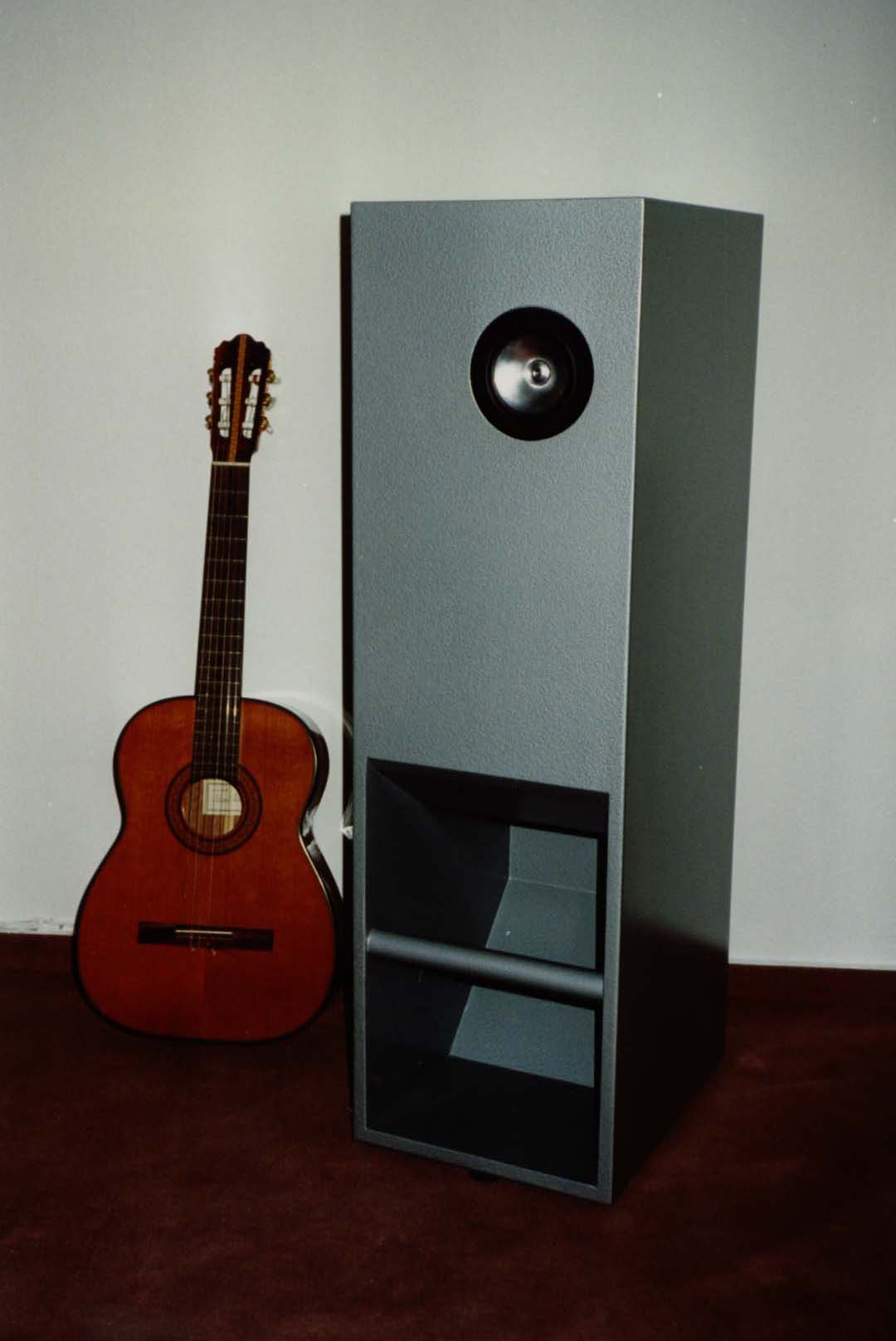

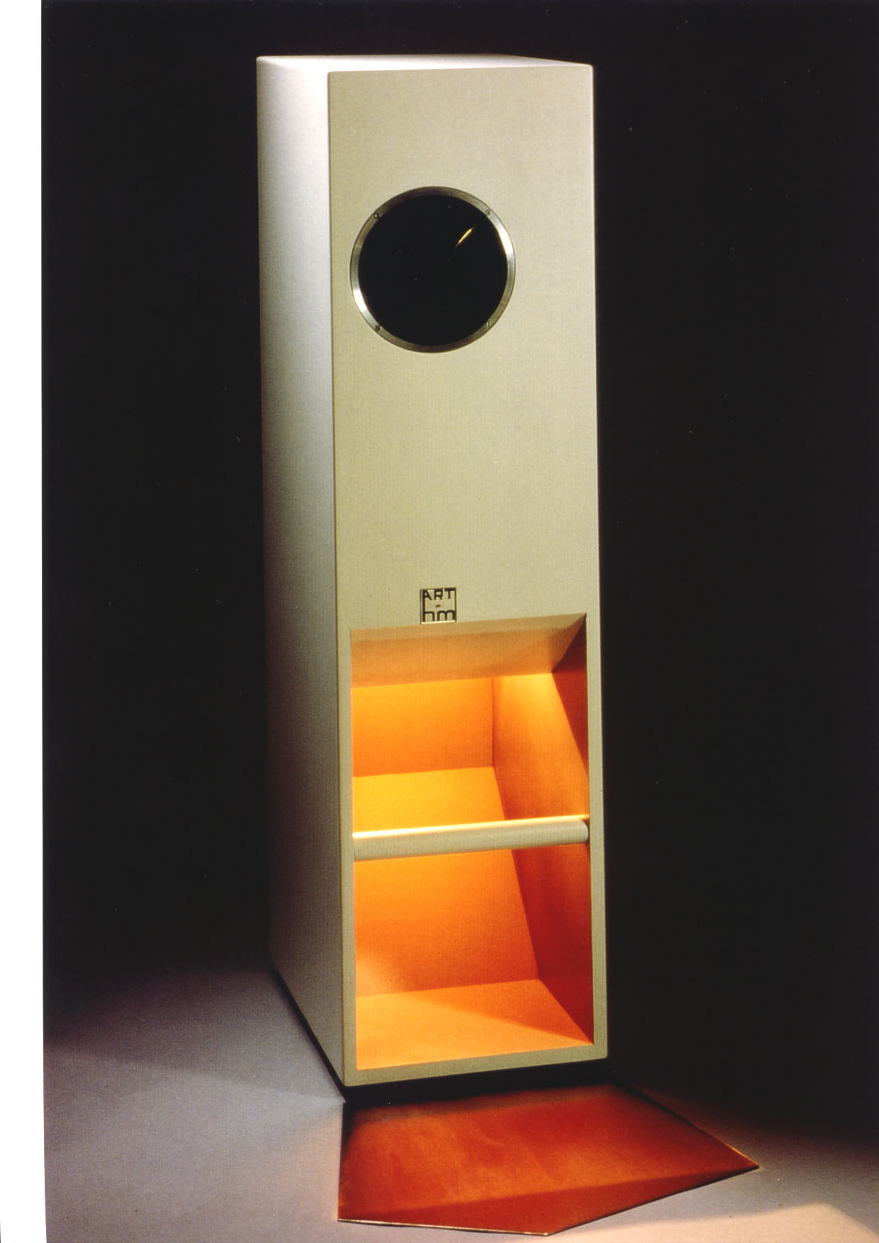

My goodness, that's a lot of working space. Quite a bit bigger than a Sachiko (340x1830x460), and they're pretty hefty cabinets. I wonder if your PM6C would be compatible...
The Spawn Family of Double Horns
edit: Hmm... the construction plans specifically mention the PM6C. I'd say go for it.

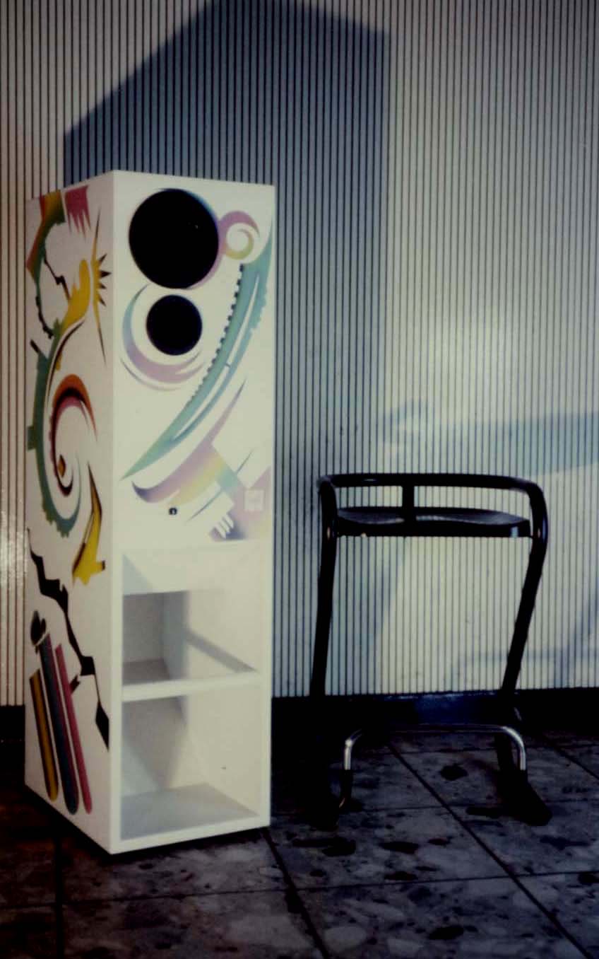

Here you get feedback, plan, measurement, may be take goo.. translate if you need:

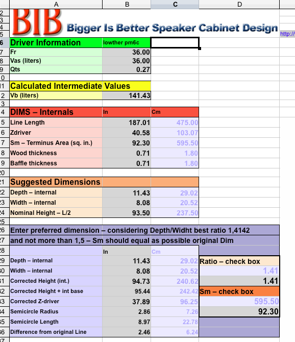

Thanks - I've just had a look at the BIB stuff. Your point about starting with something relatively easy is a perfectly valid one of course, although I'm wanting to be a bit ambitious with this because I won't necessarily have the time or opportunity to repeat the process in the near future!
I plugged the Lowther PM6C specs into the calculator on the BIB site by the way... assuming I got the specs right (different sources seem to disagree on them) it suggested a 2.4m high cabinet which is pretty big! (see below)
