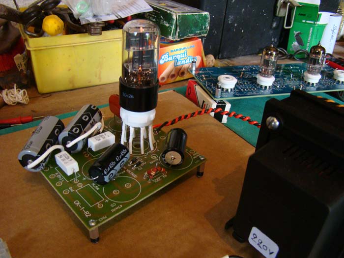

5687 tubes arrived today.
Hooked everything up.
I am getting 258 V B+ at the moment with a 0.47uF cap in C1 position on Bas's psu which is ok I believe.
I will try adding another cap to see if this raises to experiment.
But I don't have the heater bias connected yet to the virtual center tap.
I don't quite understand what this is for and what effect it has.
if you look at the tube data sheets it will specify a heater to cathode max voltage.
to put it simply, the B+ goes through a voltage divider which is then often connected to the CT of the heater secondary. There is no closed circuit with B+, so no current flows, it just super imposes + whatever voltage you specify. The 6.3v can then vary around that new super imposed potential.
Brit,
Think of the Bias this way:
A-----------B-------------C
0-----------0------------12
A-C = 12Volts
A-----------B--------------C
50---------0--------------12
A-C = 62Volts
B-C = 12Volts
Heaters are powered from B-C
A is Bias from B+ supply
Voltage measured from different points give different results
When the CT of the heater supply is connected to ground the voltage is the first example
When the CT of the heater supply is connected to B+ Bias the voltage is the second example
The B+ Bias basicly raises the 0 (zero) above ground (earth)
If you take 2 AA batteries placed in series, measure the voltage on the extreme ends then measure the voltage from the middle to one end. The voltage is different depending where it is biased from.
I hope that makes sense.
Merry Christmas
Ron

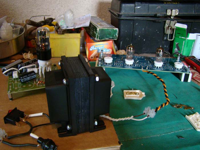

No hum!
I have spent some time with my aikido lately
The old supply with the choke wasn't clean. I think it was self-oscillating!
So I removed it, and then I built a normal CRCRC-supply!
Note the green (round) caps on the last picture. I think it's important to have some film-caps near the signal-circuit!
What are these caps called? I don't know the word in english...
The result: The amplifier is dead silent!
Left to do: Change the power supply resistors to new ones with a little higher values! My goal is 220V B+, because John Broskie wrote so in the schematic. It's about 270V as it is now...

Re: No hum!
Well done Olle, I can only hope mine is as nice as yours.
Have you looked at the "curve" of your tubes to find out what/where 220V is compared to 270V?
1/2 of 220 is 110 (Aikido splits the voltage)
1/2 of 270 is 135 ........Only 25V difference. Let us know if you hear a difference when you change out the resistors, please.

JB's new board is slightly different.
I am using 470 ohm cathode resistors as the 6N1P have an average mu value. He says to use higher value cathode resistors for high-mu triodes.
He also mentions running the output tubes hotter, not sure why exactly, I understood it was so you could change the output tubes with the input tubes as they wear out quicker but with this design you cannot.
I have the cathode resistor values equal for input and output tubes.
B+ is currently 260 V.
I'm going to decrease the bias as JB recommends 1/4. Mine is currently 1/3 of the B+.
