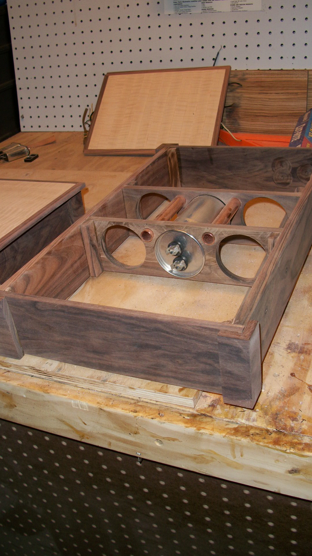

This is the preamp I had built recently, which has tube rectified and regulated power supply. The noise cancellation capacitor had been removed.

jimhu said:This is the preamp I had built recently, which has tube rectified and regulated power supply. The noise cancellation capacitor had been removed.
Jim Hu
Great work Jim!
Can you show us the schematic of your regulator please?
Actually the regulator comes from:
Frank's Ultimate Tube Preamp Post #74
Regulator Schematic
And two 1N4007 are replaced by 5AR4. But be careful, the filter capacitor (330uF 385V) value must be reduced for tube rectifier.
Jim Hu
Regulator Schematic
Jim Hu
