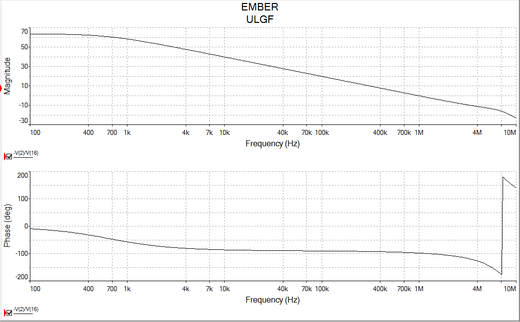

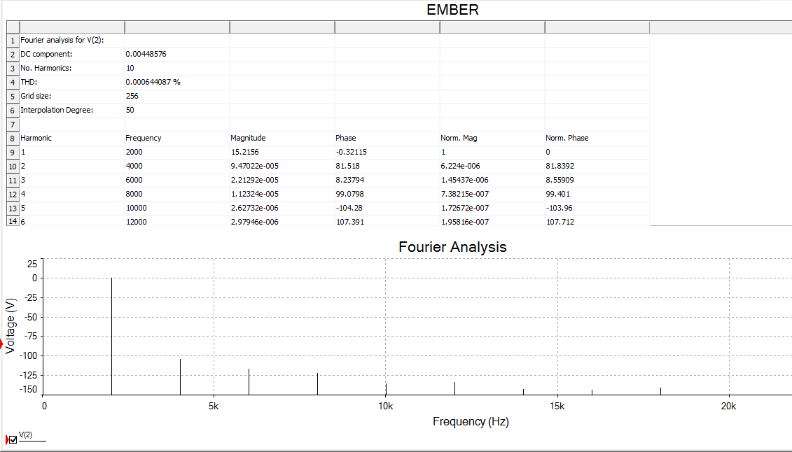

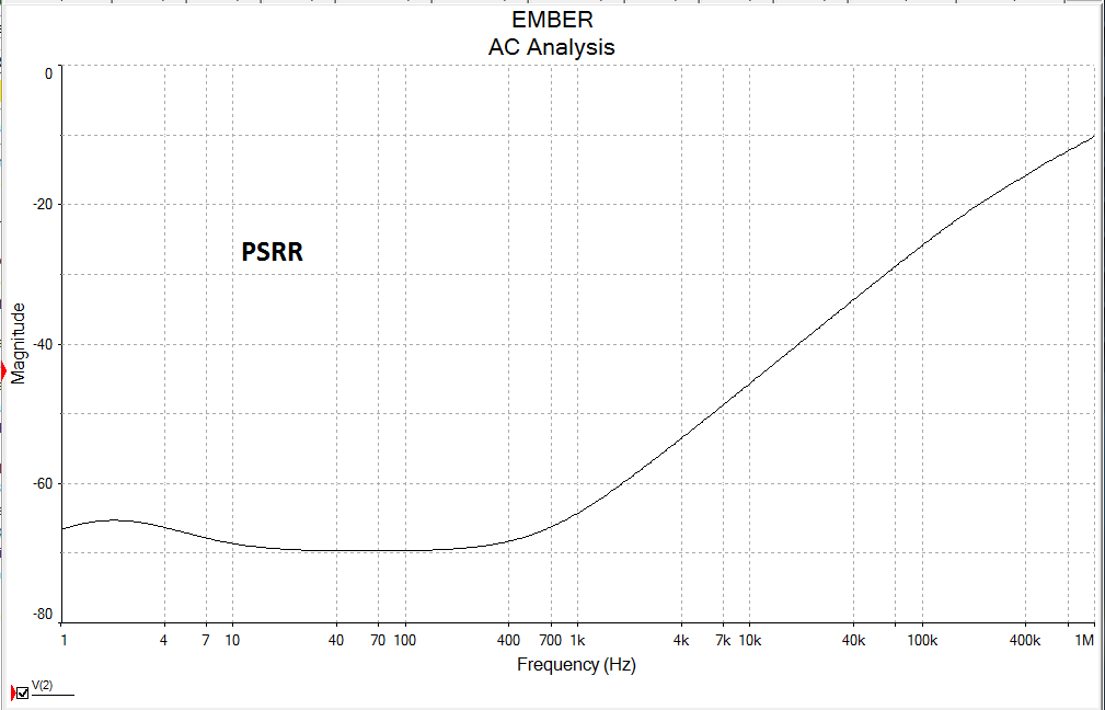

I made some changes to it, mainly to operating points and the compensation scheme. I changed cdom from a shunt type compensation to a miller type. This, according to reliable info and verified by simulation, lowers HF distortion.
The schematic:
and in pdf for those who wanna closer look: View attachment EMBER.pdf
With the changes, I changed the name to Ember. The reason for that will be more apparent when I show the finished amp.

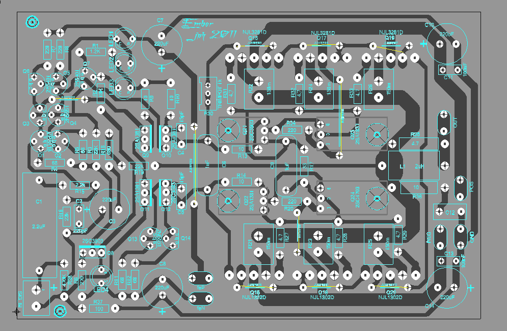

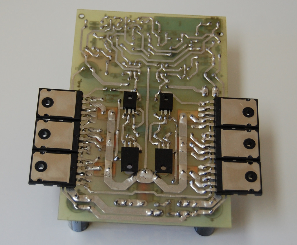

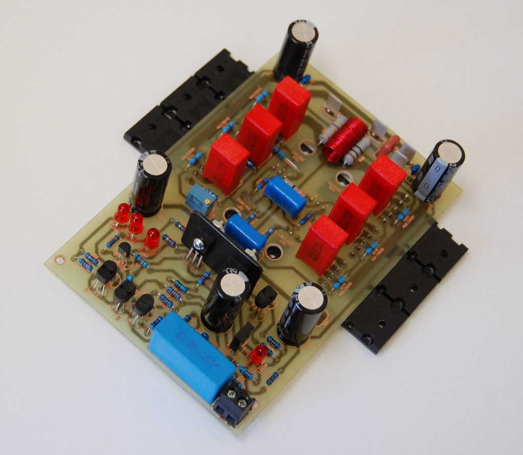

Getting 6 of these amp modules to fit on the heatsinks I've procured required a tight layout. My heatsinks are 4 pieces, 8" high x 8.5" wide. That would be 2 per side, making the sides (and total heatsink area) 8" x 17".
The amps will mount directly onto the heatsinks, freeing up needed space inside the chassis. This also results in better heat transfer.
The layout:
and assembled:
a look at the undercarriage:

This looks very good! Nice compact design using Thermaltrak devices. Is that schematic your final, final version?
Thanks and yes, the schematic is final, final (at least the pdf one is, R17 on the screen pic is 22R, should be 33R).

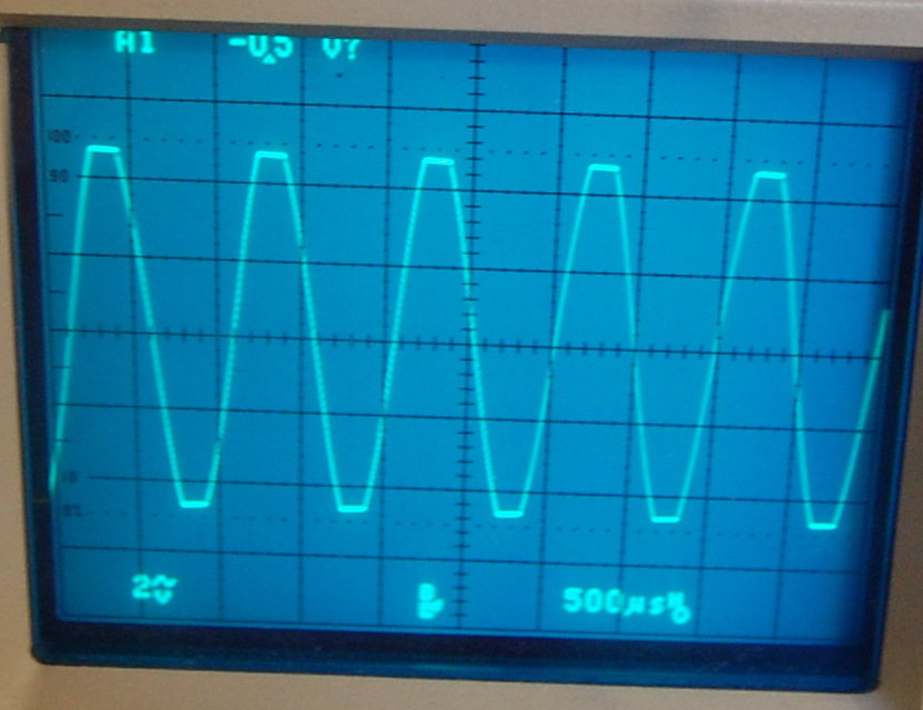

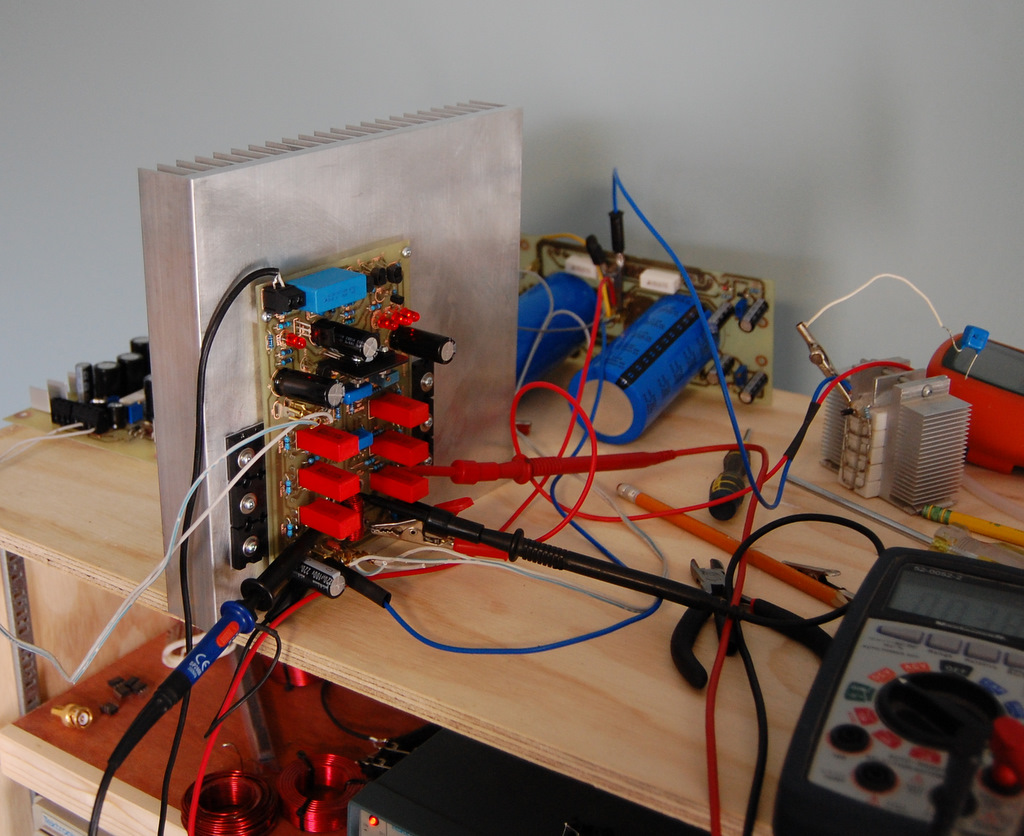

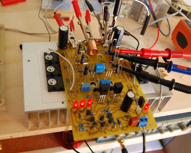

Even though I had a working prototype:
I made enough changes to the layout to warrant testing the new one:
That's running on +/-55V rails on the output stage, +/-56V regulated cap multiplier supply for the front end. Working splendidly.

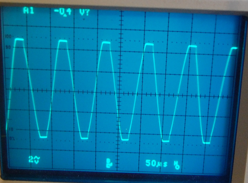

1K clipping into an 8 ohm load:
10K clipping:
Slight sticking but not a big concern.

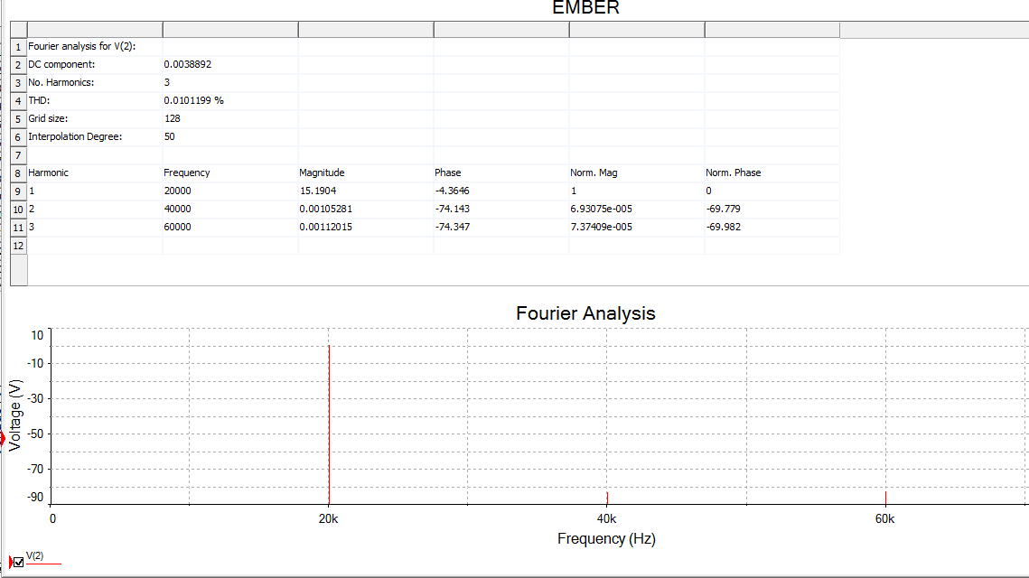

With this supply, I have ~136watts into 8 ohms before clipping. The projected output is 150 watts into 8 ohms with the higher voltage supply. This higher voltage leaves some headroom to avoid clipping altogether.

Nice , they are starting to look more like mine ...
Really , you are "top gun" in layout.

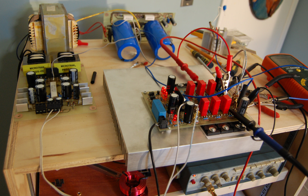

I replaced R2 with 82K and have been doing some more testing, in particular thermal stability.

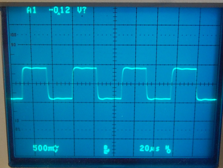

But first I did a capacitive load test, with a 1uF cap parallel with the 8 ohm dummy load:
The 20K squarewave with this load:
I'll take it!

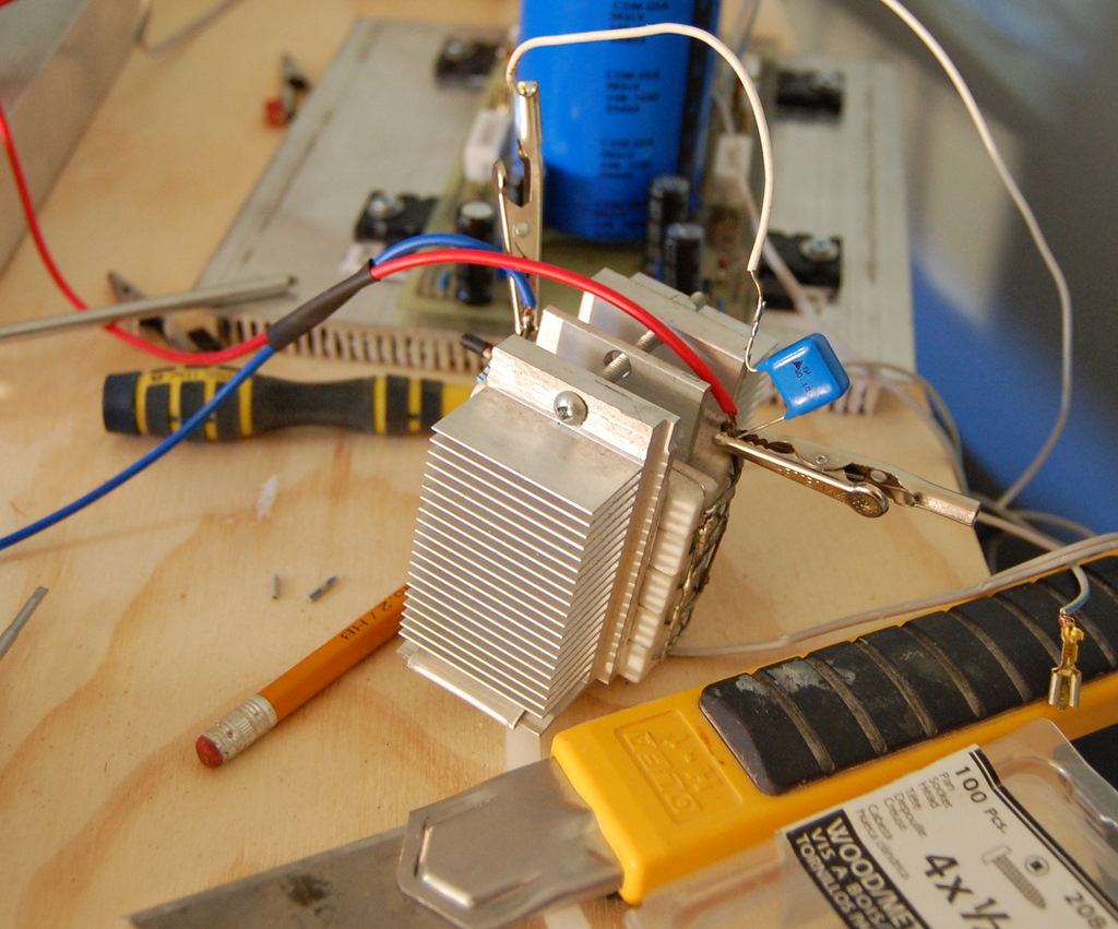

Next, I've been running thermal stability tests. The setup:
My concern was where I want to mount these modules on the heatsinks (lower part) and how much of a difference there would be in temp across the heatsink.
I set Iq to ~70mA/output and let that cook for about 20 minutes. The bias drifted up slightly - 1-2mV across the 150 mohm resistor. Not a concern. I measured the heatsink temp at that time and found it uniformly warm, 1 degree in the difference between hottest and coldest.
I then gave it signal to give an output of about 10 watts into the 8 ohm dummy. Let that sit for ~15 minutes and then measured the temps. At the face of each output I measured 48*C, directly behind between the heatsink fins I got 52*C. The top corner, opposite to where the amp is mounted measured 48*C. On a sidenote, the small heatsink for the VAS measured 44*C at its centre. Q8, without a heatsink measured 41*C.
After leaving it to cool for 20 minutes, Iq remains steady at the earlier setting.
My conclusion is that having the amp mounted lower on the heatsink is acceptable, given the small variation in temp across its surface. One thing I am concerned about is whether 2 of these heatsinks are adequate for cooling 3 of these amps. The testing setup is far from ideal, as the heatsink sits on the plywood shelf, it's not as open to the air as it will be.
I may need to bolster the cooling potential by using aluminum for the sub-chassis, rather than steel, as I originally planned.

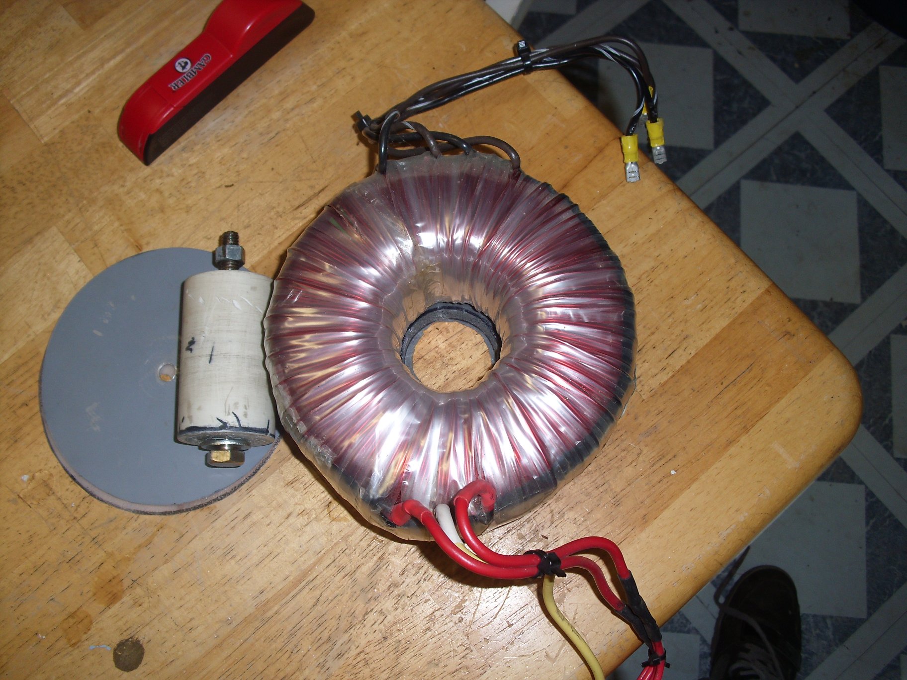

The plan, as of right now is for 1 transformer, 2 main supplies, 2 front end supplies.
The main supplies will have 100nF bypass and 39,000uF smoothing caps per rail.
The front end supplies will be regulated cap multipliers, fed from the main supplies.
Each supply will feed 3 channels - 3 left and 3 right.

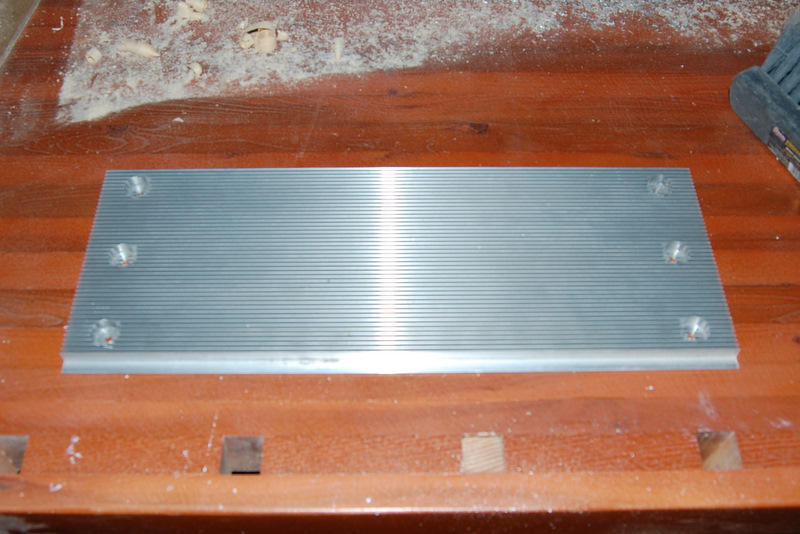

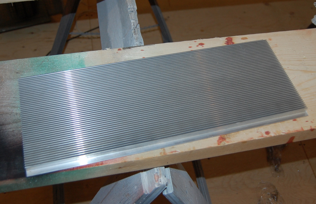

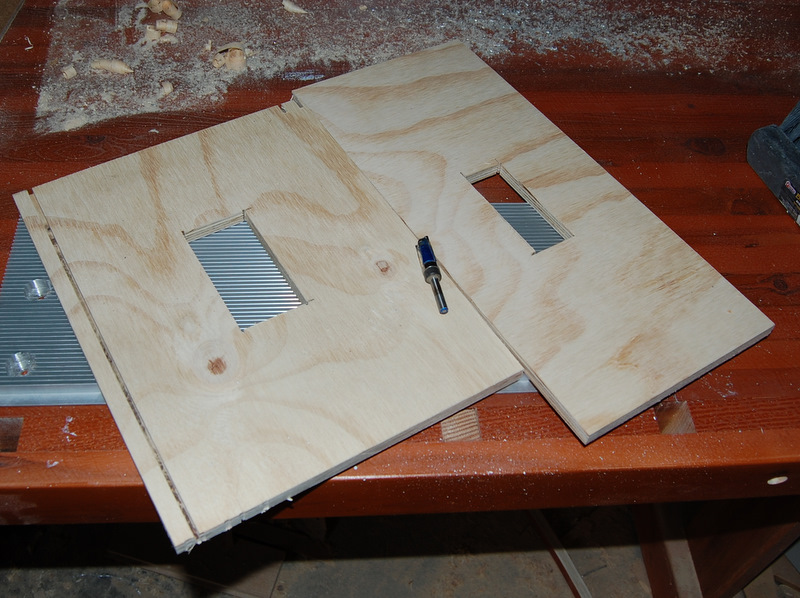

Some chassis work today. Following my own recommendation to add more heatsink area, I cut this piece for the back:
This is 7.25" wide and cut to 18" long. The fins are only 1/2" long and tightly spaced but ever little bit helps, as far as cooling goes.

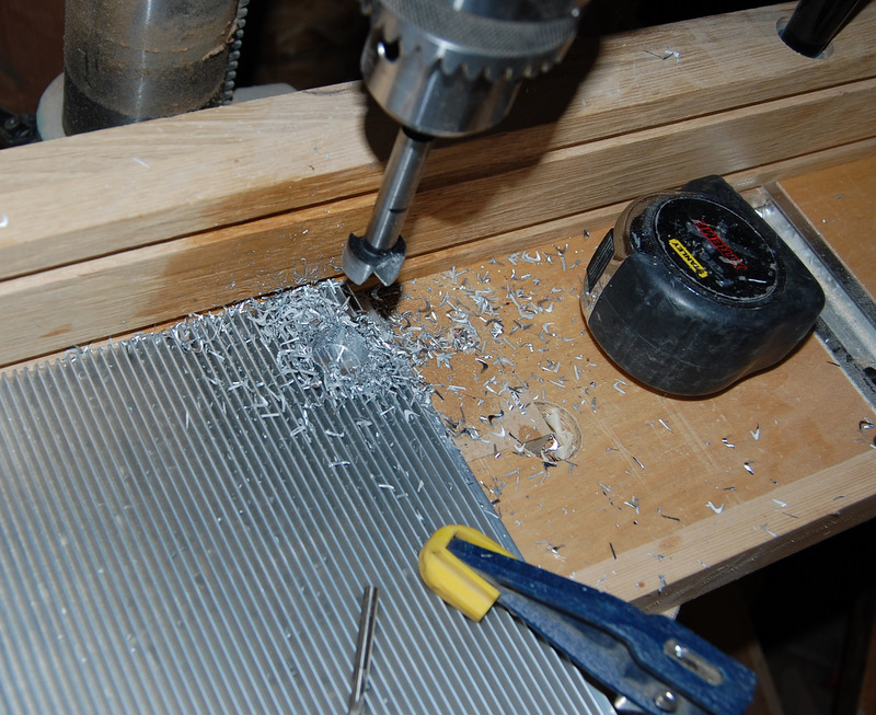

Some machining:
These recesses are for screw to fasten it to the ends of the main heatsinks. Drilled with a 3/4" forstner bit.
Some machining:

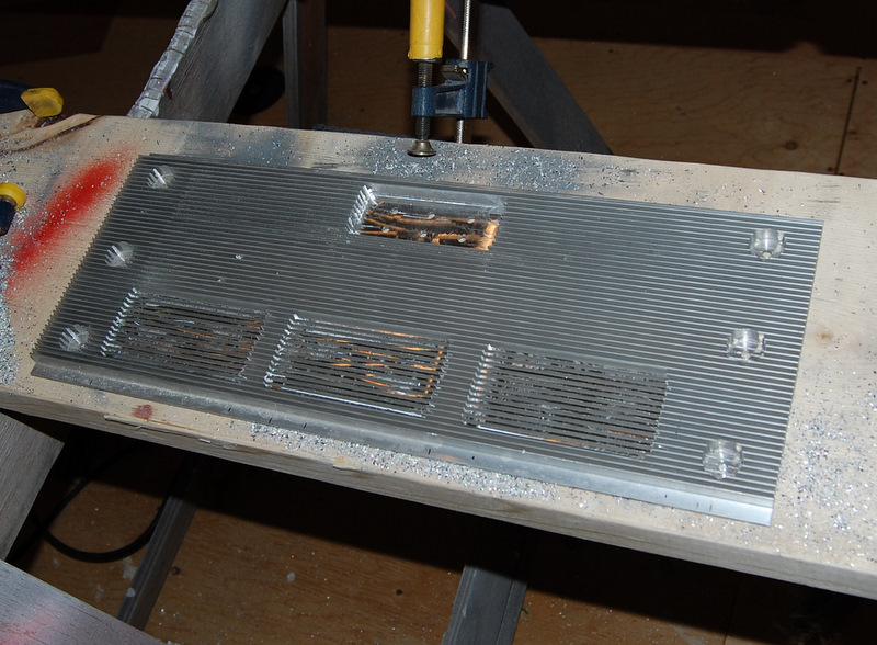

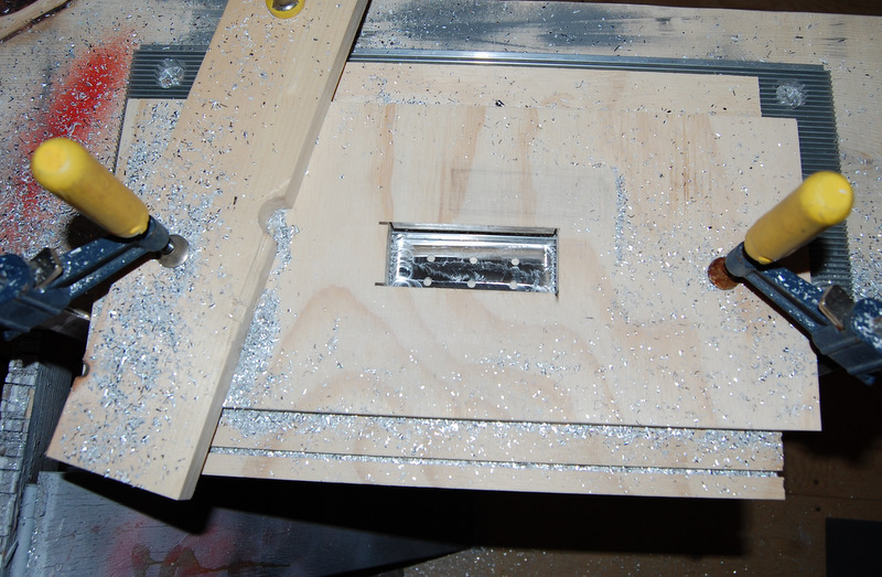

I need recesses in the fins for the input jacks and the output banana jacks. I made a pair of templates:
to guide the follower bit in the router. The small template is for the input jack recess, the larger one for the outputs and the IEC and power switch.
Routed:
patience and hearing protection required! It takes several passes to cut away all of the fin. Having the template clamped down tight is critical.
The larger recesses don't go full depth:
just deep enough to make it possible to mount the jacks.
It's starting to look like something now:
temporarily attached to get accurate measurements of the other parts needed. Jacks installed for dramatic effect.
PS: no, that's not blood on the plank. Red paint.
