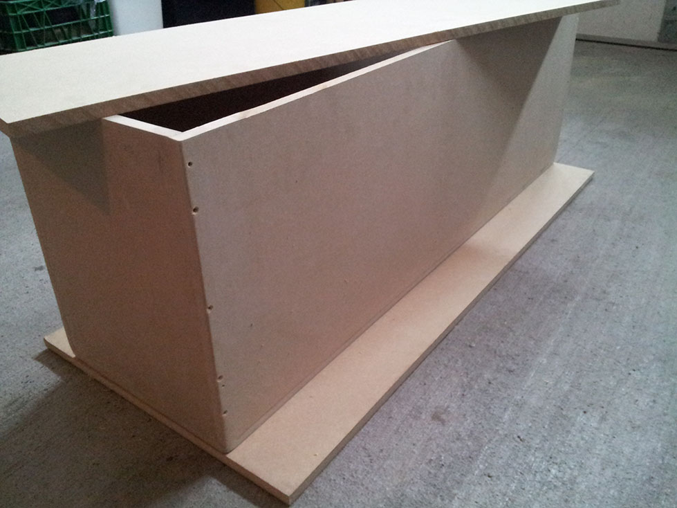

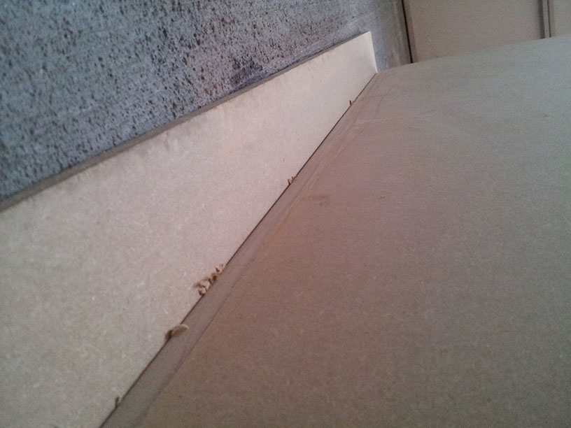

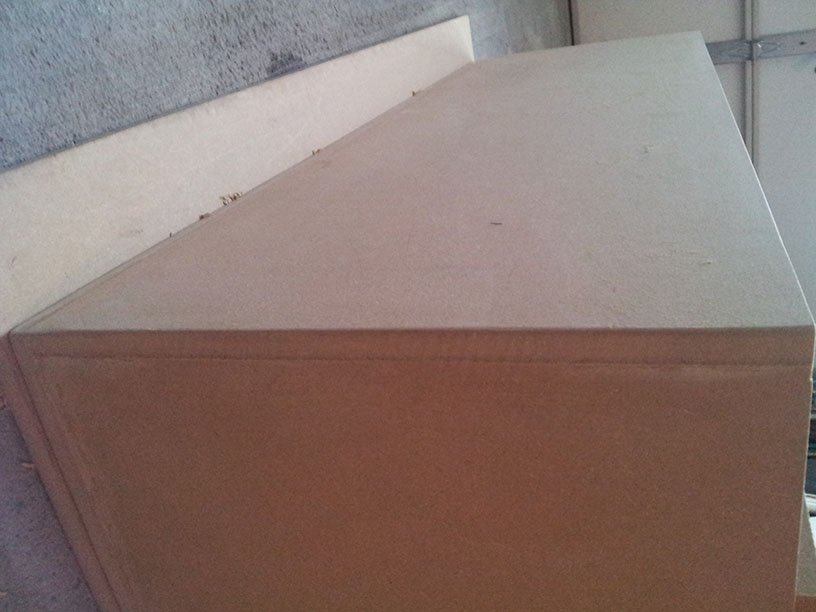

Ok so the box is almost done. The cuts from the Lowes near me were ATROCIOUS!! All the sides had overhang, or underhang, some up to 4mm!!! on 12mm wood. Anyways.
I sanded all the joints dead equal, and spent some time smoothing all the corners except for the top piece, which I am going to allow to be removable. A little more sanding left, then paint. The colour I chose is Tree Frog Green, with valspar's signature hd colour paint (was 2 for 1 this week :D)
The box is narrower to allow magnet to magnet mounting, however I am not going to split the chambers after all. Without the middle enclosure, I can get enough space for 0.5-1db of extra output @ 100hz from a larger enclosure volume.

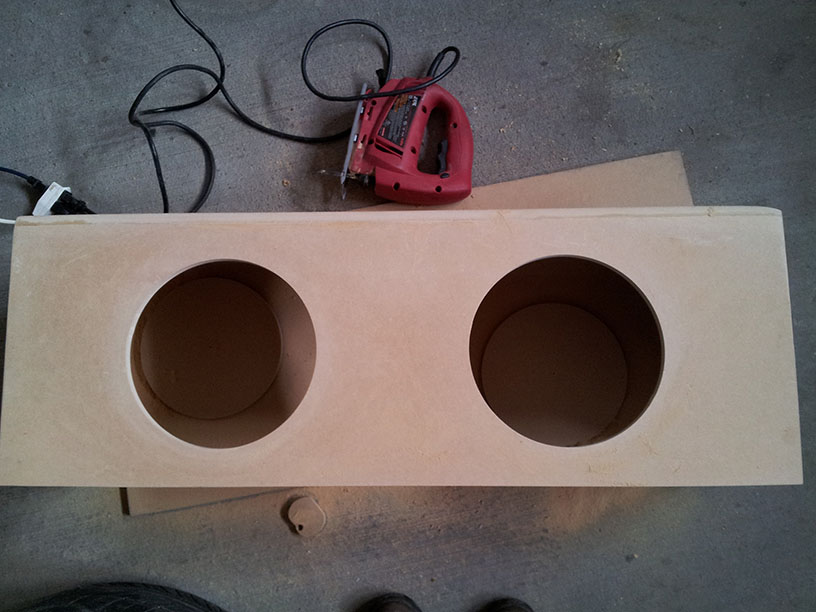

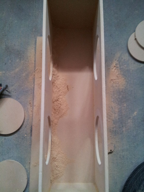

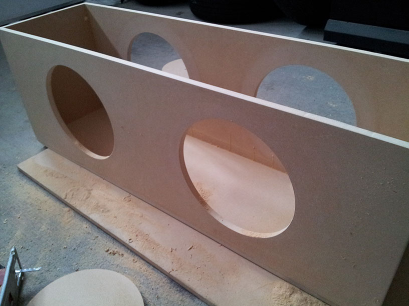

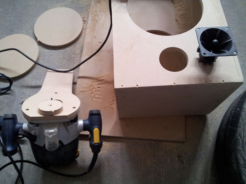

Ok I just spent a couple hours cutting out all the required holes, EXCEPT for the 3" port's on the sides (since I don't know exact O.D yet, I want to be precise). I got all my measurements within half a millimeter so I am pretty stoked.
Next step is to fill the screw holes and any slight variations with filler and then sand to make the surfaces smooth. Then router out the port holes, then paint.
