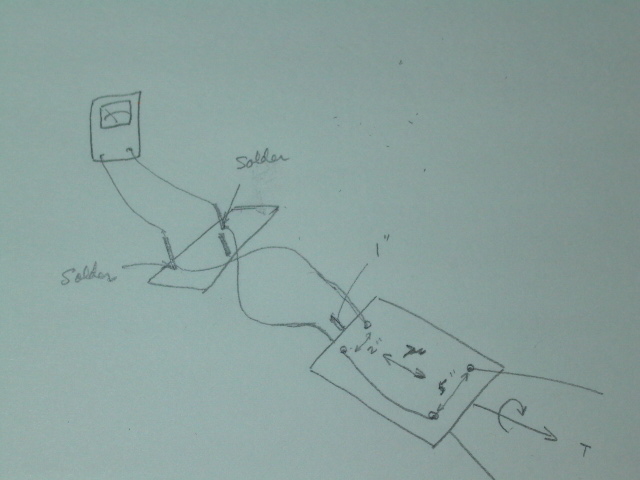

I didn't count but I can show you the size of the tool that can help the job, in the picture tip 1" first holds 2" second holds 5" between 7", card broad is fine will not hurt coating, fingers hold wire to broad and pull slightly and turn, then tip point move to the last cross and turn, this will good for 28 to 30 awg solid silver, if the cable begin to tangle after a while that mean it twist too much too tie will break off, need longer tip
tony
Hi BinsHello Tony,
Great illustration. Thanks a lot.
Bins.
sorry I did a mistake acturail size that is CM not inch
tony ma

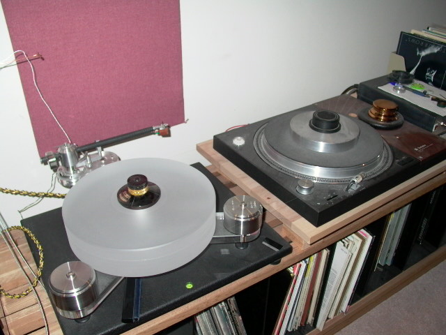

after the tonearm cable project you can go for the belt too, it also will give you a big surprise too, try more different material to meet your system, because every system react different, in my case a very thin elastic threat is the best, little force can stretch a lot is good for my old direct drive tt as the driving motor and pulley, still tonearm cable is more direct to the up-grad, after this done can catch the different sound of the different belts more easy later
regard tony ma
Hello Tony,
I am using Kevlar thread of 0.5 mm diameter as my turntable belt.
Best regards,
Bins.
Best regards,
Bins.
Hi Bins
regard tony ma
