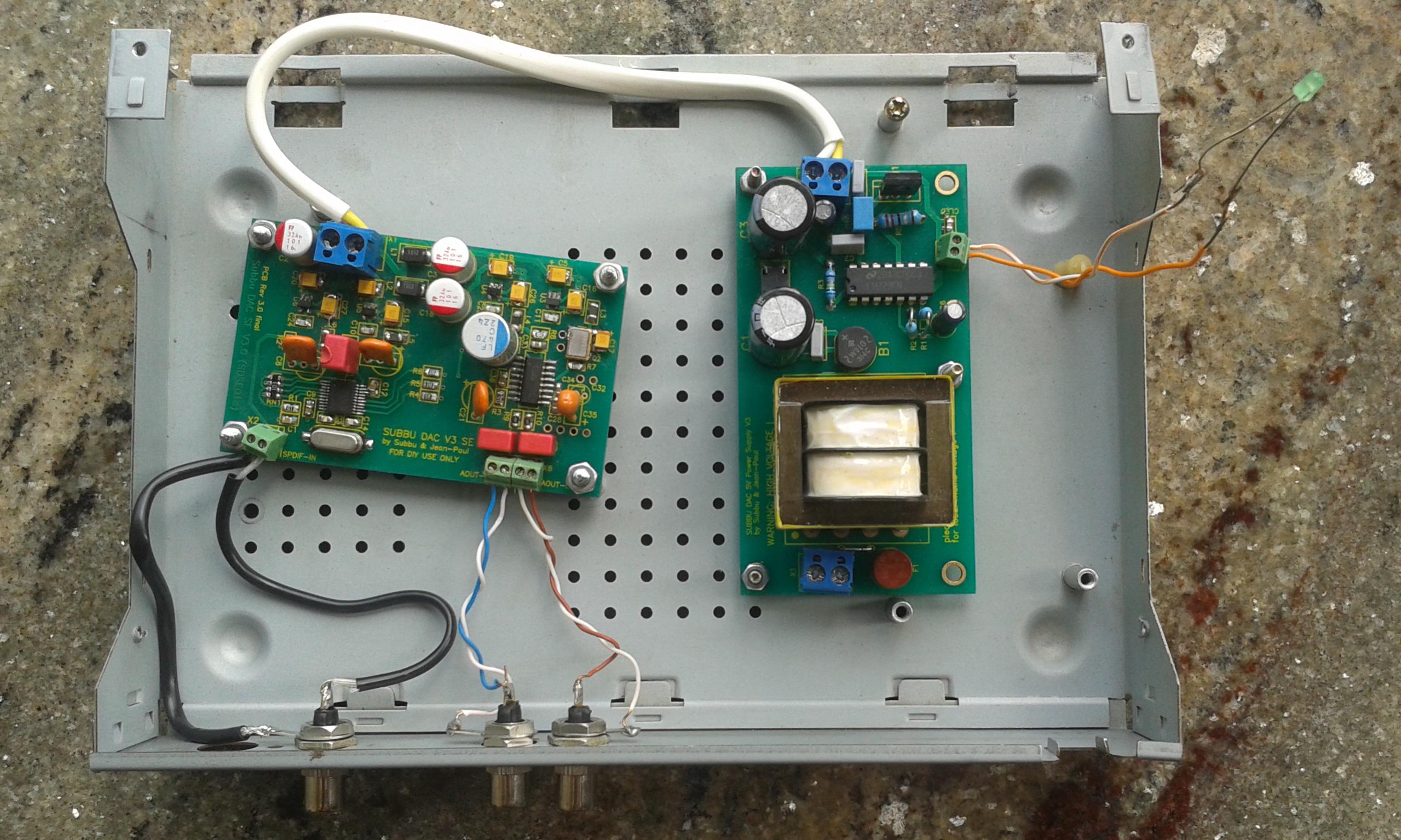

...just wondering if the PSU is too close to the DAC?
No but I would turn the PSU board 180 degrees to the right. I think you will have a problem with putting the wires in the connectors otherwise. You will have to place the power switch to the left then. I like switches to be in the middle of the case but then 230 V wiring will be close to audio circuits. It is way more practical to place 230 V switches at the spot where the 230 V input and transformer are. In other words: keep all 230 V stuff at one small spot.
Also keep some distance between boards and back cover. It will prevent cabling from being forced against that back panel or the difficulty of routing the wiring to the RCA connectors.
Disabled Account
Joined 2002
BTW keeping 230 V stuff at the right side of the board so at the SPDIF side would make things more convenient and away from the L and R outputs. So the power switch placed on the right side, PSU turned 180 degrees to the left. That is a choice depending slightly on your other gear and taste...
Thanks JP. Do you mean 90 degree? ...so both boards are parallel to each other and the transformer will be on the right side?
Where a cable enters a sealed box with a screen, that screen should be connected to the box with a very low impedance connection at RF frequencies, the best way to achieve this is a ring of low value small case ceramic caps (X7R or COG) this will provide a low impedance path for RF (EMI) and prevent a possible ground loop problem...
Darhanjoshi why have you two separate wires for the SPDIF input, from that photo that input looks incorrect with the SPDIF GND separated from the actual signal.
Actually I am using a 75 ohms cable. I was facing difficulties soldering these cables since they have a ground wire on top of main wire unlike other cables which run in parallel.
So i have used two cables. In one cable, I am only using the main wire and not using the ground. Vice versa for other cable. Trust me it is much easier to work.
Its also wrong, you would be better of with twisted pair same as your audio rather than what you have at the moment. If you are using co-ax cable then you should use only one with the signal going down the centre core and the shield should carry the return (GND).
As it is you just have two wires carrying the signal and its return, and for the ultimate SPDIF signal integrity these should be in close contact either via a single co-ax or as a twisted pair, not separated as you have them.

I think you're not seeing the forest for the trees. I've been a big advocate of insuring the entire SPDIF chain is 75 ohms every step of the way. But a lot of people don't want to be bothered changing connectors from RCA to 75 ohm BNC and ensuring that all their cables are 75 ohm.
If I look at the picture of Darshan's build, I see that he's still using an RCA jack for the SPDIF. Given that fact, worrying about the details of the wiring from the jack is probably a 2nd order effect. His DAC is working right now, so unless he wants to rebuild it with better connectors down the road then I wouldn't worry about that particular detail. So yes you are right, but I'm not sure it's worth fixing.

Any ANY discontinuities between a digital signal and its return path cause problems including increased jitter, instead of using two cables as shown he would be much better of using twisted cables as shown on his audio connections. This is much more serious than a slight impedance mismatch in terms of signal integrity, so no ground return discontinuities are more serious to signal integrity than slight impedance mismatches with the frequency and usual rise times employed for SPDIF transmission.

Considering the audio is twisted pair then why not show the same care for the SPDIF. I would never route a digital signal of wire one with a return path discontinuity, and in this case it is as critical if not more so than ultimate impedance matching down the line, this is a 1st order problem.

If you have not all the jacks & plugs in BNC for 75 ohms, don't mix 75 ohms plugs with non 75 ohms RCA sockets. First use the 75 ohms TV cable with RCA if you already bought a RCA for the spidf input on the DAC and to make the spidf wire with a TV cable
Then If you can on your source : try a coax 75 ohms cable for TV but this time directly soldered on the two pcbs (soldered on the top of the trough hole for the signal : the center coax insulation make a good protection against a short with the gnd wire shield of the coax you have to solder on the GND through hole)
You will have here a way to test for nothing a true 75 ohms (if a real 75 ohms TV cable) connection to hear the difference.
For the audio signals with RCA, just use two plastice circles by RCA plugs to isolate from the case the RCA body as the scew (none on them of course ahs to touch the case for an insulation). For SOTA design follow after Marce inputs but this the icing on the cake, you need first to use the correct wires then plugs. (50 ohms RCA for analog signal ; 75 ohms BNC for digital).
These diy will permitt you to wait your next purchase about all the conectors you need and listen to quickly the differences with your existing photograph above.

I will do below things :
- Isolate Analog ground from the case using plastic ring or similar.
- Change Analog cables from Cat 6 to 50 ohms.
- Change the Spdif Input connector to BNC (Female) and use one single wire from BNC to PCB.
- I can take a SPDIF Out from my PC with 75 Ohms cable and terminate BNC connector (Male) at another end.
These things will make entire chain 75 ohms for digital and 50 ohms for analog.
I have below questions :
- Is there any way we can check resistance of a cable ?
- I have seen some of DIY cases of Pre and Power amp of my friends. Analog RCA's are terminated just as I did in my photo. Is that wrong?
- If you see the photos of my case, PCBs are also grounded to the case with the help of screws. Is that correct or it has to to be isolated from case ?
