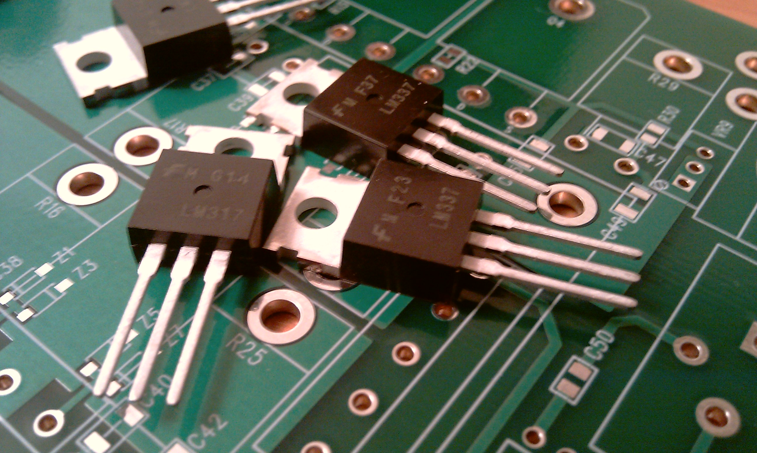

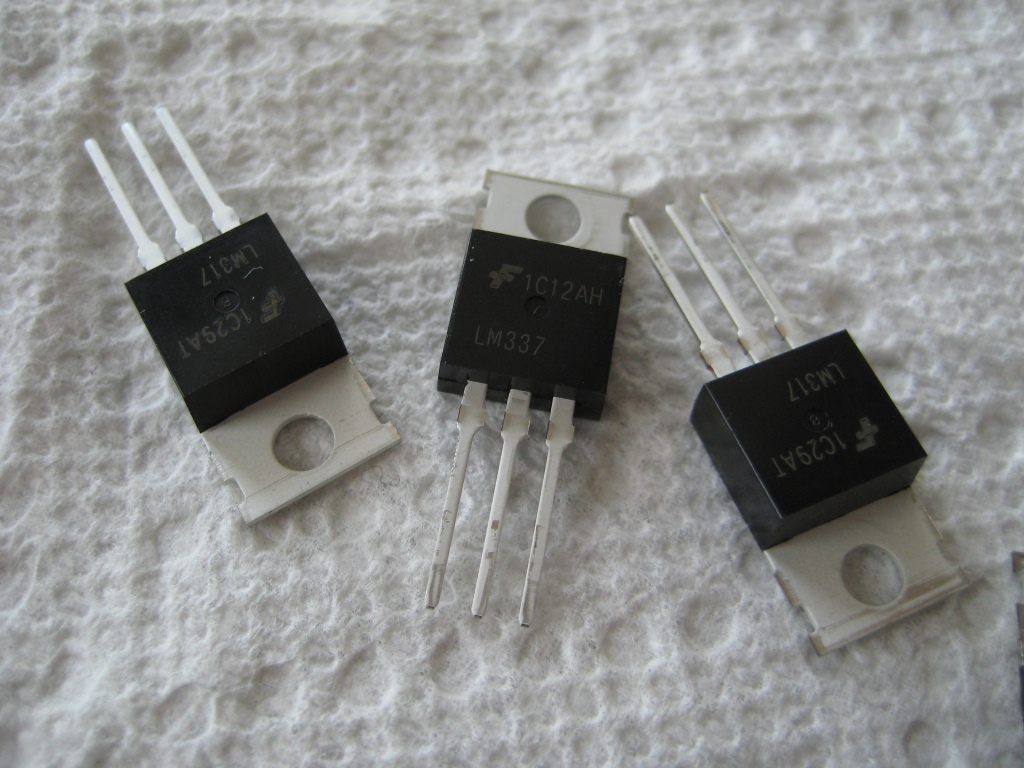

- What 317/337 brand / type are you using? - pictures attached.
I tried to cope with the problem with reversed schottky diodes at the regulator outputs. Did not solve the latch-up completely.

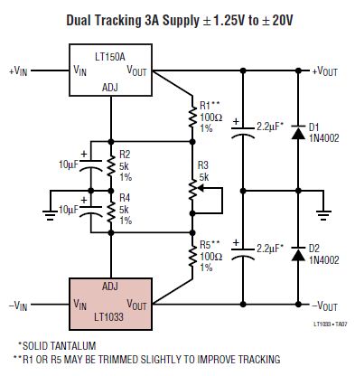

Tried to use tracking (see sch.), but decided I'd better not, because of cross noise/hum issues.
Solved the problem with thermistors at secondary side of the transformer windings. Before rectifier diodes.
It's funny that the only guys having problems are from Bulgaria, those evil bastards :) The only thing that I can think of is that the LMs are fakes and that caused the problems, everything else was bought from digikey, I am not sure where the LMs were sourced from... Anyway, it's been working for almost a year without a problem and sounds wonderful, that is why I've never mentioned it, it was clear that it had to be taken care of in one way or the other.
My LMs look nothing like yours, as mentioned previously they are marked OnSemi. Last night hooked a variac and reduced the incoming mains voltage by about 10% - all latch-up problems seem to have gone away.

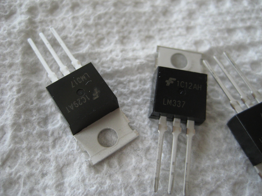

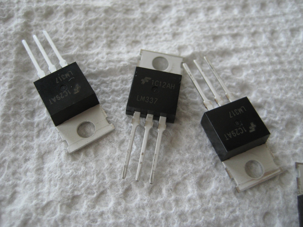

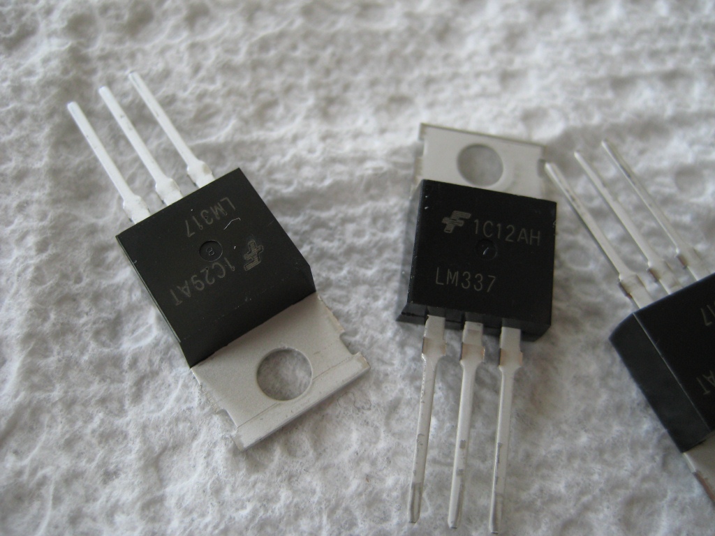

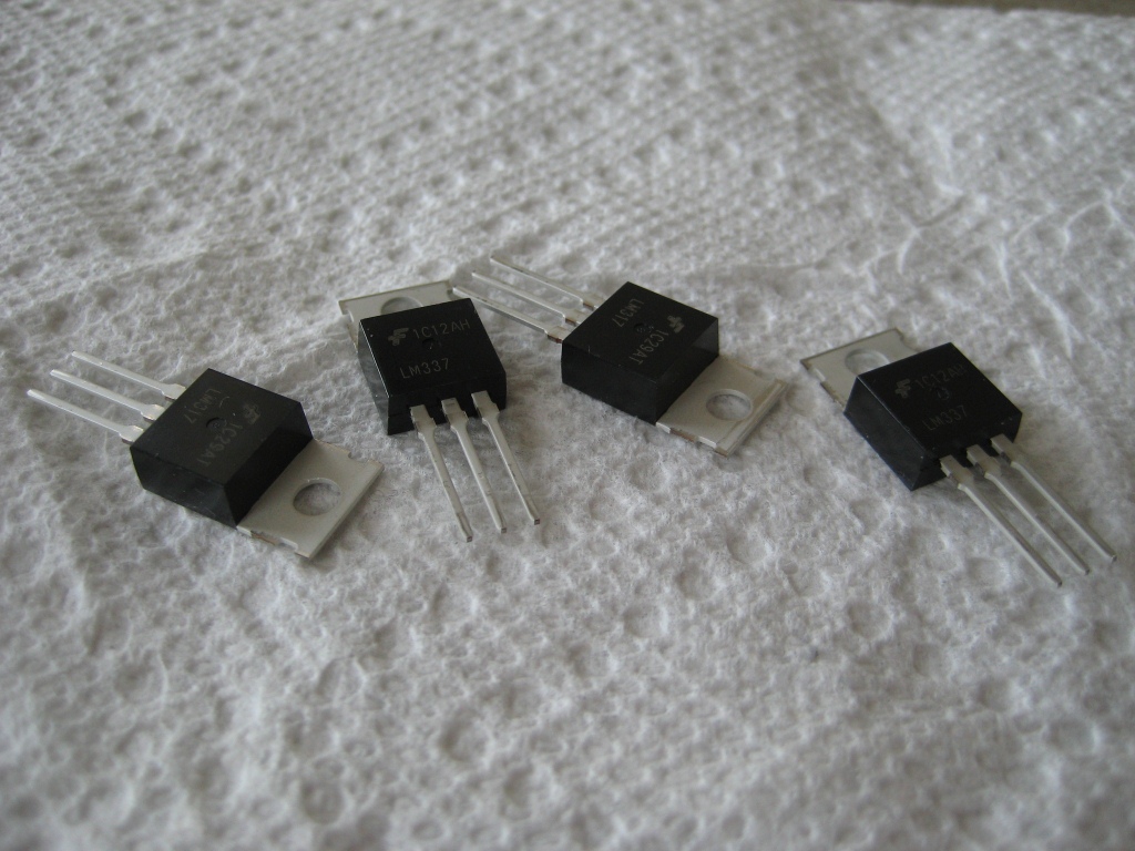

I attached pictures from a known good batch of Fairchild parts which should match the pictures taken by Nikola. There are a handful of suspicious differences, but if he bought his 10 years ago and they were diffused in different places, then it could just be changes in production. I have attached pictures for reference.
Anyhow... Perhaps Nikola can confirm what size toroid he is using so we can send out a general warning to everyone to avoid high VA toroids, or adjust the circuit accordingly.
