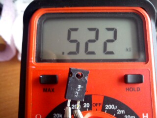

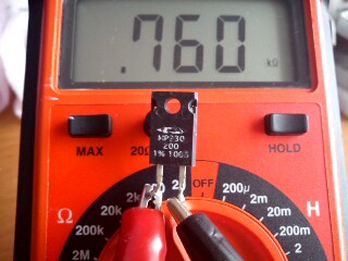

More measurements:
R13 199R
R29 553R
R12 812R
R30 100R
Values are with resistors soldered at pcb & I/V not powered.
Right resistors numbers & measured values:
R13 199R
R29 553R
R14 812R
R30 199R
Seems R14 & R29 are wrong value, have I to change? Have I to measure also R16, R17, R25 & R26?

Measuring resistors in circuit can be a little tricky and could be giving you strange results when nothing is actually wrong. It's exceedingly rare that a resistor would fail and change resistance to a value near the original one. they usually either fail open, or go to relatively high resistance.
If possible, disconnect the power supplies and try measuring again, this time from the drain of Q2 to the drain of Q4 and from the drain of Q1 to the drain of Q3. You should get 400 ohms.
Next measure from source to source as above, and you should get 800 ohms. Measuring R30, R12, R11 and R27 in circuit will be impossible and will give you incorrect values. One trick you can try is to measure each resistor with the leads one way and then the other (swap which side of the resistor the red lead is on). If you get different values depending on the direction, then you're not actually able to measure that value in circuit, and the part will need to be removed for measurement.
Can you verify that you've removed the DAC from the I/V? You can't set things up with the DAC in place and turned off. You need to start with the DAC removed, adjust everything to the correct voltage, then shut everything down, mount the DAC and power everything up together including the DAC. Once it's up to temp, adjust it again with the DAC powered up and you should be good to go. Having the DAC mounted and not powered will result in odd behavior.
Like I said before, having the drains shorted together (by not using the mica insulators) should not have damaged the mosfets, and at worse, would have dissipated about 5W through the two 200R resistors, which should have been fine if they were properly mounted. I really doubt you damaged anything unless there's something else wrong that we're missing.
Owen

See pics, now I start to change the resistors to see what's measure before power on the I/V

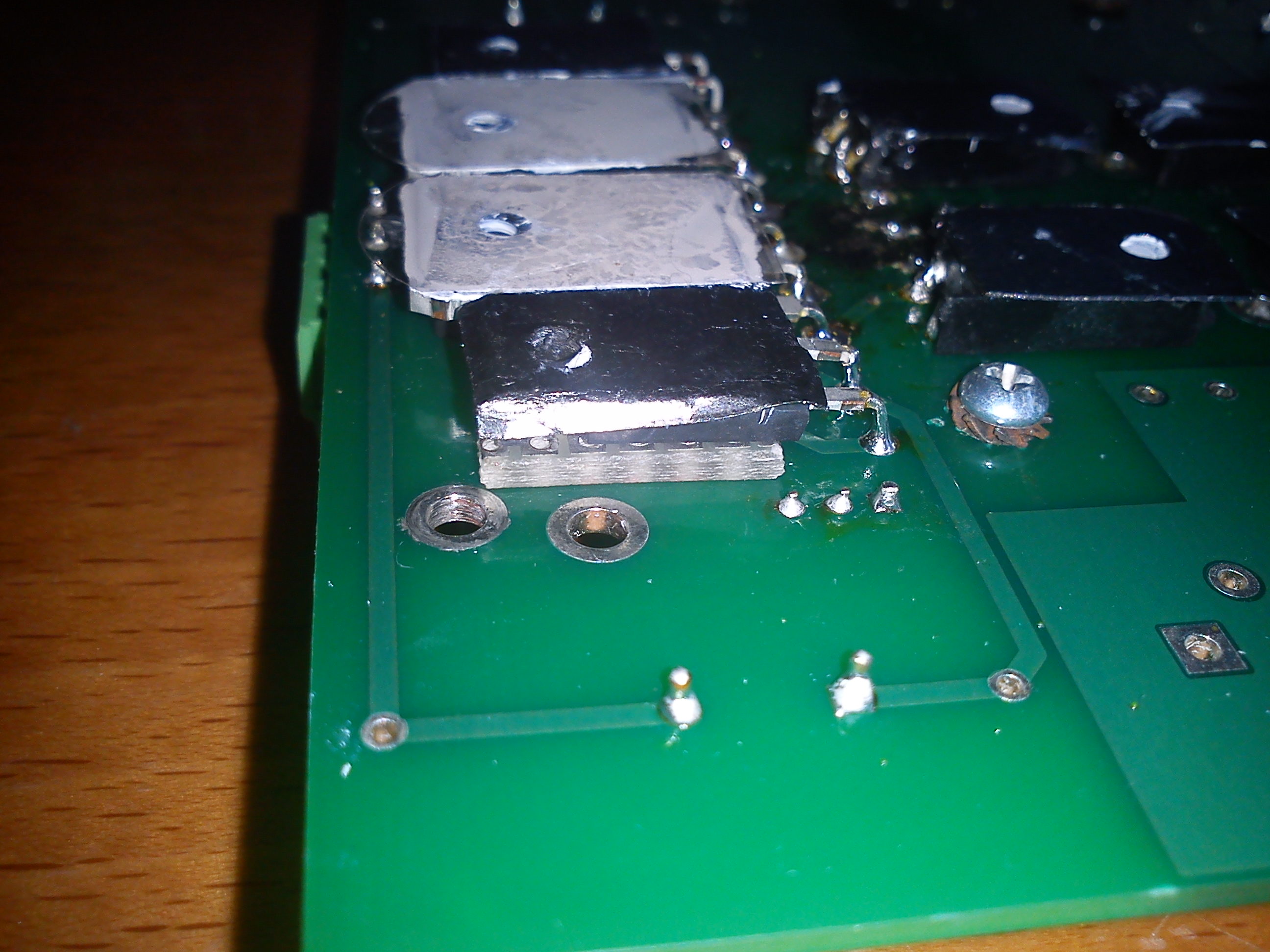

Good to hear! Make sure you take your time putting it all back together, and make sure all the parts on the bottom are making good contact with the heatsink, including the resistors!
You'll need to use a piece of FR-4 PCB material to shim the resistors to the correct height (make them as tall as the mosfets) and make sure there is sufficient mounting pressure on all parts so they make good thermal contact with the heatsink. If those two resistors were properly mounted, they should not have failed like that.
Owen
yeah i'm thinking the resistors werent in good contact as well and the added power dissipation through them blew them, but in a strange half-assed way. myself i would actually desolder them and wick out the solder; mount them to the pcb with the screw through them directly to make sure they all have good even contact. I used arctic silver on the resistors mounted directly to the pcb without a washer, as there is no electrical connection even on the zfoil metal tab.
there is enough space for a screw between them and the pcb, so i actually mounted everything with low profile hex screws to the sink first and then added the pcb over the top. It was a pita wiggling it to get all in the right place, but it assured good thermal contact. You'll have to then carefully do one turn at a time on each screw on each device if you ever want to remove it from the sink so you dont stress the legs, but if you do it right you shouldnt ever have to do it.
now of course if that sounds like too much trouble, do it with the fr4 to keep at the same level, but do not rely on eye to get that right, a fraction of a mm could make the difference between good contact and none at all. a tip if you do it my way, add a tiny dab of solder in the right angle bend of each resistor leg to add strength.
the above goes especially for the guys who got zfoil resistors from me, because the legs are pretty thin pure copper and if you have made a sharp bend in them, they are a bit weakened and wont like being wiggled around too much, take it from me i busted one, luckily i bought 2 spares.
so take from that, dont use sharp edge needle nose pliers and make a really sharp bend in the leads of TX220Z, make it a bit rounded by using round needle nose pliers, or by just gripping it a bit loosely.
anyway looks like we are getting somewhere, glad things are getting back on track for you Felipe, if nothing else, think of yourself and your experience in a positive light, this is good info for the build thread all because of you :cheers:
Felipe, i still think you didnt get proper contact first time for it to fail in that way and only one side, regardless of your torc wrench, if one device was soldered at a slightly different level it will stop the others from getting good contact, but you will still have good tension on the wrench which makes you think it does. you might try even reflowing the solder on each one as you tighten the wrench if thats possible with only 2 hands. i prefer soldering them after its mounted for that reason
do watch you dont strip the threads in the heatsink though by using too much pressure
