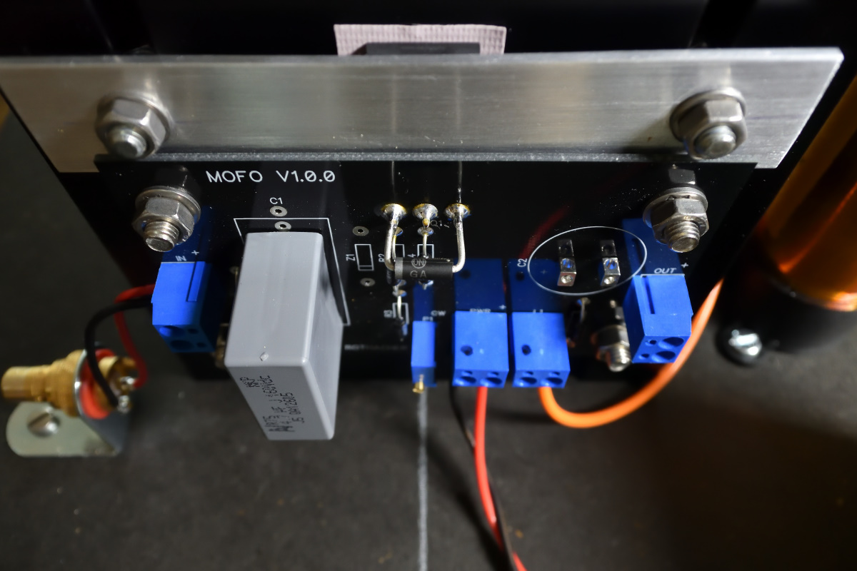

Now I hope I am better protected than before…...after installing a GA 1N5357 zener. Hopefully I have installed it correct……
Soon I am ready to power up the MoFo…...

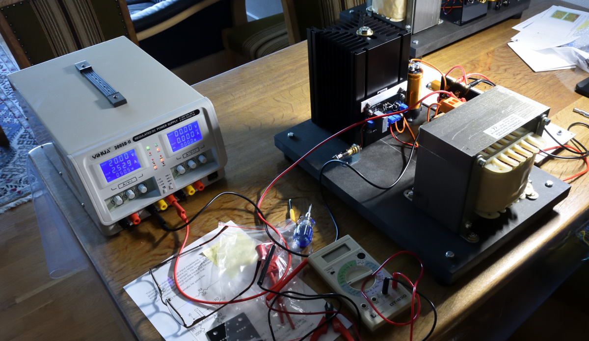

I have started the bias adjustment on my MoFo with the big choke (70 mOhm RDC). Bias seems to be stable after about 1 hour or so. Heatsink reach 46 C with ambient at 23 C.
Now I let it run a hour more or so to check bias stability. After that I will test with a generator to test amp.
My setup may be a little more temperature sensitive than with the original choke.
It is my plan to go to 3A bias. Heatsink should be able to handle that.

MEPER: Looks like you should have no problem at all with 3A bias on a 20v supply. Your sink is similar in configuration to mine, but a bit taller. I'm seeing max thermal rise of about 27-28c with 19.5v at 2.5A. I haven't yet made a "final" assembly as I am in the middle of experimenting with different thermal interfaces and raw aluminum vs painted surfaces to see what practical thermal differences arise. I might have some data to share in another few days.

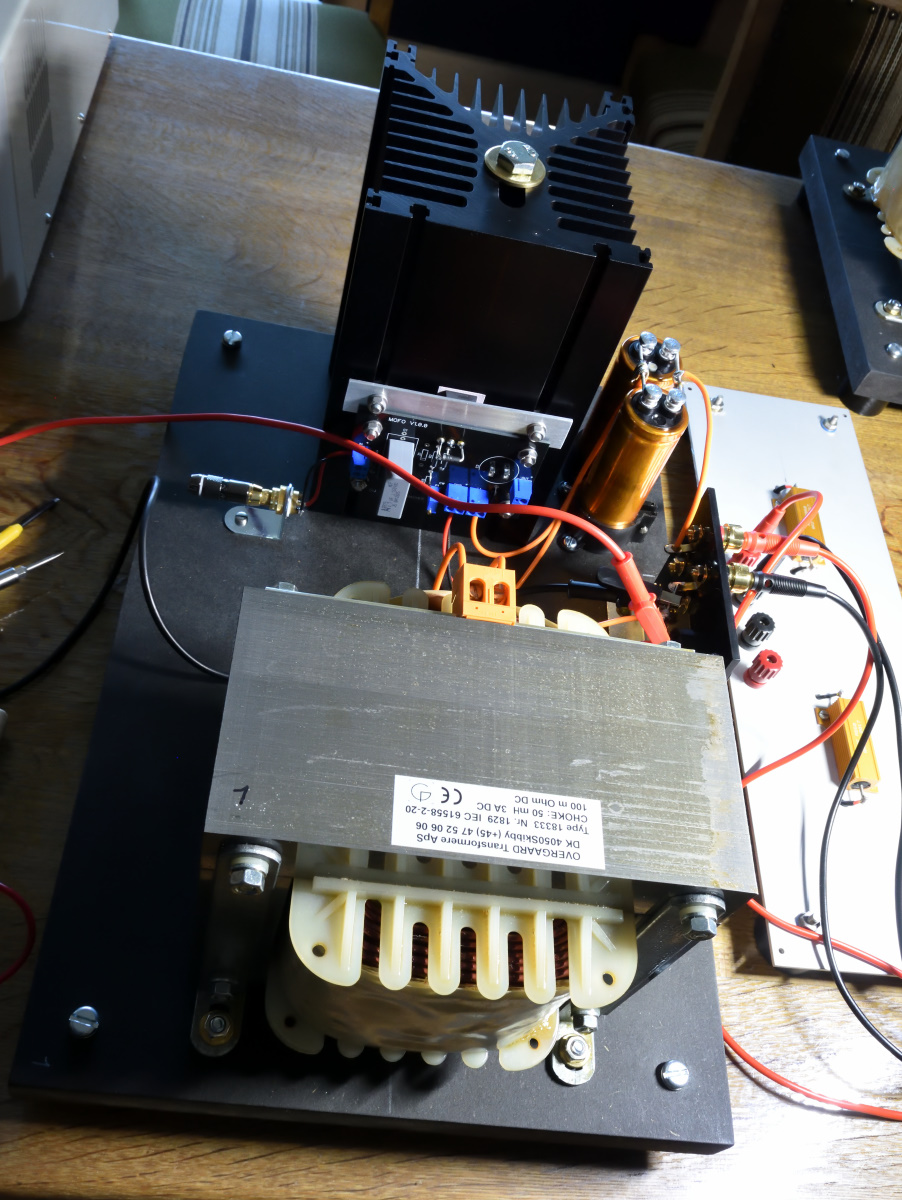

Yes, about 20 kg choke. 12.5 mm2 flat square copper wire used (it should be able to handle 28A). I also installed 2 x 6800 uF big external Jensen audio grade capacitors as output caps.
I tried a switch off and on......and no damage.
When I have tested a bit I will provide some better images.....if it works as expected. To get full voltage swing I need to build the BA-3 pre. Will be next project.
