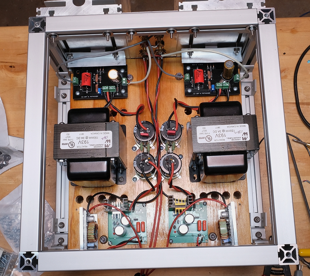

Finished the wiring this evening, still waiting on some larger 3mm plywood for the top.
Had to try it. Using a BA-3 preamp at the moment.
Clarity, articulate, imaging are some of the words to describe the sound.
Really nice amp, Michael.
Thank you for making it available to the rest of us, that have no design skills!!

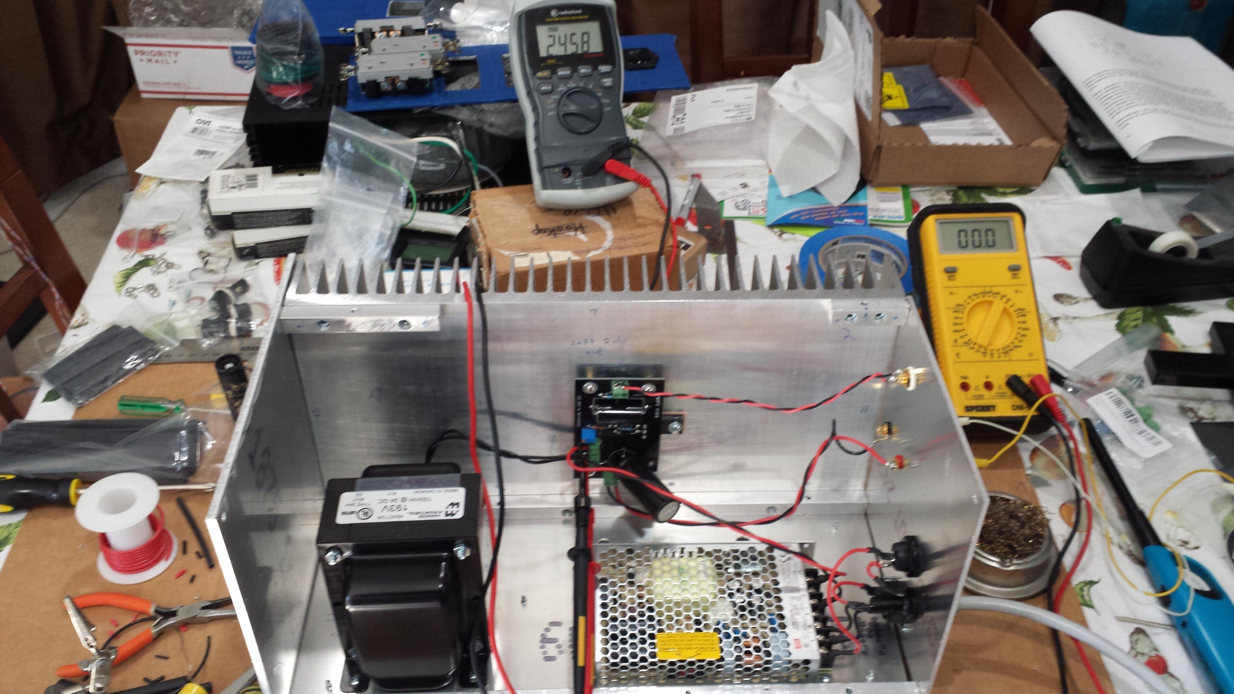

I tried 3 preamps just for fun. None are good for the MoFo, but it doesn't hurt to try.
BOZ-J: Surprising amount of gain, but still not appropriate for MoFo.
Parasound PHP 750II: Not good at all. Sounded thin.
BA3-Pre: A little more gain than BOZ-J (13 to 15db, not sure where I set it.) Better sound over all.
Have a B&K preamp left to try. Also have boards for another BA3-Pre; this time leaving it with original gain.
I will say this, there is an honesty about how the MoFo sounds, even at low gain levels.
I can't comment much about noise, except for there is no noise without music playing. I don't think the Mean Well SMPS is adding any noise.
This could change with higher efficiency loudspeakers. Don't know if noise will change with higher gain preamps, but I guess it shouldn't, if the preamp is designed and built correctly.
FYI- Heat sinks are 15.75"x8"x3". Heat sinks barely get warm. The edges of the heat sink are room temp.
If you are not building your own case, like I did, this project should be quick and fun with very good results.
Boards took under 20 minutes for part soldering.
