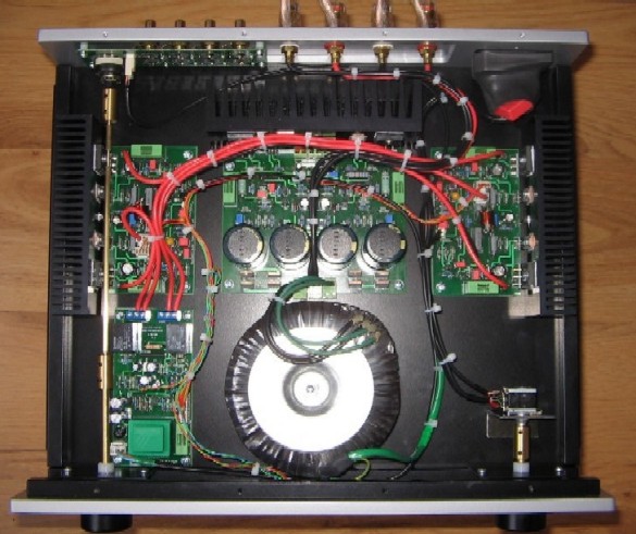

Hi Beardini, I have follow your circuit and made the power amp stage successfully. But, I have change the O/P stage to fully complementary.
I have employed ON Semiconductor matched pairs MJL1302 / MJL3281 and drivers MJE15032 / MJE15033. (Thanks for the sample support from ON-Semi http://www.onsemi.com/PowerSolutions/product.do?id=MJL1302A)
Thank you very much for your circuit diagram indeed.

Quasicomplementary amps in the year 2005....how funny ... Let's go, guys...to the blind ways....
All of my amp designs are quasi-complementary. Even in the year 2006 no one has discovered the positron and therefore made electricity symmetrical. Nor can ON-Semi perform this miracle. This is a serious point. Just because a circuit looks symmetrical on paper doesn't mean diddly squat to an electron.
A few words of warning for those who like the Naim sound and are interested in cloning a NAP250. Great challenge: go for it. BUT...I have intimate understanding of this design and it is extremely complicated. The schematic only tell half the story at best, and nowhere on any website have I ever seen an accurate schematic. Julian Vereker was a very cunning and sly fox, the devil is most definitely in the detail. This high feedback design will sound average to poor unless ALL the fine tuning is done right. And none of the Naim clone sites explain this...because they don't know.
Not saying you can't make one and get pleasure from it, just saying it is a really hard topology to get right and the odds of making one that sounds as good as Naim's is very low. So don't get your hopes up too high.
It is a good idea to use regulated supplies by the way because the PSRR of the basic circuit is not very good. When you do this you need to ensure that the regulator is wide-band and does not introduce any resonances. The NAP 250 supplies use the same high speed transistors as the amps. You cannot buy these transistors in the shop.
I can only confirm that point in all parts. You may succeed - like I did - to some stage and level, but only with a lot of experience and knowledge. And - I have said that in this forum since years - I have not heard a NAIM clone which was better than the orginals, never. Alas not even mine.
