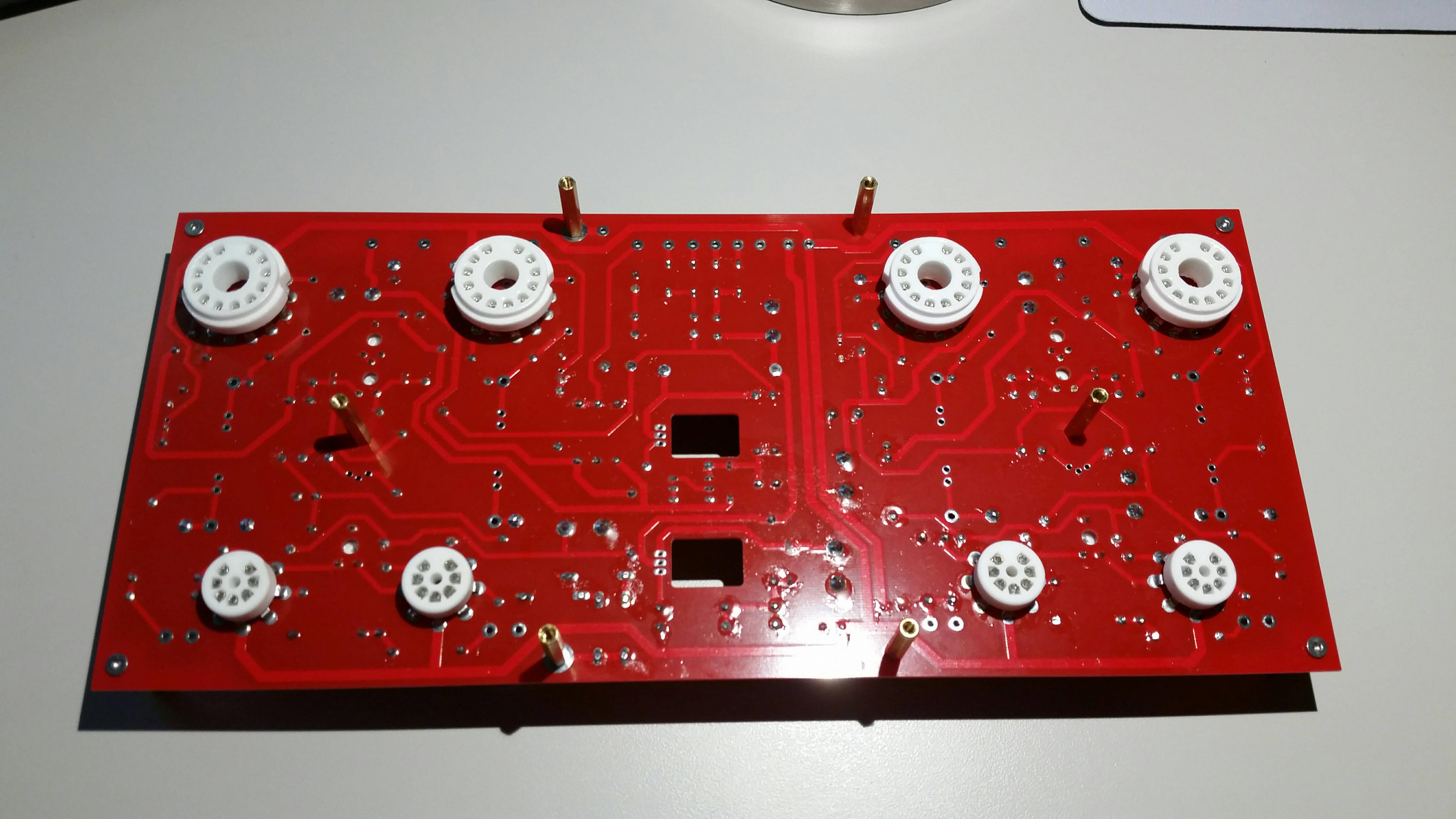

I'm thinking about trying these Mundorf caps. Worst case scenario, I can reuse them in another amp. I just don't know how they will fit. They are not over priced either.
Anyone know the length or can measure it for me from solder point to solder point? Is it more than 38mm? I'm at work and would like to order them now, I don't have the circuit board with me.

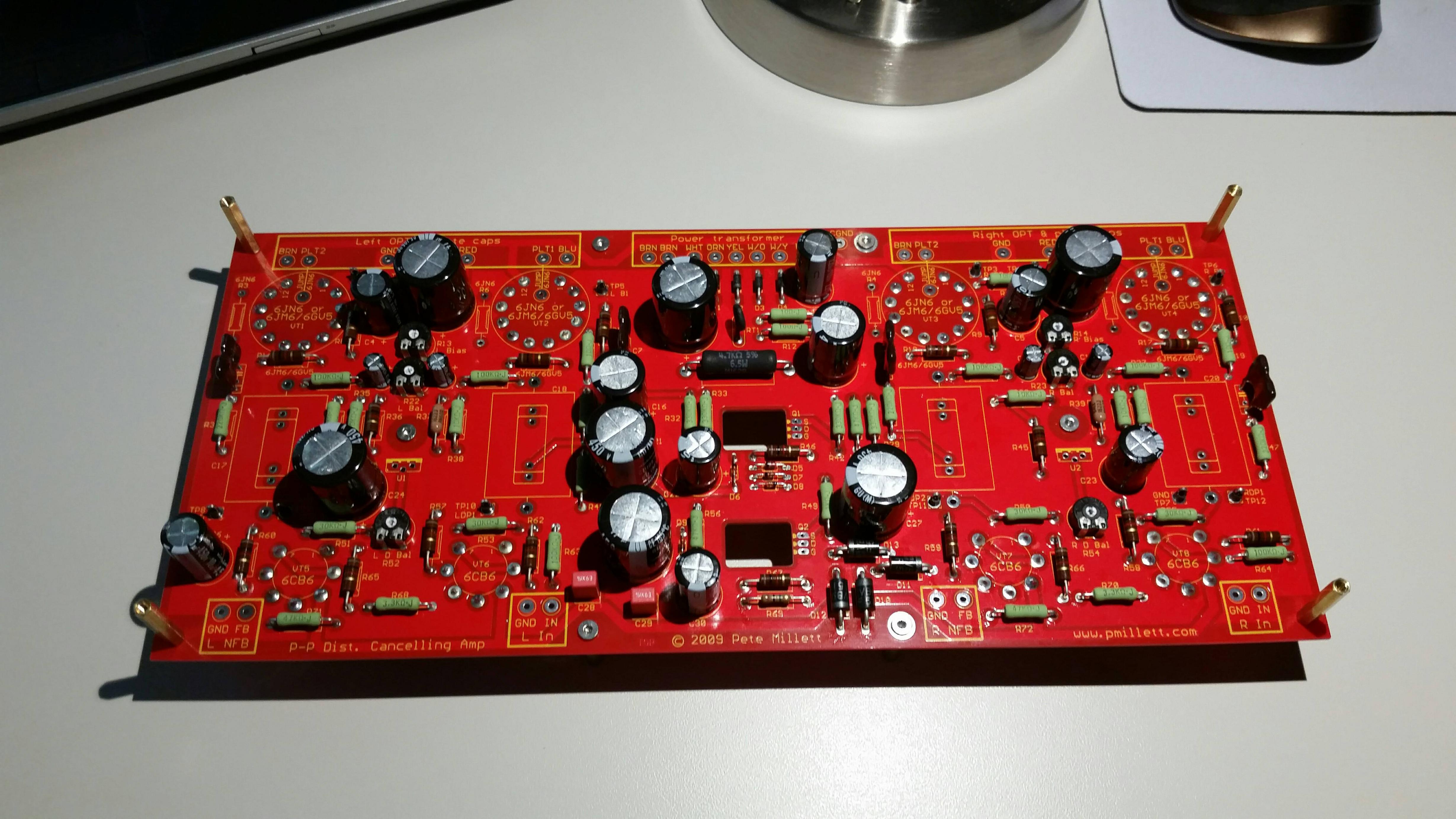

Got it just about done. Need to install the CC's and one or two other components that I won't install till the chassis is figured out.

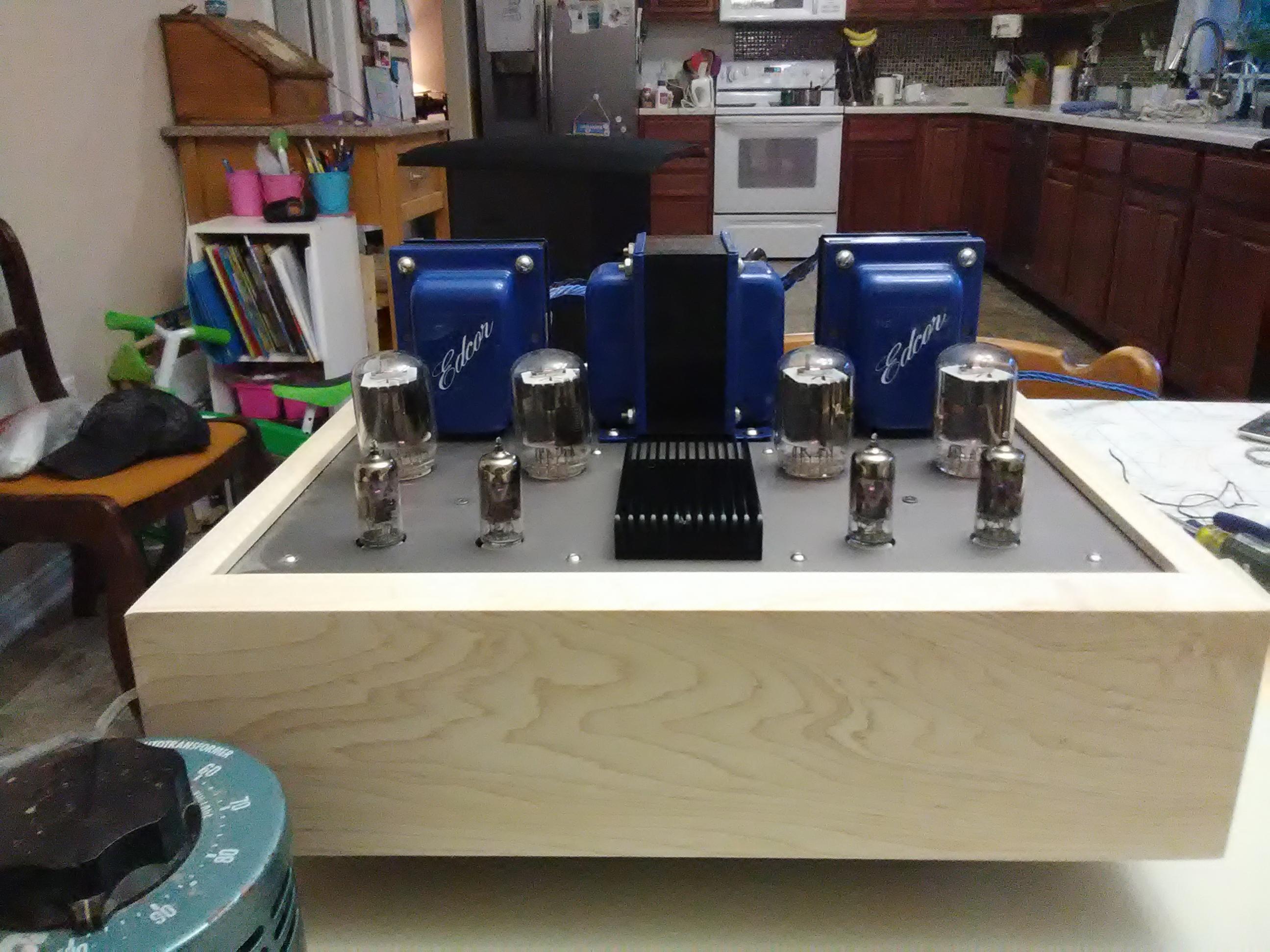

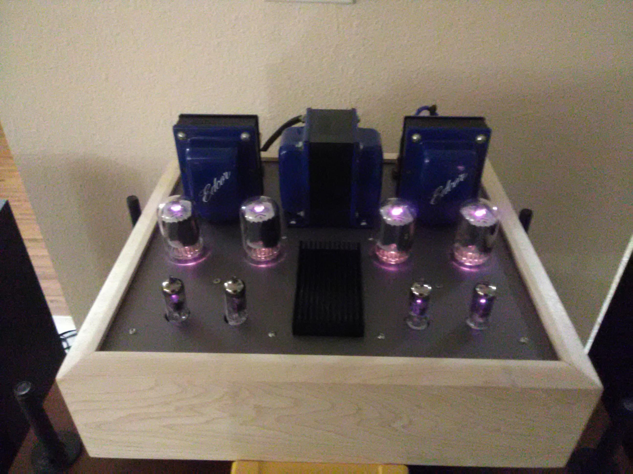

Here's my first attempt at Pete's DCPP amp design, I just need to put the finishing touches on it and put it in a case once I have tested it. It will be put in a Hard Maple DIY case I am building. I am making two of these, one for myself and one for a fellow vinyl junkie that has never experienced tube amp sound.

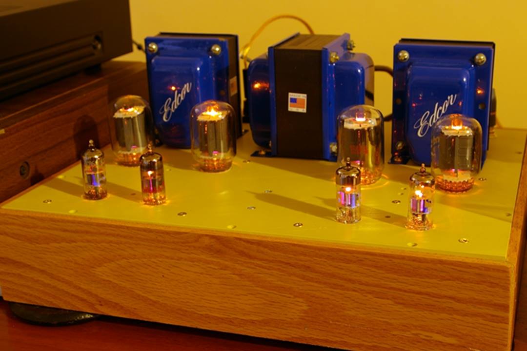

I used Front Panel Express for my top plate. It is excellent quality. I had a friend powder coat mine. It is not the cheapest but knowing that it would be done according to Pete Millett's specs was worth it to me. It is also thick enough to dissipate heat fairly well from the mosfets. I have a heatsink I plan to put on at some point but that thick top plate does a good job of dissipation on its own. It gets warm but not hot. The one thing I will point out is the holes for the driver tubes(6CB6) are just large enough for the pin base of the tube to fit through. I soldered the sockets on the board so they would be more or less flush with the top plate. My enclosure is just 4" 3/4 red oak flooring I had left over from a flooring project. I plan to make another enclosure from black walnut and add an ALPS volume control.

My amp is in a standard Hammond chassis with the accompanying baseplate, drilled by hand and with Greenlee socket punches.
I was just looking at the Hammond chassis, it looks really good. I really want to do something custom since I have the tools and carpentry skills but this might be a great way to finish this project sooner than later. The chassis they provide really hit on all keys!
Thanks for this, I wasn't aware that Hammond made such a chassis.

I used FPE for my panel and used Pete's PDF drawing to lay out where the board would reside. I used different transformers and moved/removed/add other bits; for everything but the board, I pulled out a ruler and did about a dozen test layouts. I think my panel was around $180 but I don't recall for certain. I think I went for 4mm and used the anodized/chromated option.
I have plenty of gain, so I added a stereo pot before the 6CB6 grid leak resistor and that was it.
