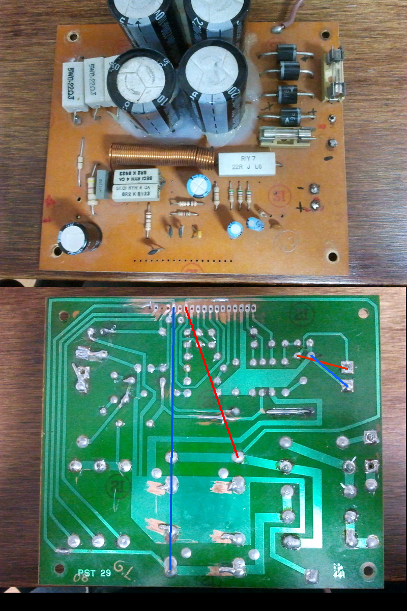

This is the PCB, top and bottom. Actually the Laney is completely de-assembled.

I finished to write down the schematic, it's a first scheme, I will try to correct it and make it more linear.

1) join the multimeter tips, I'd be very surprised if it shows "0".
It will probably show something around 1 ohm, the wire/connectors/etc. internal resistance.
Substract it from your 4.1 ohms reading and you'll have the actual Voice Coil speaker resistance.
Anyway it's already pointing to a 4 ohms speaker, not an 8 ohms one by any means.
The speaker is a cheap generic Eminence, not bad for guitar; vor voice use you'll need some tweeter, a Piezo is easy, cheap, and fine in this use.
2) that PCB is crap, not worth repairing.
Terrible design. Long thin high current tracks, not surprising they overheat and die under high power demands.
Get any Power amp which is happy with your transformer.
Post a picture and lamination height/width/stacking. "Very large" is not useful data.
Draw a transformer diagram showing colours and where you measure what.
50VAC+50VAC secondaries are way too much for a 60 to 100W amp.

Maybe.1) do you think I need to change cone? In the back his nominal impedance is 8ohm, with the subtraction you told me I have less than 4ohm. Is the cone gone?
Or maybe it was reconed.
I think your fake Laney was made by somebody with different scraps and parts he had around.
To begin with, I very much doubt British (or Chinese) Laney uses an American Eminence speaker, so .....
Try the speaker with another amplifier, even aTV or a radio or something.
If it works ... it worke.
But in that case it's 4 ohms .
Well, that's no Laney PCB for sure but something bought at a shop for peanuts or pulled from another amplifier.2) PCB, do you think I have to re-project a new one? If I put a layer of tin on top of each track, so they become thicker, can be a solution?
In a few I will post some other detail about the transformer
It's not homemade because it has soldermask.
Which complicates things a lot to add tin.
It's much better to add flying wires from end to and.
I show you an example with the +/- rails and the speaker out, but you must detect other high current carrying long thin tracks and do the same.
But I think the best is to buy a new 100W PCB (or a kit and build it) and power it from the "Laney", not using the STK.
The Power supply section is good.

I tried to improve the pcb, with some extra wires, scraping off the green thing over the tracks and tinning all of them (or where it seems to be too small track).
Here is the result:
PCB
Here is the result:
PCB

The resistors at pins 13,16,17,18 are 0,22 ohms. I don't know if the one in my pcb, connected to pin 13 is correct. is a 22R J L6, RIY7.
Any comment?

I tried to measure the resistor, but seems to be broken. No values are shown in the display. Mumble, what can be happened?
