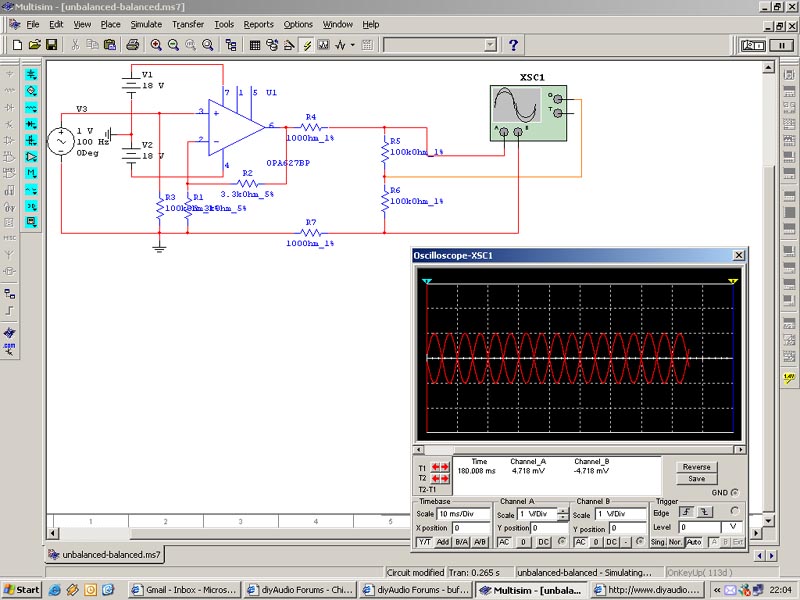

udip said:BTW, Alcaid, you forgot connecting the two 100k res to ground
When I did that it didn't work. Got no signal from the "cold" line and a 2v signal from the "hot" line. When not grounding it I got a 1V signal from both "hot" and "cold" 180 degree out of phase.
