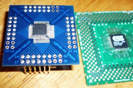

Here's my Sabre ES9018 Tweakers Board
Total Cost $70 - ES9018 $60 & Prototype Board $10
I used a SchmartBoard which has solder grooves into which the pins of the 64 QFP ES9018 sit making soldering by hand easy.
There is a ground plane on the bottom of the board & I will be running this on batteries so each Sabre analog & digital supply from a separate battery (4 batteries - DVCC_T; DVCC_B; AVCC_L; AVCC_R) & each 1.2V from an eneloop battery (3 batteries) - no regulators, just caps.
Edit: I had a bit of a moment with this ESS chip - I dropped it when opening the box I received it in & it must have fallen on it's corner because the pins on it's corner were bent out of line. This would have been impossible to solder without the SchmartBoard!

A pic of a different prototype board again with an LQFP64 chip (TAS1020B) same package as the Sabre. This board does not have grooves for the pins to fit into but is just a standard board & was soldered by hand. So the Sabre could also be soldered to one of these (I didn't do this soldering, a fellow inmate did)
It's not difficult to solder a chip to a protoboard.
It will work, but not at all well, because there is no good way to mount the caps close enough to the pins to be effective at 20-80mhz.
Also the way those traces are fanned out is going to be very bad for both the digital and analog signals.
If it were this simple one would not bother designing a PCB.

Just curious, what does this have to do with the Buffalo in the least? Not any old thing with an ESS chip soldered on it qualifies.
Don't take this the wrong way, I hope you have great time with your project.

Russ, you could be right, then again you could be wrong - at least I have an open mind about it & it hasn't cost me $569 to find out!!
You are very quick to point out why it wont work but I have some tricks up my sleeve. Don't take this the wrong way but I started this thread & I consider this post to be a relevant departure - perhaps I'll start another thread!

Ah, an open mind. Excellent, then I trust this is sinking in.
Indeed, wrong I have been many times, but I am quite certain of the facts involved here. There is no working around the laws of physics regardless your skillful trickery up your vestments. It is my willingness to accept being wrong and learning from it that has taught me the most.
Prototype boards are designed for - this is profound - prototypes. Prototypes are good for investigating new chips or trying out ideas. If that's you aim, your spot on. If you want quality, your barking up the wrong tree.

No prickliness evident in Russ' reply - he's just telling you some straight facts - for example about decoupling - which you probably are loathe to hear. Given those long traces to the DAC on your protoboard, why would you bother with battery supplies at all, since all the parasitic inductance will create plenty of undesirable PSU noise?
Neither Russ nor I would wish to stop you from making your own mistakes, so please do go ahead and report back...
