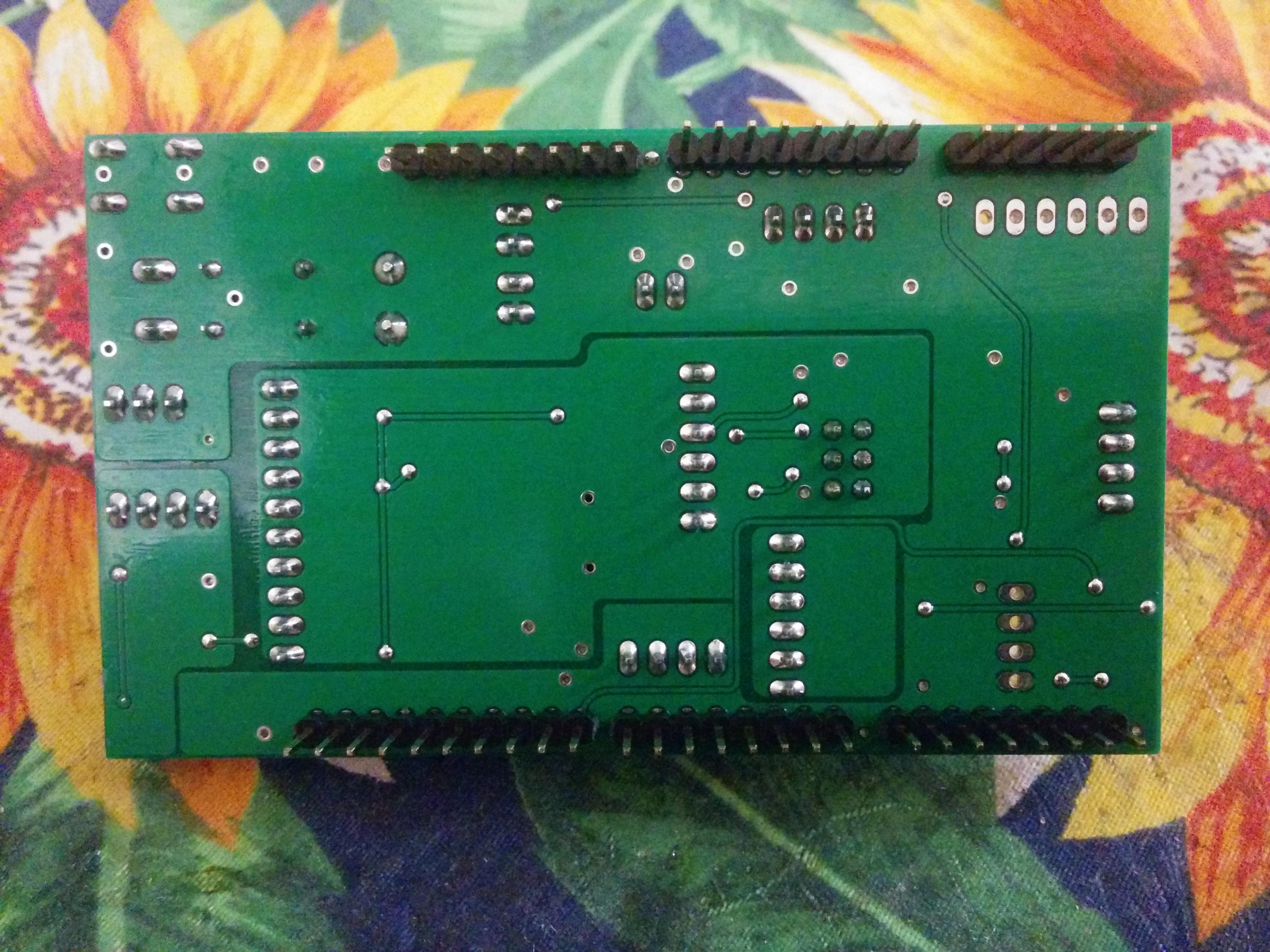

I already read Dim's blog but didn't find the information. I download the manual for the 4.3' TFT from Saint Smart. I just wanna be sure my tft wiring is correct. I already program the Arduino DUE.

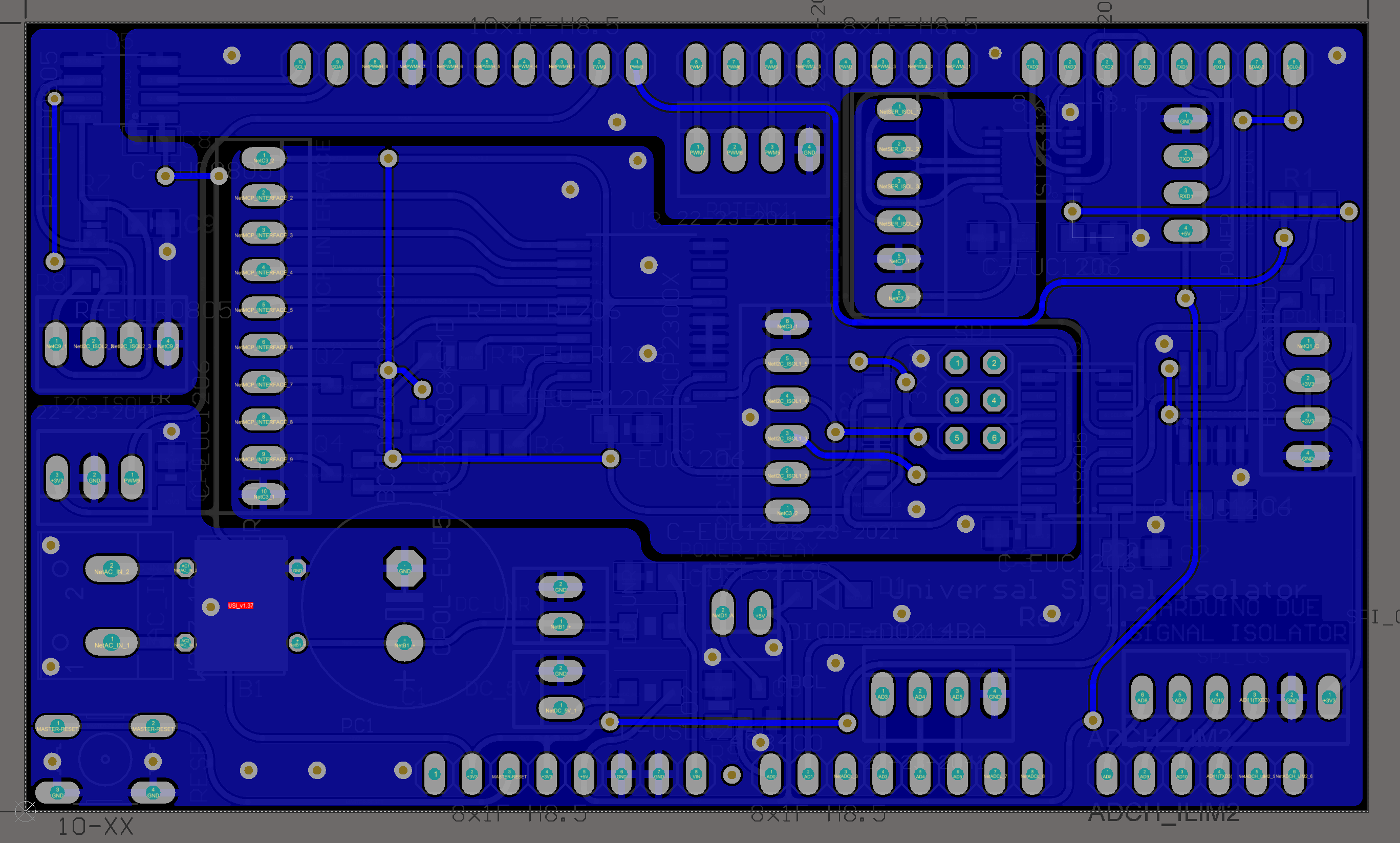

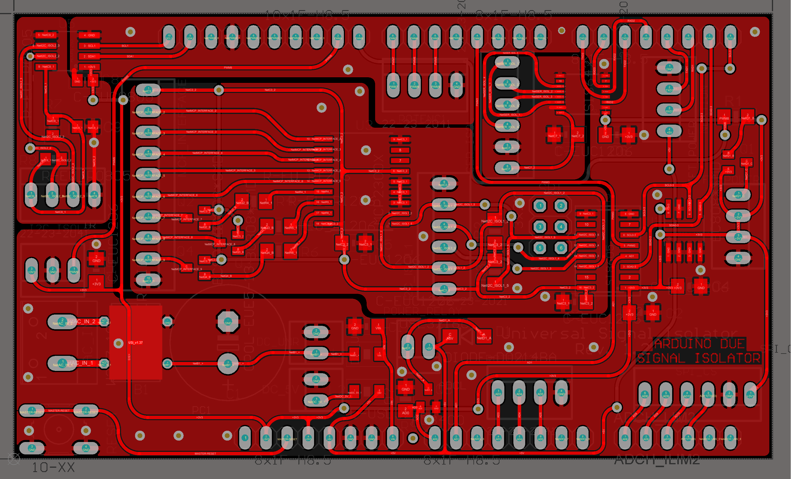

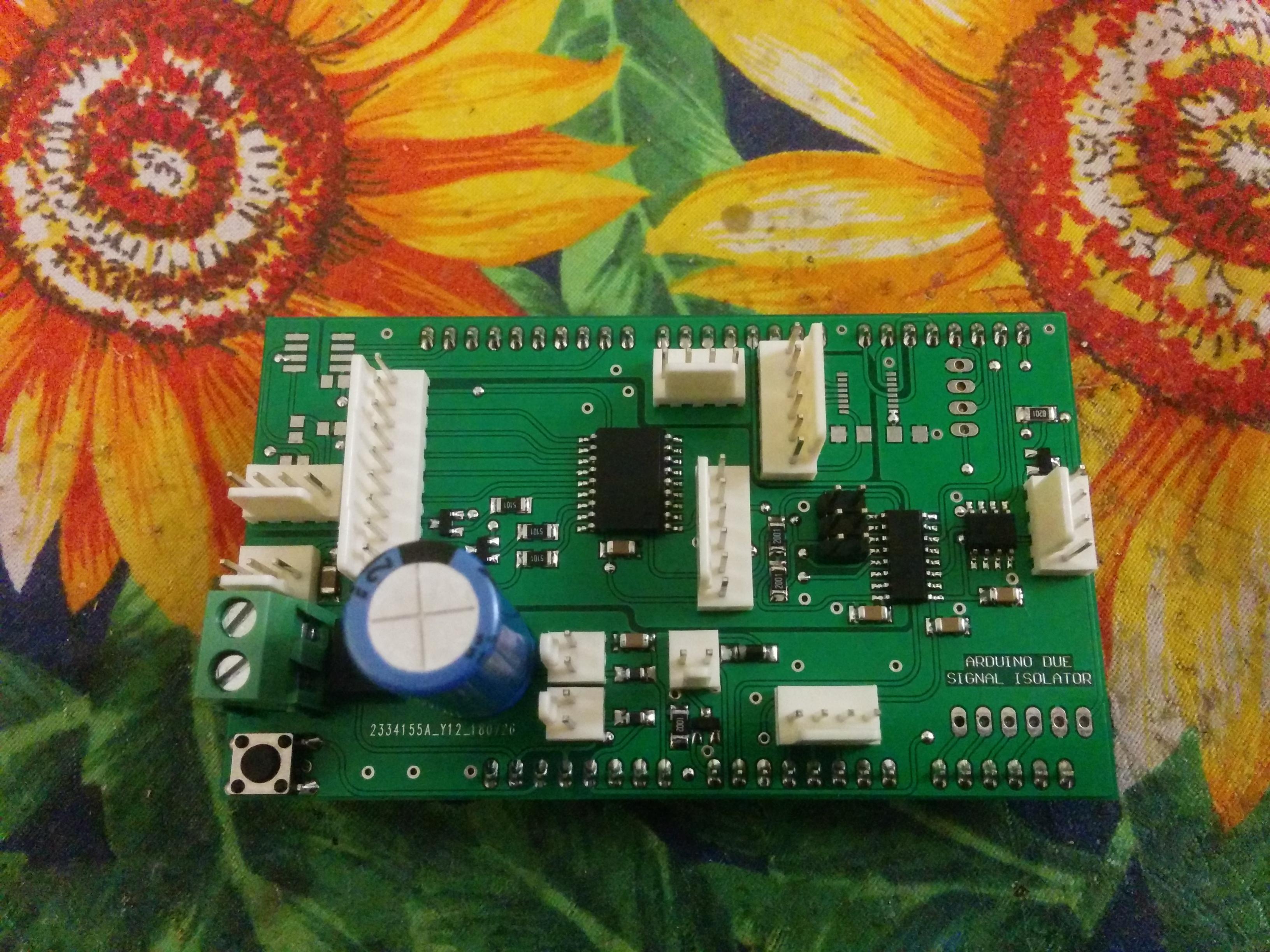

I use Dim Eagle project for the shield and import it in Altium. Here is some pics and finished pcb!

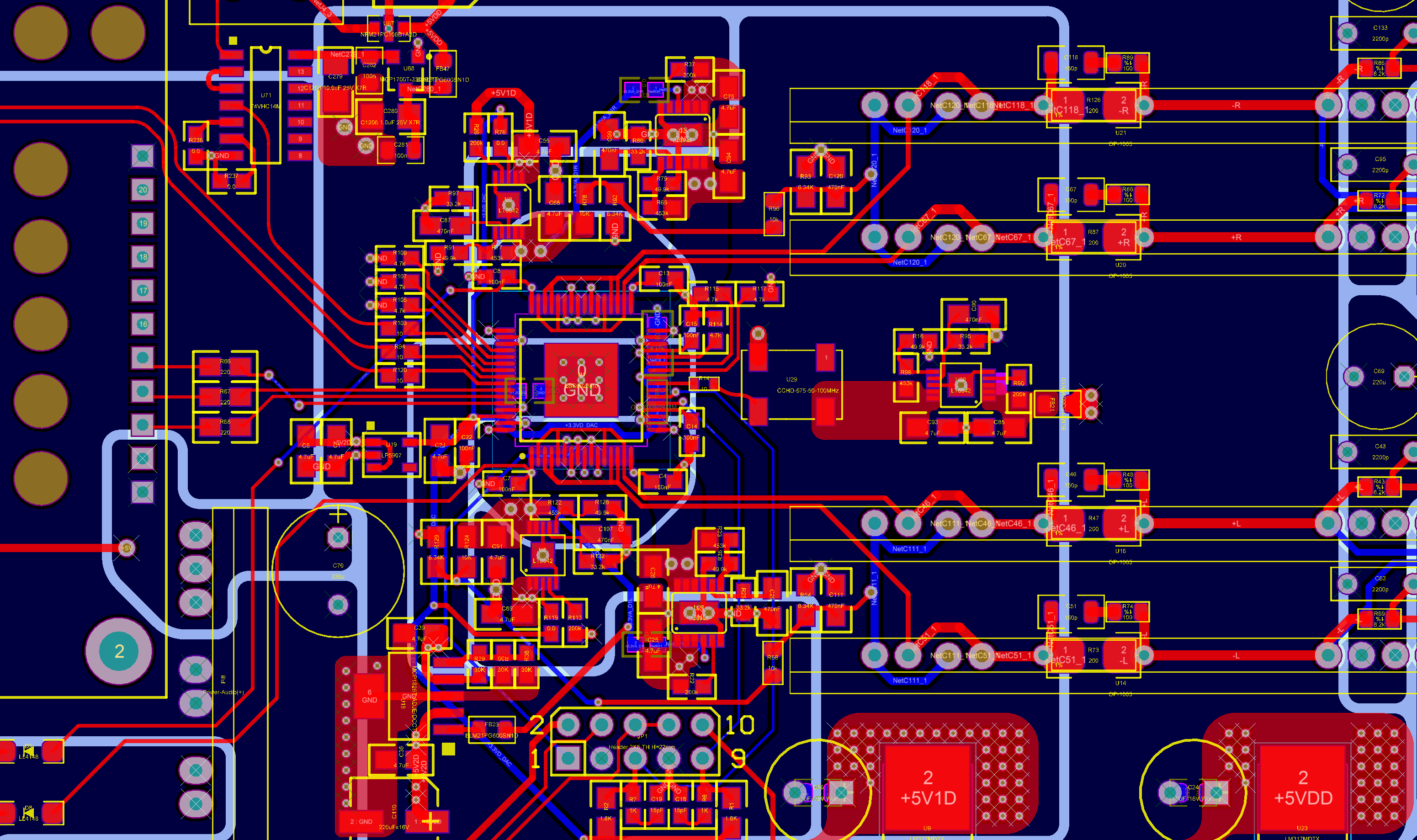

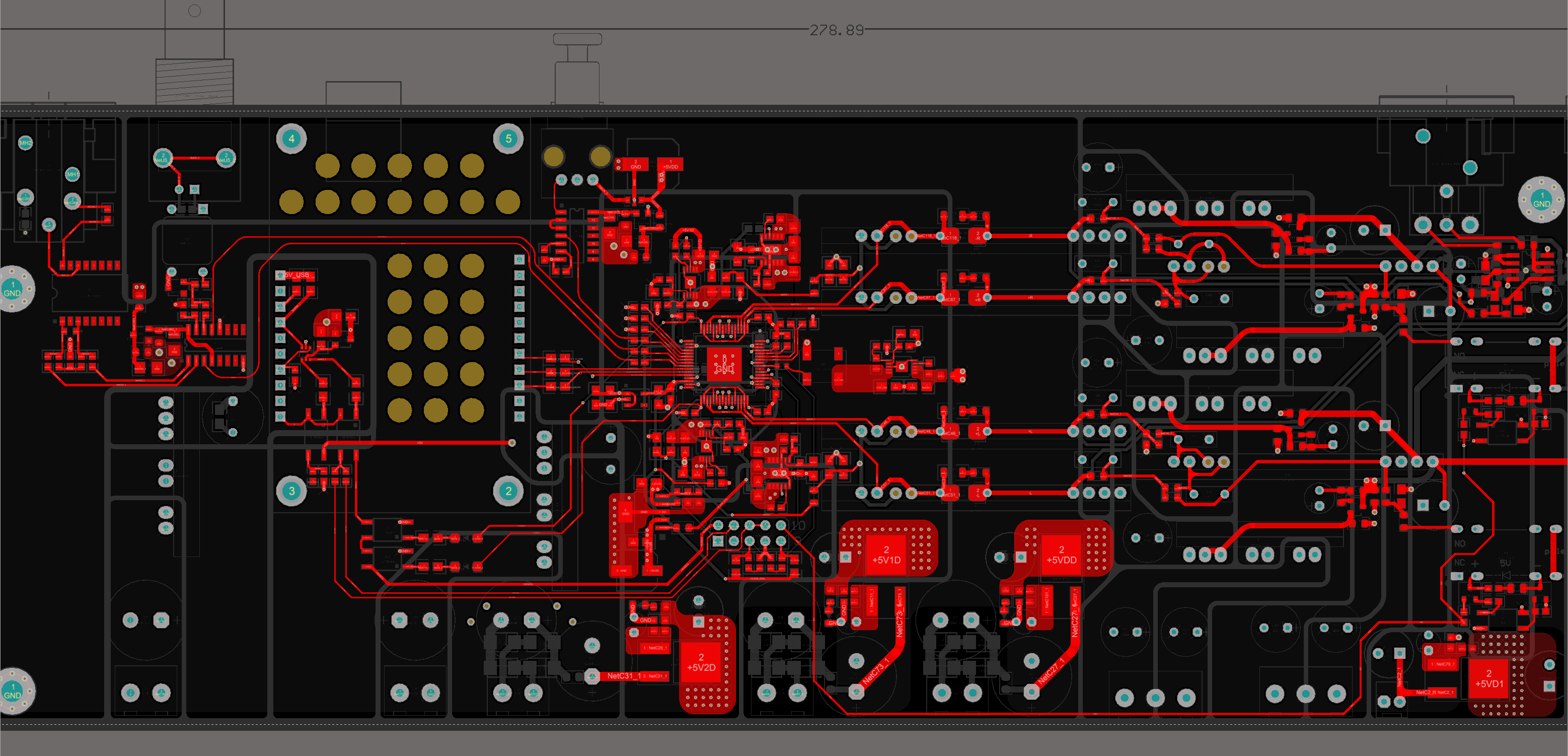

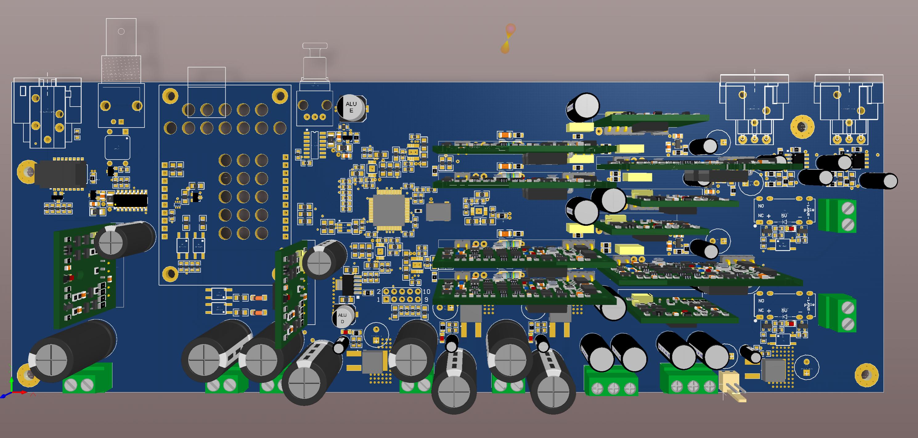

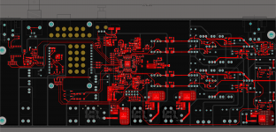

I made my own ES9028pro design, and order the PCB. I use LT3042, and LT3045 for the DAC, LT3042 for the Oscilator, and discrete PSU in vertical boards for the XMOS regulators and I/V convertors. I/V convertors and balansed to single ended convertor are vertical discrete opamps!
The whole idea is try to beat my DIY DAC with PCM63P K2 in audible performance.

If your TFT is this one: 4.3 inch TFT Touchscreen Display for Arduino – SainSmart.com
then its pinout is exactly the same as the 3.2" TFT that I'm talking about here: 3.2″ TFT pinout & connection to Arduino MEGA (or Due) | Dimdim's Blog and here: 3.2″ TFT connection to Arduino Due (UPDATE!!) | Dimdim's Blog
Good job on the PCB. :)
