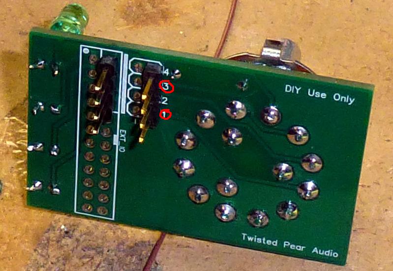

Thank you it's a very good information, connecting a wire between "B" on the Sidecar & pins 1 or 3 on the selector switch it's OK?
"B" on the Sidecar
Attached position 2 or 3 selector switch

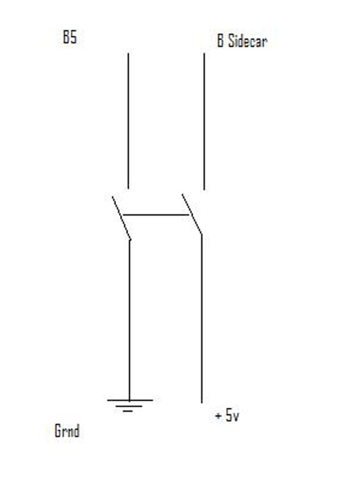

The best way to do this is with dual pole single throw switch. One pole should be connected to GND and "B5" on the Buf III I/O header - the other to 5V and "B" on the Sidecar. In this way when PCM/DSD is selected SPDIF auto-detection is disabled. You also get to use all 4 SPDIF selections.
Cheers!
Russ
Dual pole single throw switch, like this?
So one position connected to GND and "B5" on the Buf III I/O header - the other to 5V and "B" on the Sidecar so you switching between:
-GND on the Buf III I/O header and 5V on the Sidecar
-"B4" on the Buf III I/O header and "B" on the Sidecar
Where have I to connect the two middle pins of the switch?
-"B5" on the Buf III I/O header and "B" on the Sidecar
Look at the post above yours. The switch you show is not a DPST, but a DPDT.
sry but I´m a little confused:
according to leonbv B5 is IRR bandwidth (page 34 switch 6)
if one wants to change s/pdif autodetect switch 5 aka B4 is the one to throw to gnd
or did I miss something?
best
Leif

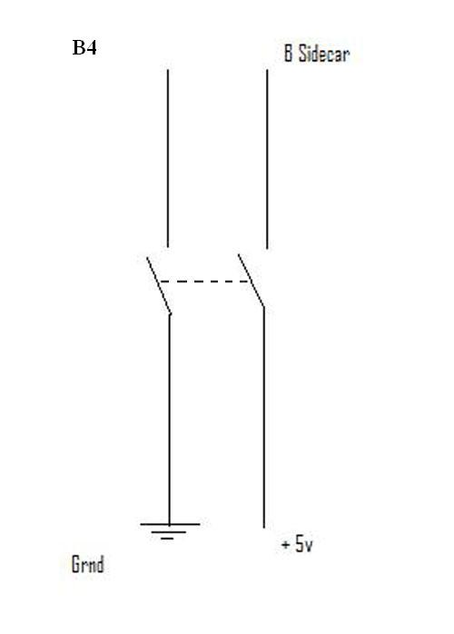

B4 is SPDIF auto-detect Bypass (Switch 2:5) I will correct my post. :)
I forgot that the ports are 0 indexed and the switches 1 indexed. :)
I tried to edit posts to make this more clear.
Switch 2:5 is indeed EXT I/O port B4. Sorry for any confusion.
Good catch Leif. Thanks Russ! I attached a corrected image noting B4 in this post. I don't have the power to delete or change the image in my prior post but would encourage those who do to change it or delete it. Thanks!
