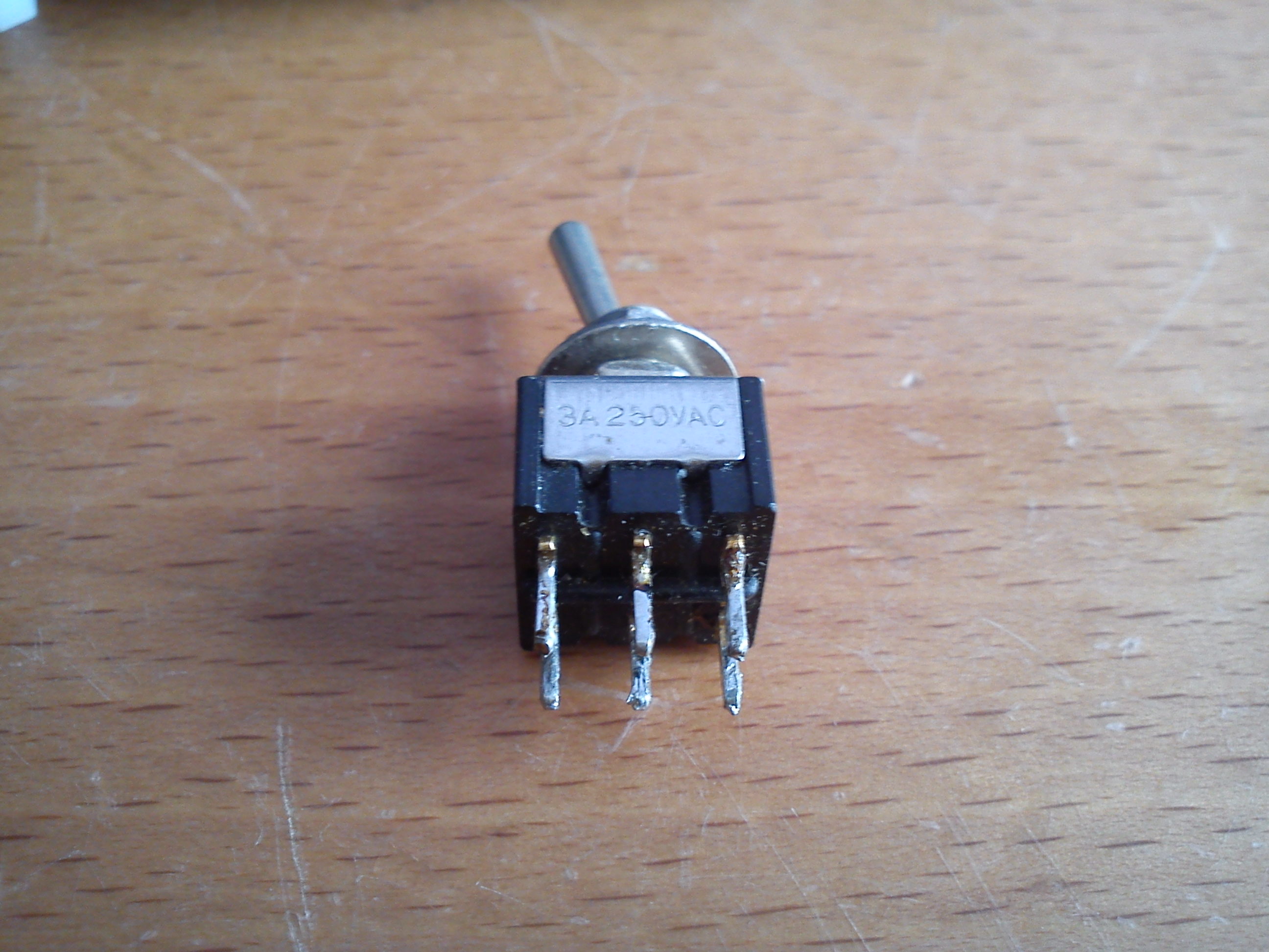

Hey Mates
I'm gettin' confused here. I have a BII (stereo, just a single board) and I need to switch between two SPDIF input, ...

A single pole double throw switch will work...
Like this rated 3A 250VAC - 6A 125VAC on-on with outputs 2 pins middle position & inputs 2 pins left side and 2 pins right side:
Thanks my idea was to switch both: signal & gnd.
Which kind of switch do you need in order to do that?
Best wishes
Pietro
Best wishes
Pietro
DPDT (double pole, double throw). However, I would recommend not switching grounds.
