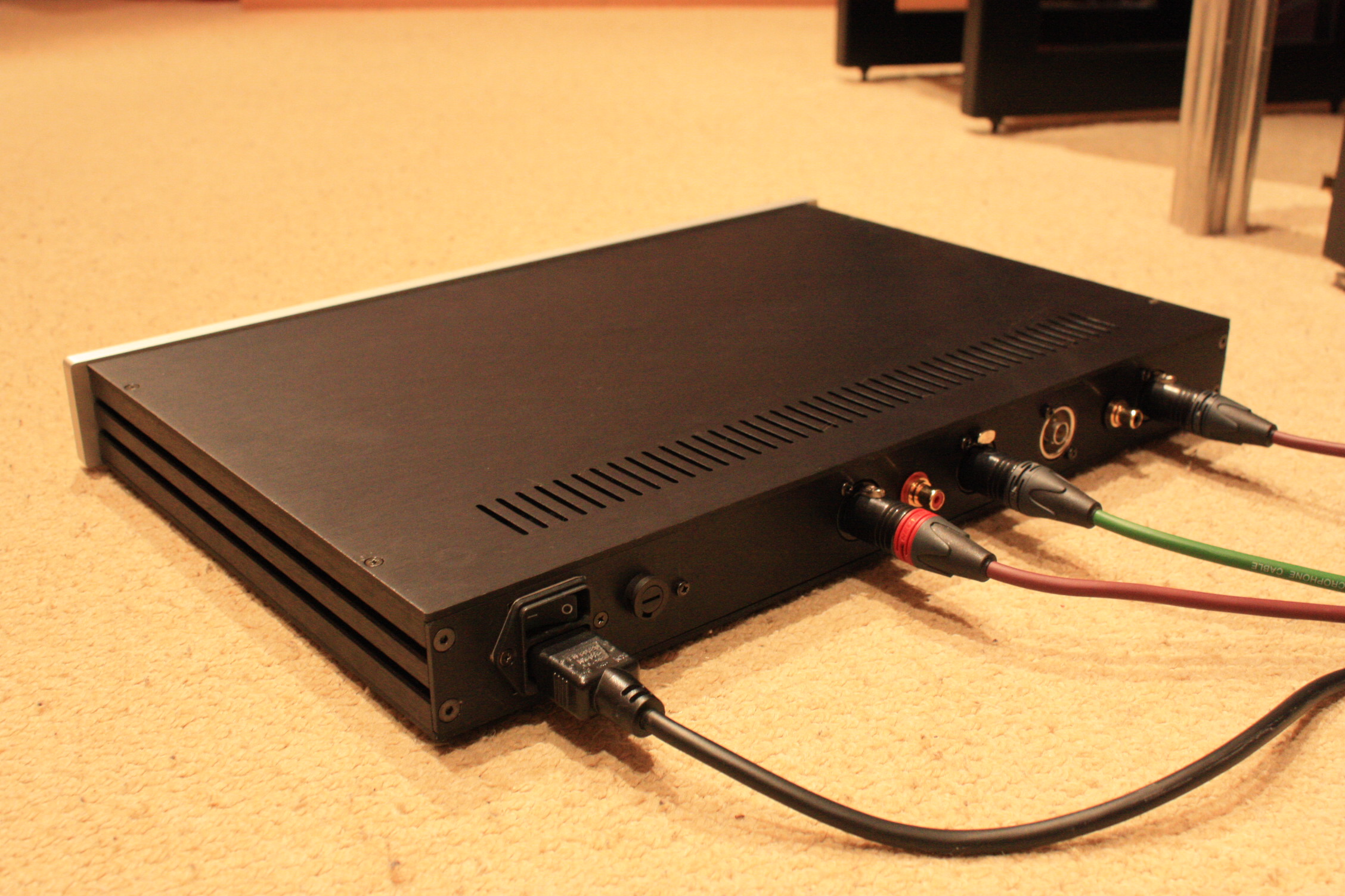

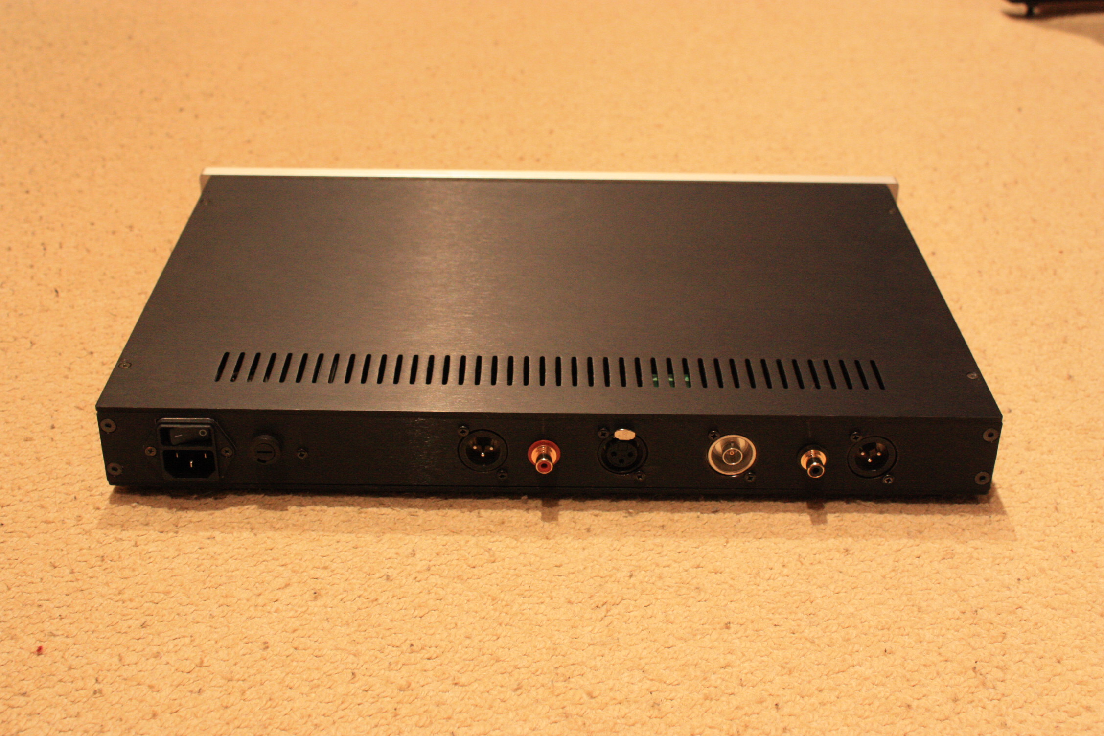

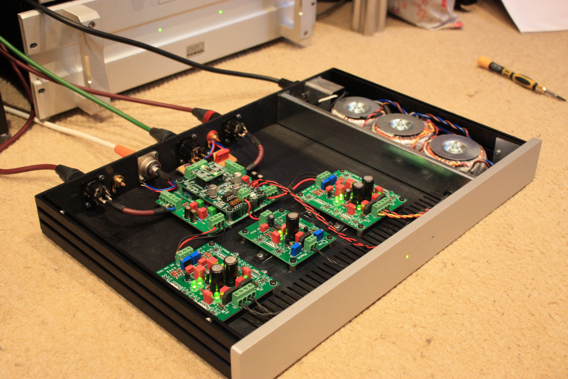

Nice build I'm assuming you have the aluminium bottom plate, right? How warm does it get with the placids connected to it?
Thanks for compliments guys,
Yes the case is the 1 U slimline from the modu shop. It's the all aluminium version with 3mm thick top and bottom covers and 3mm rear panel. I like the look of the case, it's easy to build and good value.
The bottom ali plate barely gets warm with the top cover off and only a little warmer with the top cover on. Overall case temp is very low as long as it has space around it. If you stack other gear on top it does get a bit warmer but nothing to worry about.

Excellent & very professional work, congratulations.
I want to know wich hook up brown balanced analog cable are you using, seems the same than the used externally with the XLR connectors?
Thank you - the cable is Van Damme XCE Star Quad microphone cable, its used by Bryston for their OE interconnects and apparently they tried quite a few cables before settling on this.
I am very pleased with it, I doubt you need to use anything more exotic - but there are whole threads dedicated to that subject so i wont go there...
