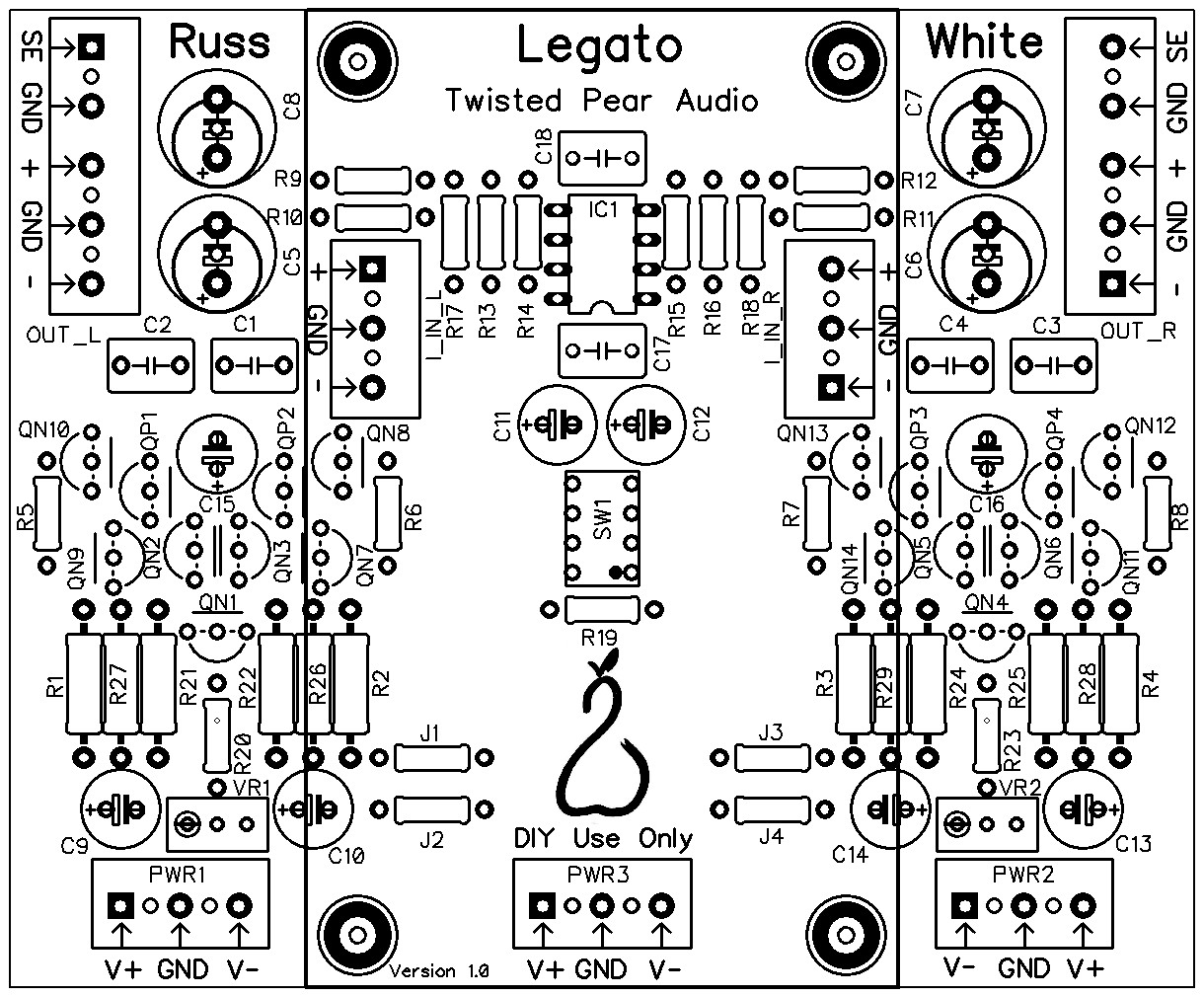

Introducing Legato
This is just to show how things are progressing on the discrete output stage front. This circuit is called Legato. It is a derivative of Counterpoint but without the folded cascode and with an optional buffer and some other changes. Both the input and the output impedance are quite low when this buffer is employed. When I say low I mean less than 1 ohm low. Without the buffer output impedance is around ~200ohms(back of the envelope calc) but the input impedance is still extremely low. Low input impedance is the key to getting the most out of the ES9018.
Now some of you will spot IC1. It is an optional Balanced to SE converter. I only added it because I had room. You don't have to use it at all.
It is is exactly the same form factor as IVY-III and will come ready to work with Buffalo II. Though it will also work quite well with our COD DAC too with some component value changes.
Anyway I am posting here to get some gauge of interest.
Oh and one more critical detail. There is no negative feedback employed in the core circuit. So if you use balanced outputs there is zero global NFB.
I have tested the circuit. It is sounding very sweet.
Cheers!
Russ

Russ:
This looks very interesting. In another life I built a Borbely discrete output stage and filter to use with a PCM63.
I bought the Buffalo II so I could experiment.
This weekend I should have it up and running with Lundhal transformers. I will follow with a Welborne Cato low voltage differential output stage and possibly a Lampizator 6SN7 (balanced in SE out) circuit.
I will gladly add your new board to my experiments. This is how I learn and find what works for my ears and system.
When you say balanced to SE is optional by use of IC1 do you mean you could also get SE by using only either one of plus or minus outputs or if you need SE this is the way to go.
Thanks again for the ability to experiment and your great products
Bob

Dear Bob,
I today use the LL1674:s to do passive IV on the Buffalo II with a 4k nude Vishay TX2352 resistor on the secondaries (a 10k pot then follows).
What Lundahls will you use?
