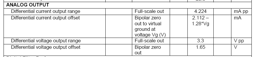

Hey Russ,
Is the datasheet wrong?
This is from the 9008 datasheet running AVCC of 3,3V. How do you make 2Vrms out of that? The spec says 3,3Vpp that without a doubt corresponds to 1,17Vrms.
If the sheet is right, going for 5V should give us 1,77V.

This has gone OT and isn´t the most important thing in the world:
The datasheet says differential so the guys at ESS did a small spec mistake(but great DACs). They don´t single end. If we are kind we can call the specification diffuse.
I am still a little puzzled/impressed how they can make the single outputs 3,3Vpp swing fully up to the rails with 3,3V DACC.
Had to check a few others like Wolfson and CL and what they call differentiel output is between the phases(like it should) and in Wolfsons case is 2Vrms. Lets call that "Industry Standard".

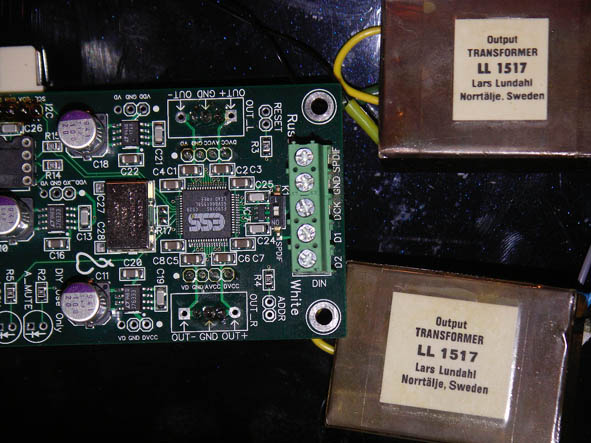

Just to put my 2 cents and sign to the club of BuffaloII & Transformers.
I'm just playing with Buffalo and Lundahl LL1517.
On some aspects probably IVY is technically better output stage with lower distortion and probably more “details” but with transformers Buffalo is playing "smooth and easy".
You just don't wont it to stop playing. :D .
And also very nice thing is that Buffalo with LL1517 can drive directly HD650 with absolutely no problem. Great Sounding and “SUPER SIMPLE” HedAmp.
Anyway Buffalo is really great DAC and Russ and Brian are doing amazing job about it.

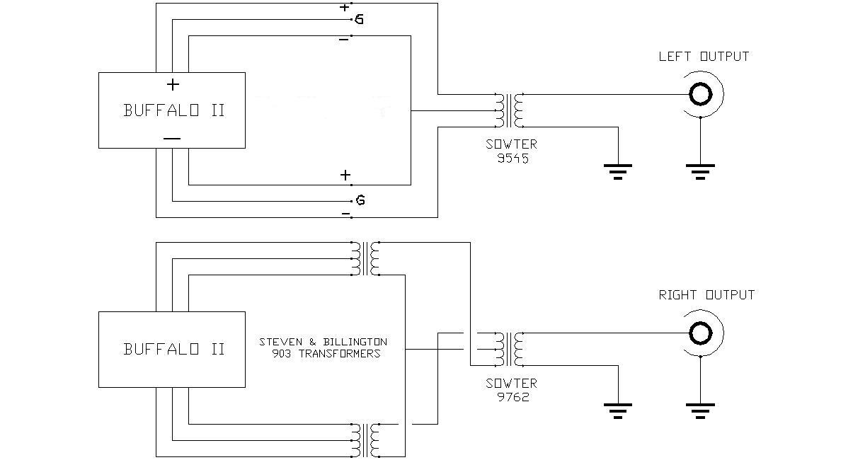

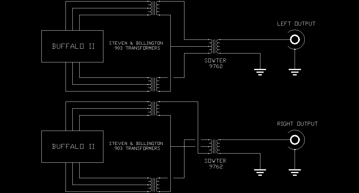

I asked a queston at the original Buffalo II thread about dual monos.
I was wondering if it would be possible to use transformers as the I/V output for dual monos?
Not sure about the resistance values I'd use across the primaries and secondaries.
I'd really like to not use an active I/V and Bal/Se combo for S.E. output
I came up with something like this:
Workable??
