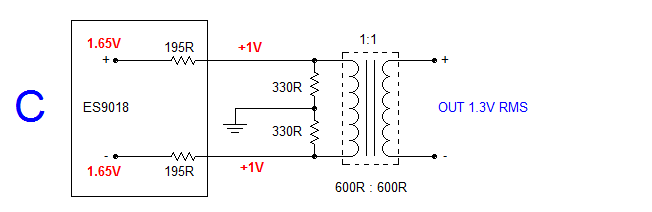

If you want to use Voltage, then transformer is the way to go. Many have heard me say that many times over, that with a differential voltage output where any DC offset will not be seen by the Primary of the transformer. But the Sabre DAC is not a conventional Voltage DAC.
The Sabre DAC has a much higher output Z than is usual for a Voltage DAC and hence there is reason to point to it as the cause of the light tonal balance when used as such. We need to reduce that Z and also force the DAC into current.
So, Voltage mode, use:
The two resistors force the Sabre DAC into 3.14mA current offset while reducing offset voltage from 1.65V to about 1V. The output will be 1.3V RMS.

Joe, I also use a LL1527XL tranny - but primary centre tap is floating. What is the purpose of the resistor/cap connected between the centre tap and ground?
Regards, Paul
Regards, Paul
It creates an offset current, something you can only do with Sabre DACs and also lowers the Primary impedance - always a good thing.
Try it - you already have the resistors in place -then listen and report back here. Others have said that it improves the tonal balance, making it sound more solid, less light.
Cheers, Joe

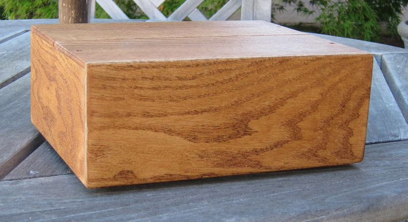

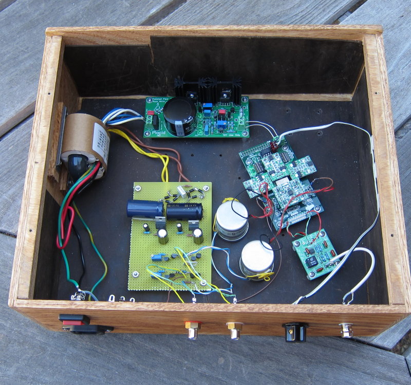

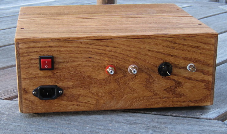

I just finished building a Buffalo III dac with the latest Trident regulators. I use a single SPDIF input module and 75ohm BNC connector. Outputs are transformer coupled using Sowter 1:18.7 transformers model 8347. The output of the Buffalo DAC is loaded with 25ohm resistors. I followed Joe Rasmussen's suggestion and did this with two 12.5ohm resistors (33||20) from + to ground and from - to ground. That combined with the step up of the Sowters gives a "normal" level for the DAC and is the suggested loading for the Soweters. I buffer the transformers with a discrete FET buffer so that there is sufficient drive. I've found that transformer output alone can sound a bit light weight. It's similar to the buffer that Joachim Gerhard suggested in this ES9022 thread http://www.diyaudio.com/forums/digital-line-level/151846-anybody-using-new-ess-vout-dac-es9022-29.html#post2865647
I used 2SK170s cascoded with some higher Idss FETs I had in my junk box.
The whole thing is powered by an R-core transformer I got off of ebay - 120v/240v primary with dual 9v and 15v secondaries. The 9v secondaries are paralleled to drive the digital section and the 15v primaries are rectified and regulated to give +-15v for the FET buffer. The digital section is regulated using a Placid HD shunt regulator from TP audio while the buffer uses LT1086 adjustable regulators. I've only had it working for an hour or so but it sounds pretty good so far. Definitely worth the effort.
I built the DAC in a wooden box damped on the bottom and sides with Dynamat. The bottom is 1/2" baltic birch plywood, while the sides and top are solid oak. Below are a few pictures of the finished DAC.
---Gary
