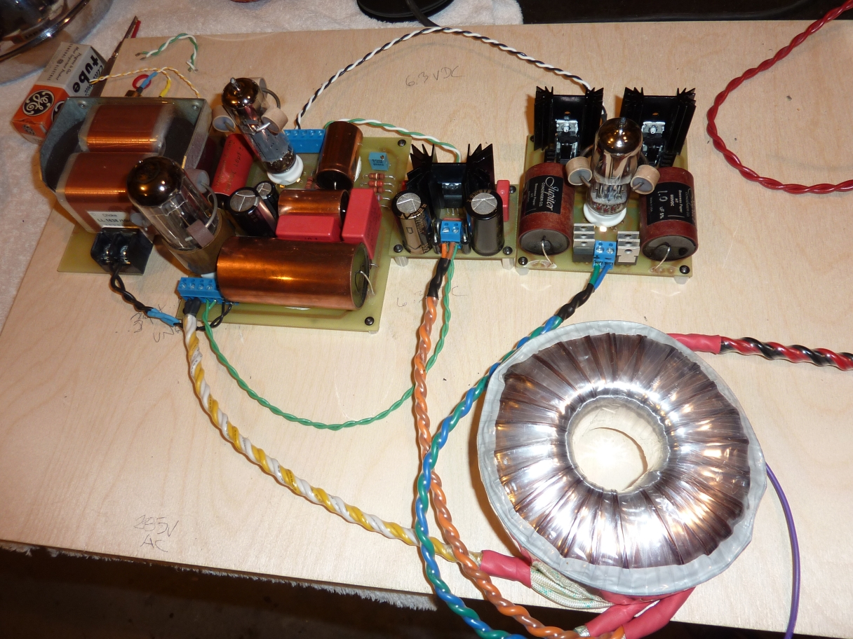

I personally do not like long wires. It is not better to place the DAC board just over the transformers (to have the shortest coupling wires)?
I agree. This is just a rough layout, I still have to make room for the USB receiver and MUX board so things will be shuffled around a bit inside. I always try to keep wire runs as short as reasonably possible.

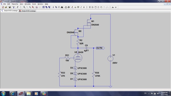

There are infinite number of variables in your question/query. I don't think too much gain is going to be a problem and with some enough gain is going to be a perceived problem to them because the fall short of 2V?
To that I would add that a reasonable low output impedance would be part of the requirement as well, at least to me.
Also, that 3R value could be tweaked upwards (and downwards) even if that is further away than ideal. But I would say than an exact target of 2V is not that important to me and as low as 1V would not disturb me.
Here is a circuit worth looking out - the Line Stage on the right side:
The 25K could be increased to 47K no problem.

Joe, I'm just going to use a simple single stage as I do not want or need another entire pre-amp. A single triode with a CCS load. 1/2 of the tube for each channel. AS I mentioned I have a choice of tubes that I can tweek the operating points to get to good places in the load lines and my ears. Allens pre-amp is waaayyyy over the top and over complicates what I want to do..
The attached pic is the basic setup (with different values for the load to the transformer and to the tube I'll end up using)
So I can play with the transformers primary to suit the tube, or I can play with the tube to suit the primaries of the transformer.
I was also considering your earlier statement that there may be better sound quality as the primary resisance got to the 3 ohm range...(1.5 R in my case because of using Buff2's in daul mono, one per channel).
My question was pertaining how much actual tube amplification is needed to the different primary setups, not looking for a precise 2v output.
If the dac & transformer is putting out volts instead of mv's then a tube with an amplification factor of 100, I think, would not be suitable. If I use a tube whos amplification factor is 15 on a tube with mv output, that too I believe would not be workable as the output would be too low for my pre-amp which has about as much amplification as a passive (just basically a volume control).
JD
