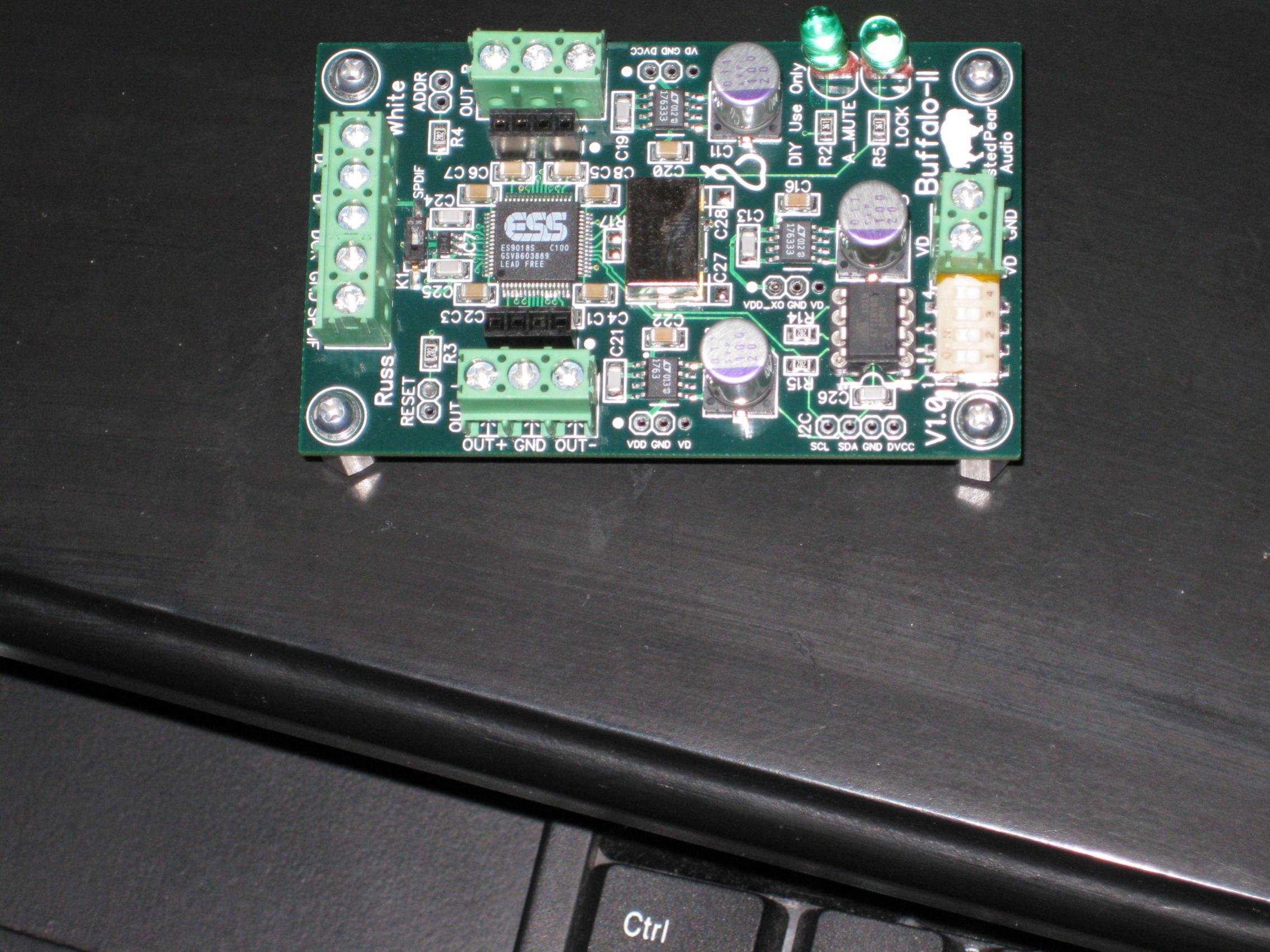

The problem seems to be that you have a short after or within the 1.2V VDD regulator.
This could mean a couple of things.
1) Perhaps a short between components pads. Check around C12 and C15 on the bottom of the board.
2) Could also be a ESD damaged chip.
3) Least likely is a dead VREG, I say this because the current it could ever see is limited by the Placid itself.
Also closely inspect all of the components and DAC pins connected to that net. For example C21 and C22.
I carefully looked for any visible shorts both near the reg and Dac and under the board. Pictures attached. I could not see any problem.
Looks like the chip may be damaged or reg it self may be shorted. Unfortunately I do not have SMD capabilities. Can I send the board for repair to Twisted Pear?

Have you tried feeling the chips to see if any of them are getting hot when the buffalo is powered on? If you're loading the placid so hard that the voltage rail drops to 1.2 volts a lot of current is going somewhere.
I've had a similar problem where I blew an ASRC chip. On power on, the 3.3veg was loaded down and the ASRC chip itself got very hot. It didn't take a genius to figure out what had gone wrong.
If there is a short internal to one of the components, it might heat up also. However if it's a solder bridge somewhere they probably wont.
