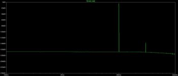

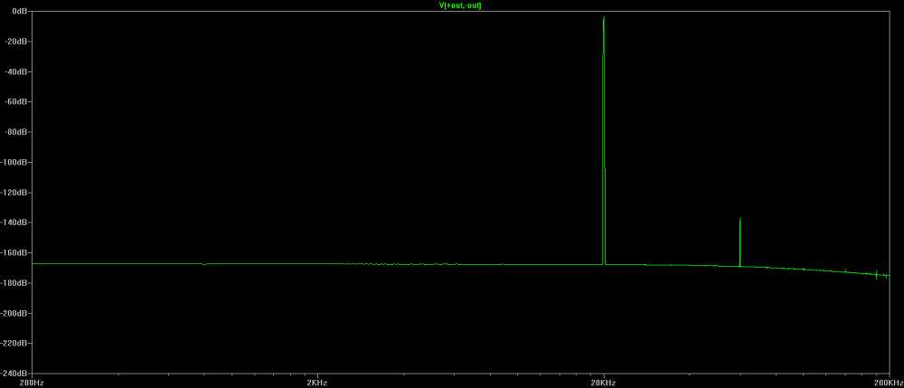

Counterpoint sim results
This how the simulation says THD should be at 20kHz and 1Vpp(2vpp summed) balanced output.
And this with no global feedback!!!
Fourier components of V(+out,-out)
DC component:1.80661e-011
Harmonic Frequency Fourier Normalized Phase Normalized
Number [Hz] Component Component [degree] Phase [deg]
1 2.000e+04 9.321e-01 1.000e+00 -12.42° 0.00°
2 4.000e+04 4.064e-11 4.360e-11 -15.38° -2.96°
3 6.000e+04 2.033e-07 2.182e-07 -28.08° -15.66°
4 8.000e+04 3.108e-11 3.335e-11 -50.12° -37.70°
5 1.000e+05 1.074e-09 1.152e-09 -64.70° -52.28°
6 1.200e+05 5.534e-11 5.937e-11 167.47° 179.89°
7 1.400e+05 1.686e-09 1.809e-09 91.83° 104.26°
8 1.600e+05 2.156e-11 2.313e-11 121.47° 133.89°
9 1.800e+05 1.537e-09 1.649e-09 -118.13° -105.71°
Total Harmonic Distortion: 0.000022%

Re: FFT
i am quite amazed that you can achieve -165 to -170dB with your test set-up. What sound card are you using and what are the settings (how many bits and sampling frequency).
would you mind posting the response of your testing hardware on its own with the same 20khz stimulus (jump the output to the input)?
thanks
Russ White said:here is the simulation FFT.
I just measured the real thing with easy lab. The distortion and noise were below the floor of the ADC.
Cheers!
Russ
thanks
