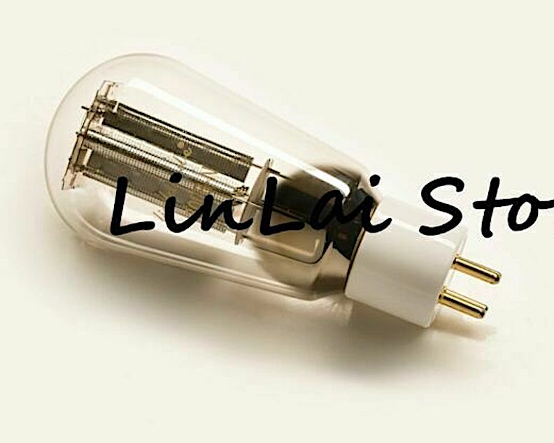

Do all the 300b-Z have mesh plates? Impossible to see in the photos because of the black glass. In addition there are a couple of different types calling themselves 300B-Z e.g.
Matched Pair LINLAI Z Series 300B-Z HIFI Audio Vacuum Tube Amplifier Classic New | eBay
1 Matched pair premium Shuguang Treasure 300B-Z Vacuum Tube Replace 300B WE300B | eBay
And is the "mesh" plate the usual perforated one, as in the 300b-N?
Matched Pair LINLAI N Series 300B-N HIFI Audio Vacuum Tube Amplifier Classic New | eBay
And is "Linlai Store" in any way connected to Linlai or is it a rebadged PSVane?
