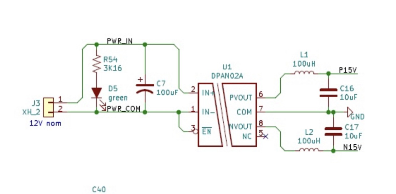

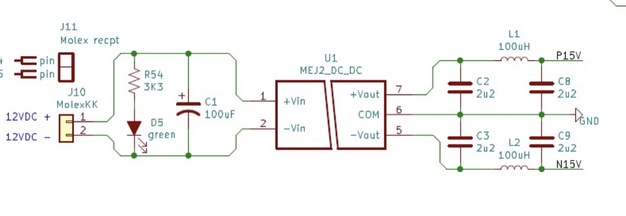

Great that you can still find the parts. I managed to find a surplus of those Murata DCDC converters on eBay (bag of 100). Handy to have around for any project needing +/-15v. Sometimes I wonder why we work so hard to make fancy supplies because these measure very clean as implemented in BTSB with an external LC filter. You can see how clean the noise floor is.
Doesn’t get much simpler than this (on BTSB Panel Mount):
On BTSB SMT/TH:
On BTSB SMT/TH:

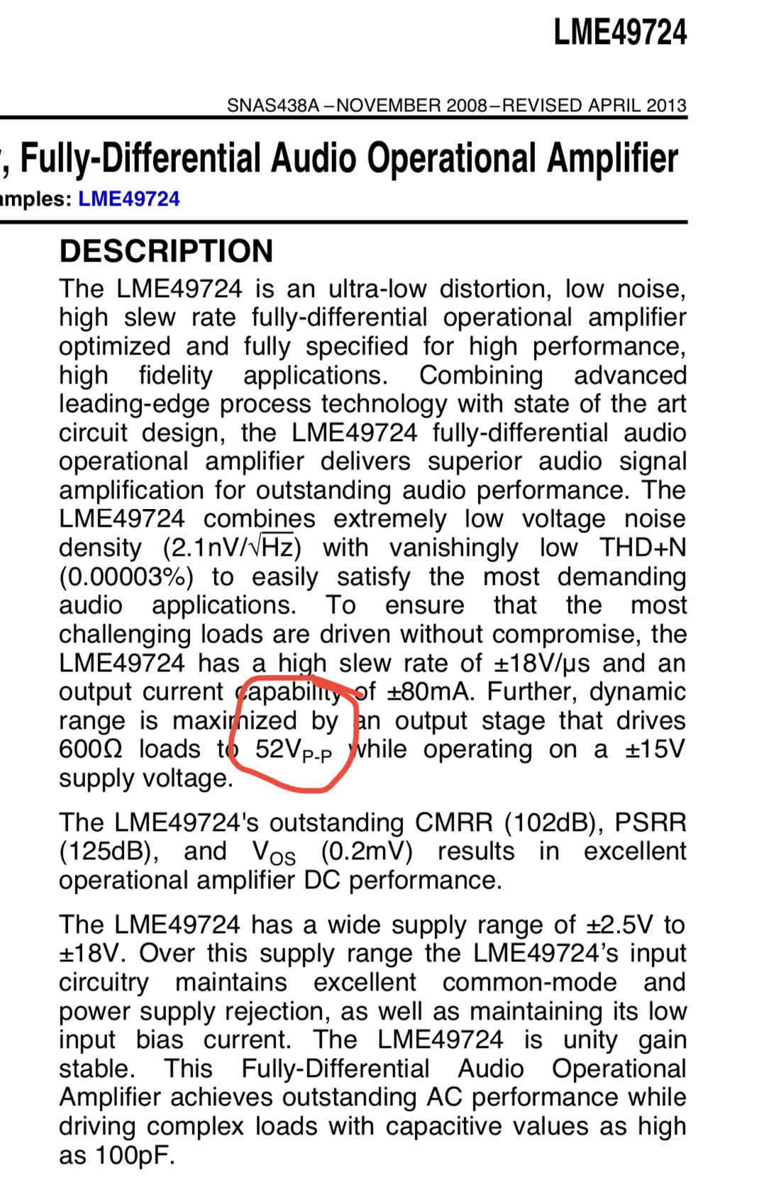

@stretchneck
Let’s assume we use a +/- 15V supply (which is what the stock supply is
). Let’s also assume we take the data sheet results of 52V pp capability or ~18V rms max output [My 20V RMS statement above was with a lot of rounding - oops!]
The maximum input sensitivity for the BTSB will vary depending on what gain switch you implement.
If it is set to 0dB (Av=1) gain setting, then obviously the maximum input sensitivity will be 18V rms.
If it is set to 6dB (Av=2) gain setting, then the maximum input sensitivity will be 9V rms.
If it is set to 14dB (Av=5) gain setting, then the maximum input sensitivity will be what? Hint: It will be less than the 6dB setting. And about 5 times less than the 0dB (Av=1) setting ;-)
If it is set to 20dB (Av=10) gain setting, then the maximum input sensitivity will be what? Hint: It will be less than the 14dB setting. And about 10 times less than the 0dB (Av=1) setting ;-)

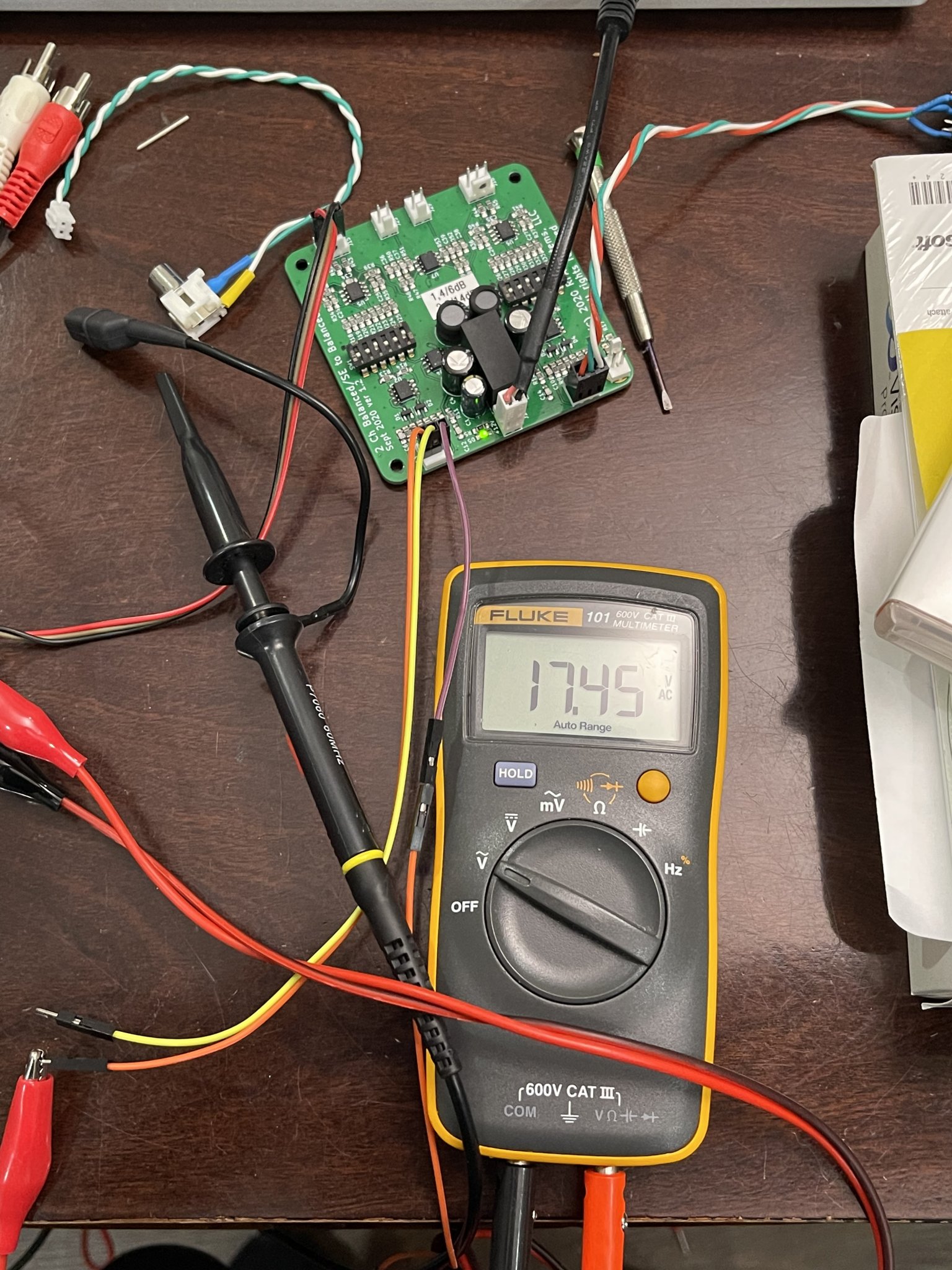

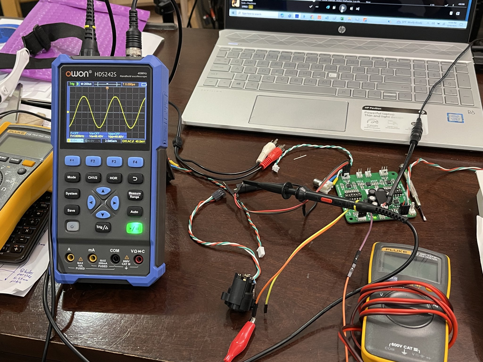

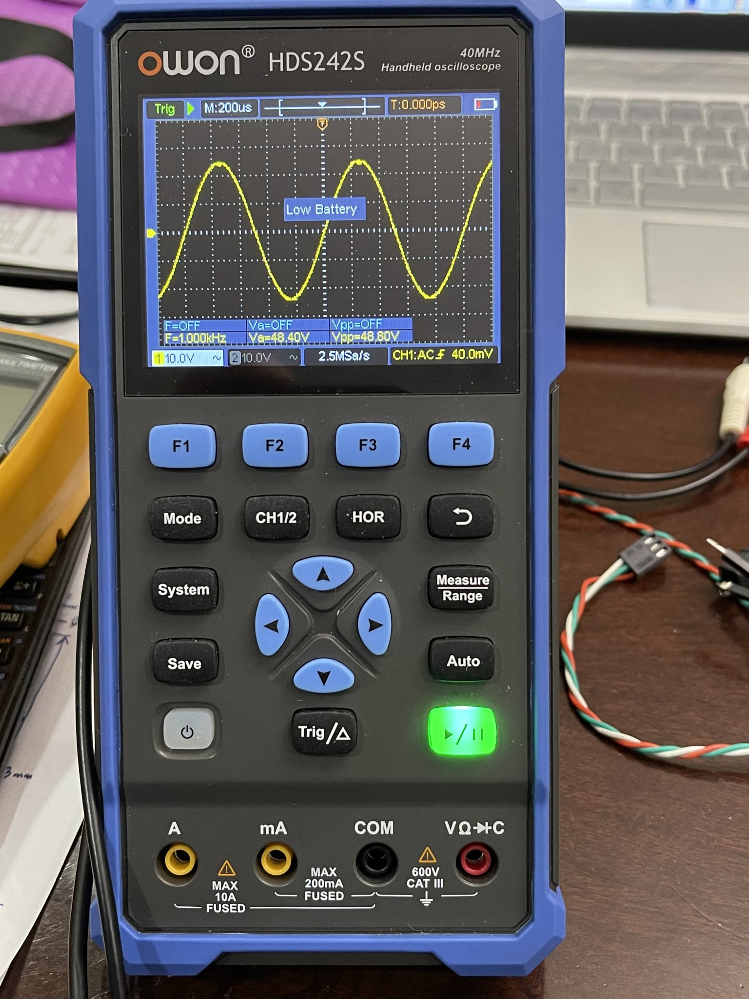

I was curious to see if the BTSB really could drive 52v output swing. My built in function generator on my Oscope only makes 4.9Vpp. So I connected that to the balanced +/- on the input and measured output on +/- (GND pin in the middle not used). Sure enough I got 49vpp output on Oscope and 17.45vrms on DMM. That is 49.3vrms. It works!
Here’s the setup:
Oscope shows 48.8Vpp:
(The glitch at the peak is artifact of the generator)
Here is DMM AC volts:
Power supply was 12v class 2 linear wall wart and onboard DCDC is +/-15v.
This is certainly more than enough to drive an F4 to clip at 25w.

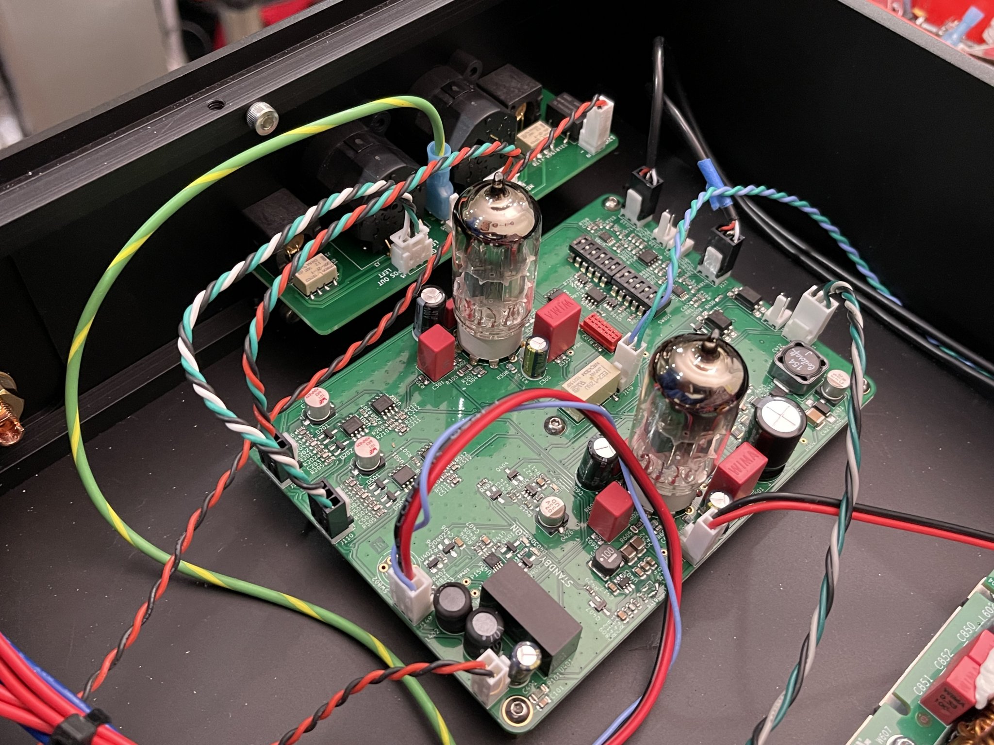

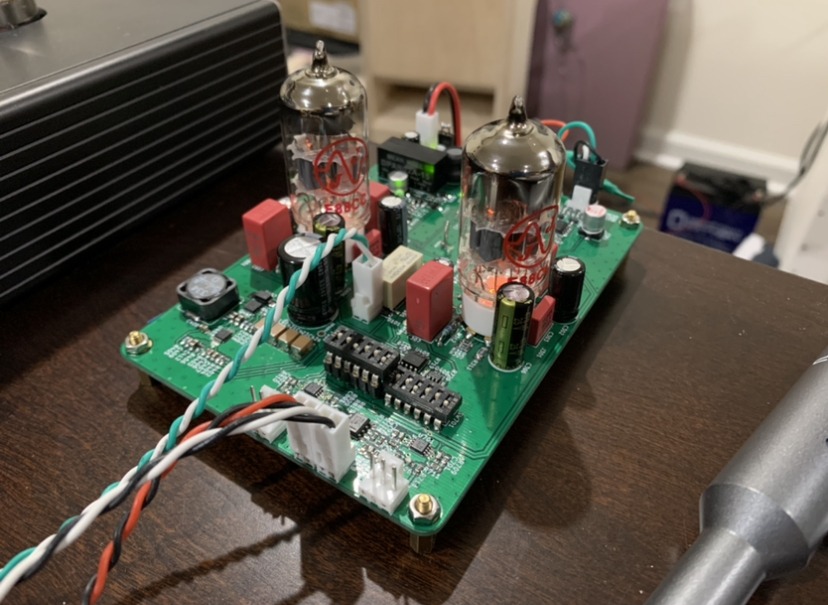

The HyperSET buffer was custom designed by Jhofland for this amp and is based on the BTSB buffer but with an E88CC SE Class A tube stage in between to provide the sonic character of a clean low distortion tube amp with dominant second harmonic profile and yet low THD of 0.002%.
Best,
Anand.

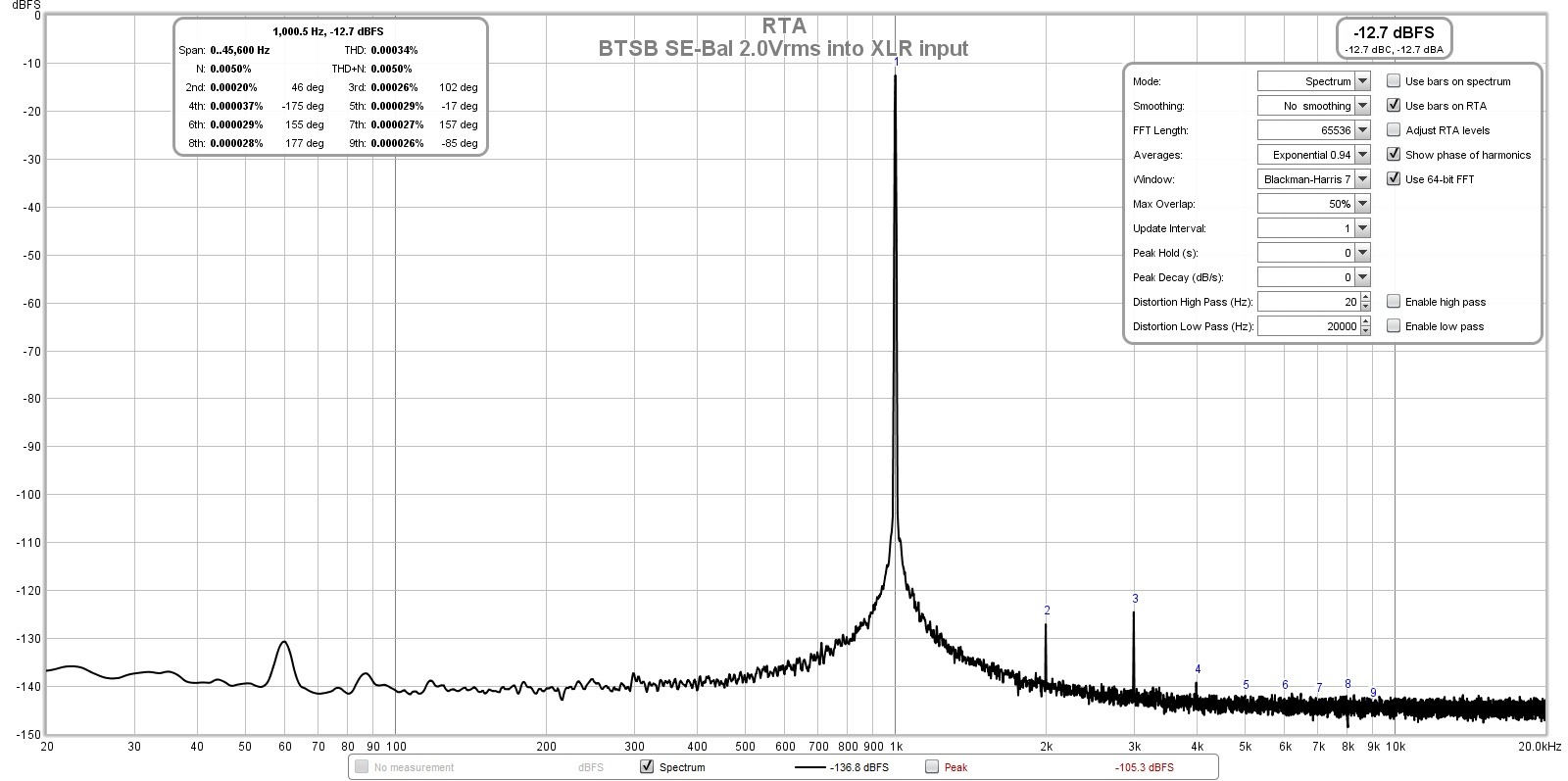

Btw, I just tested the panel mount BTSB, max voltage output (with the OPA 1637/ OPA1656 installed not the LME49764) was 30Vpp from the SE/unbalanced output. And that was with a 33kohm load. That amounts to 10.6Vrms. Without any losses, if plugged into a regular RCA input stereo/2ch F4 buffer, that’s about 14 watts RMS. I ran out of time so I didn’t test the balanced outputs from the buffer, but I figure it should be close to double or maybe a little less since it is the OPA 1637 and not the LME chip.
So now we have most of the data, except for max distortion at the highest levels - which I’m least concerned with since that‘s usually not the levels we ordinarily listen to.
