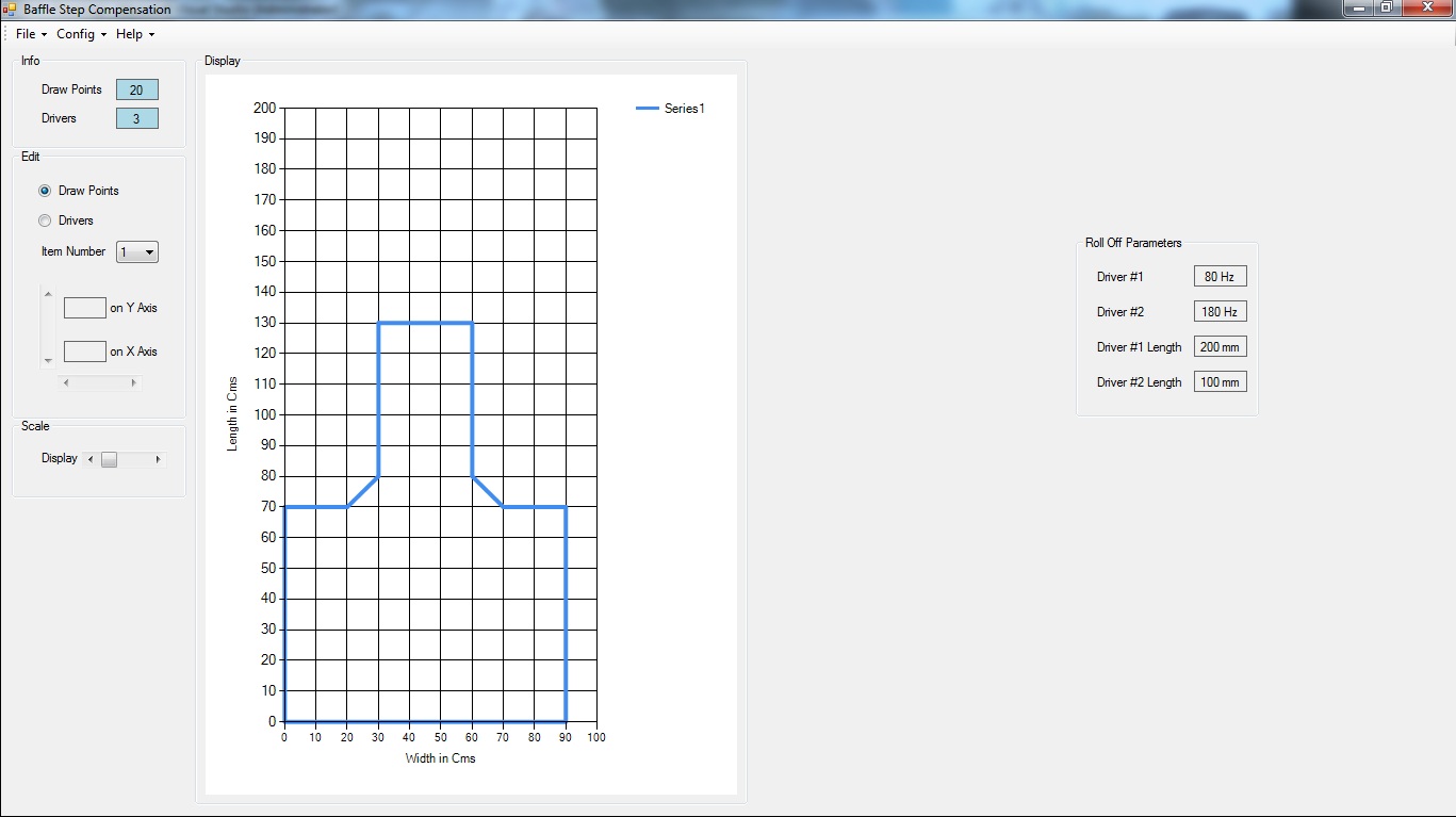

I know this is going to sound crazy but… I find the best way to learn about something I know absolutely nothing about, is to write a program about it.
To get my head around how the SPL rolls off based on baffle width, I have decided to write an app that allows me to simulate virtually any baffle shape (flat only at this time).
I know I am probably reinventing the wheel, and there is probably an app already out there that does exactly what I want to do, as I generally find out something exists right after I invent it.
Anyway who knows even if it has been done before I might come up with some new features that no one has tried before. So here goes…
The plan is to design any baffle I want and place the speaker anywhere I want and be able to calculate the frequency it begins to roll off.
Here is a quick mock-up of what the app might look like. Things like adjustable baffle size, edge points etc. are going to be features, so designing a baffle a 100m long should be doable.
Still putting together some GUI ideas, but for a start I am looking to start with something like this.
The intial baffle points will be defined using two text boxes,but at a later date I will look at possibly sliders or mouse click to position the baffle point.
This is just a framework with little code behind it.
I would like to do an animated radar circle expanding from the driver until it touches the baffle boarder to show the contact point, and give some idea where it is going to touch, but that is probably way down the track.

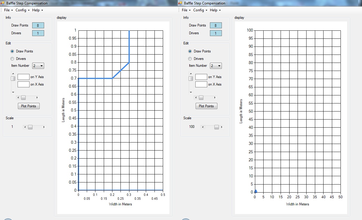

Quick update... Have now coded all the controls on the left of screen dynamically (as apposed to statically popping them on the form).
I prefer to to this so when I resize the screen it is easier to maipulate the size of the controls and move them around.
I have made it so when I change either of the baffle points or driver count it will update the drop down box with the right amount of items.
If the baffle points radio button is checked. the first and last drop down box entries will result in the X & Y coordinate textboxes and slide control being disabled, as the first and last points must be at 0,0 to close off the baffle shape.
I have added a slide control to allow the size of the baffle to be altered, but there is not code behind it other than the code to draw it on the screen.

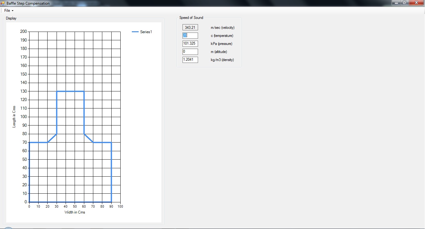

A large part of the graphical side is already completed (easy code)
The tough bit now begins... while I can draw the shape to screen, the values I will be using to measure the distance from the driver location to the nearest boundary will be quite diffacult.
To draw a line I only need to know 2 * X,Y points, but to measure from another point to any point along that line is going to be quite tricky.
I have decided to make the scaling of the baffle non infinate. at 1:1 the baffle will be 1 meter tall by .5 meter wide at 100:1 the biggest baffle possible will be 100 meters tall by 50 meters wide making it big enough to cover even fairly crazy baffle sizes.

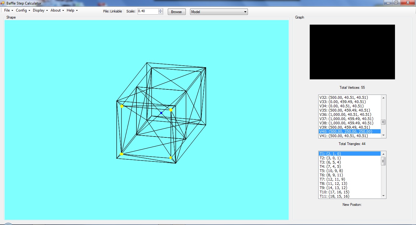

Just a quick update... progress has been slow as I delve deeper and deeper into 3D graphics. Recently I have been given some fantastic help with 3D graphics to the point where I am now considering making the app load from a graphics file like Sketch Up.
Unfortunately I can't use .skp files as the file format is locked down, but I am looking at a industry standard .3ds file format, Sketch Up Pro allows conversion from .skp to .3ds so there might be some hope yet.

The 3ds object was quickly knocked up using SketchUp, but essentially any drawing app that uses .3ds should load.

I had played around with some 3D rotation code a long time ago and I know how to make a simple 3D wireframe object and determine the vertices. But what I need is the ability to render a loudspeaker box and to place drivers anywhere on the baffle and be able to determine the baffle edge points. I did that using 2D graphics, with a front and side view, and using the .NET graphics functions. However, what people are really interested in seeing is the ability to import a Sketch-up drawing or something like that and to calculate the baffle diffraction directly from that rendering. So I need to understand how a "object" such as a driver is kept track of in the file and how to calculate the distances from the objects to the edge of the baffle they are attached to.
The other problem I had was calculating the internal volume from the outside points and material thickness. It turns out that following a path inside of a another path at a fixed distance from the outside path isn't an easy math problem. I read about a number of algorithms that do it, but ended up with a fairly simple but elegant solution for my own code. So you can draw a shape with lots of vertices and specify a wood thickness and my code will calculate the location of the inner vertices and then calculate the volume. I know that a good 3D drawing tool will do this...that's another capability I would need.
Well stay tuned over the coming months I plan to do most of that. There are still several obstacles I need to overcome before I get to that stage. First I need to be able to render multiple objects in the same image. In the sample I attached it's a single H baffle and it draws and calculates based that one object, but if I was to have two of them in the same file I need to view both objects as one object from a scaling perspective, otherwise it will base it scaling on the first object.
I had previously done this by refreshing the drawing twice (one to load, second to rescale) but it isn't an optimal way to do it. I am currently working on doing a full multi object rescale before any rendering is done.
