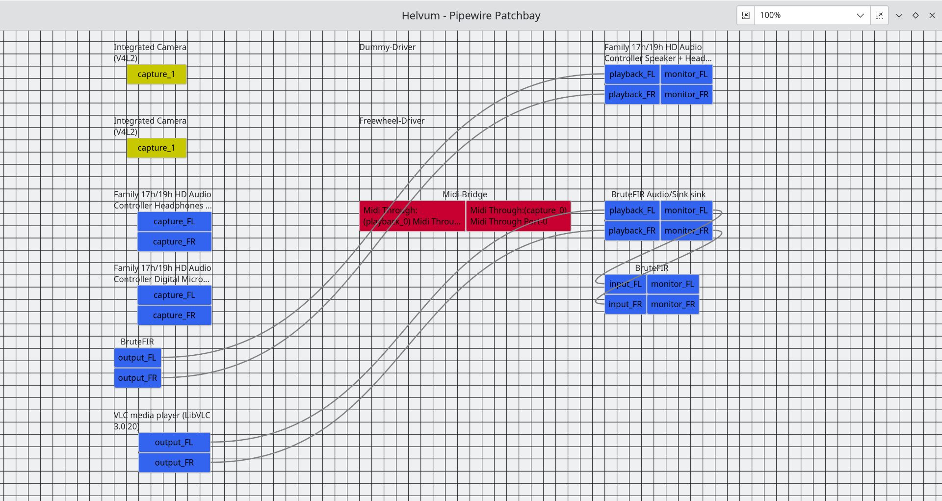

after many unsuccessful attempts to integrate BruteFIR into my stereo system (LibreELEC.tv, which is missing the ALSA-loopback module) i decided to write an IO-module to allow direct sound-output to PulseAudio/PipeWire from within BruteFIR.
The module provides a pulseaudio sink-input and source-output in PulseAudio/Pipewire which can then be routed using
pactl
or another patchbay (e.g. Helvum).Currently the module has hard-coded settings for 2 channels, a sample-rate of 44.1 KHz and a sample-format of S16LE, but i expect this to change in the future .
To use the new module configure the input-/-output device of BruteFIR to be of type
pulse
, e.g.
Code:
input "front-left", "front-right" {
device: "pulse" {}; # Use pulseaudio-module
sample: "S16_LE"; # sample format
channels: 2/0,1; # number of open channels / which to use
mute: false,false; # mute active on startup for each channel
output "front-left", "front-right" {
To filter your audio signal the resulting sink-input and source-output must be connected to their appropriate sinks/sources.
For BruteFIR-input load the PulseAudio-module
module-null-sink
via
Code:
pactl load-module module-null-sink sink_name=BruteFIR format=s16le rate=44100 channels=2
Its monitor-output
BruteFIR.monitor
should be connected to BruteFIRs input. BruteFIRs output has then to be routed to your desired (virtual) audio-device.Hopefully the attached screenshot shows how such a setup would look like.
If you are intereested the source-code can be found on https://github.com/chipfunk/brutefir
I appreciate any feedback.
For reporting bugs please use the GitHub issue-tracker.
Happy filtering
