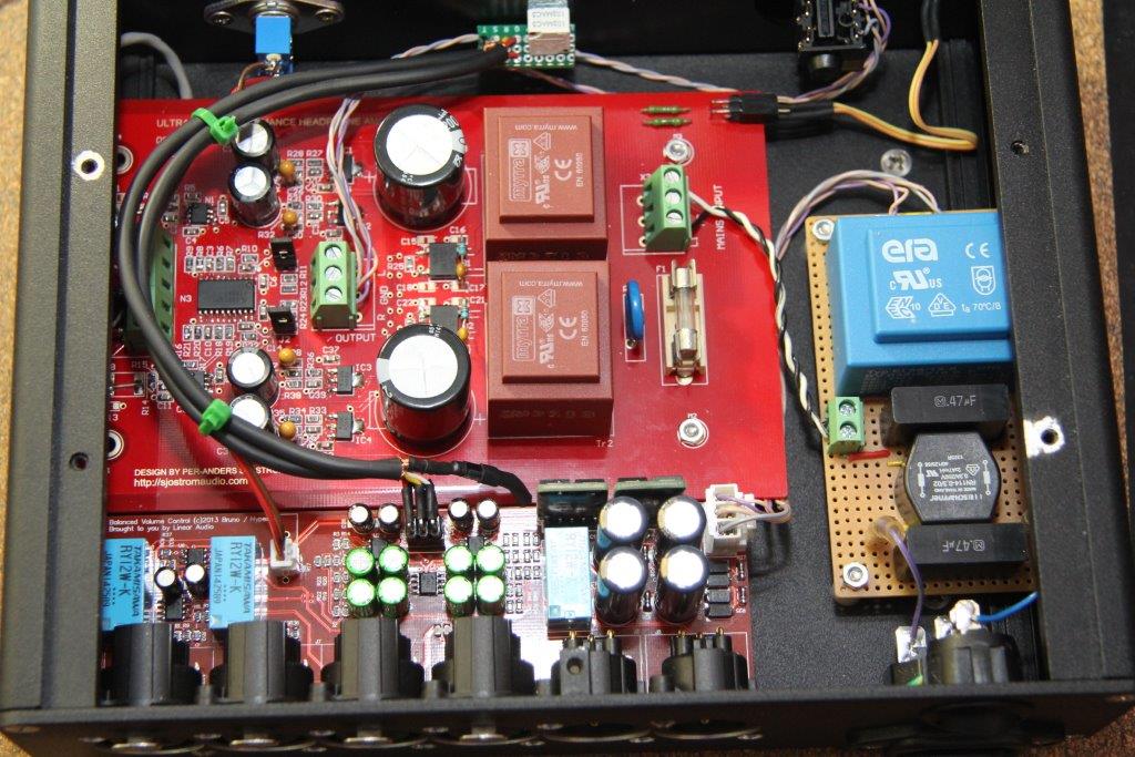

Here is my sample No. 2 in a custom-made box together with the Sjöström QRV09 headphone amplifier. In daily use since April of this year.
Braca
P.S. None of this would have been possible without the kindness of Jan and Bruno. Thanks again, both.
Braca

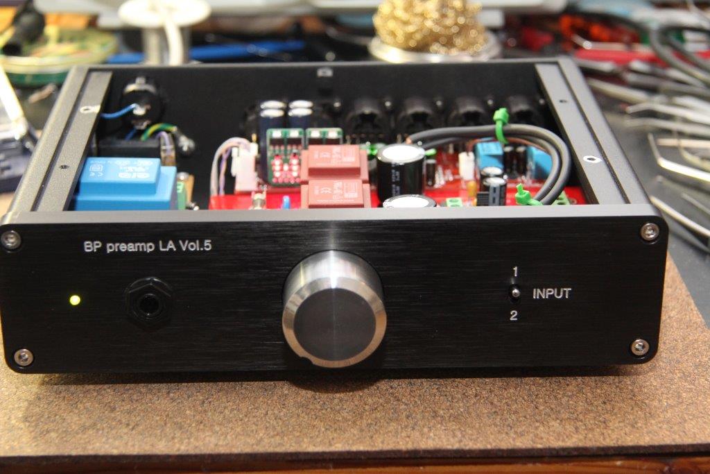

That photo is more than a year old, this pre is completed and works happily . All parts as per original BOM
except Hypex reg's: way to much on transport costs. Sorry guys, whoever arranges shipping...

Nik_d, nice work!
...I am curious about to which "original BOM" you are referring to?... Please correct me if I am wrong but looking on your picture I can't see the expensive resistors...
Hi emyeoui,
'Original BOM' - as in LA #5 or as published on EDN (pg. 2) - no super-expensive parts used. 'Precision film' - yes, where suggested.
Brgds
