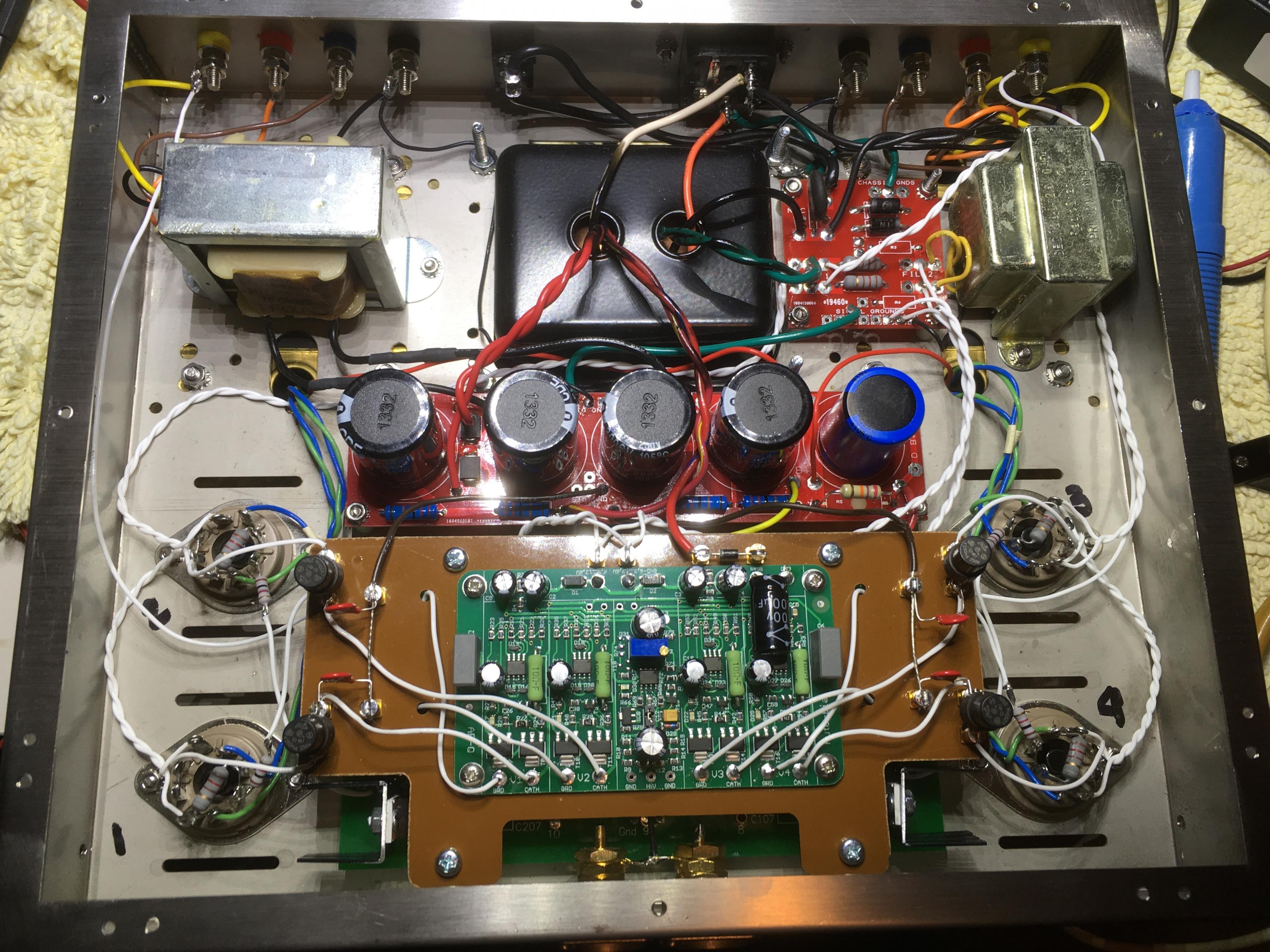

Fellows: I finally built the board I showed in post #38 and it works great. See the photos of my first trial build controlling a pair of 6BQ5s on a Hammond AO-43 organ donor amp. By "great" I mean that it keeps the bias balance and stability rock solid. What I don't know and can't really test is whether there are any sonic impacts.
Another odd thing is that on power up the current in the output tubes runs up briefly until the controller kicks in. I assume that's an artifact of the slow reaction to large swings needed to keep its effects sub-audible. It doesn't trouble me because it's transient and not too much over current.
NOTE: My layout in post #38 has a voltage quadrupler power supply since I had originally meant to run it off the 6.3 v filament transformer. However, you'll notice that on the quadrupler one leg of the 6.3 Vac input is grounded, which means it needs a dedicated power transformer (albeit tiny) or a spare winding on your power transformer. That is, unless you've got an odd amp with one leg of the filament winding grounded, or maybe a 12.6V filament winding with grounded center tap.

I'm not sure the balance control would be required. If teh same demand is applied to both channels then they should balance, Rob was using a Plitron VDV2100 CFB/H torroidal output tranny so he was very concerned about balance to avoid saturating the tranny.
To prevent overshoot at switch on you need to delay application of the reference voltage for say 30 seconds.
Ian
Thanks Gingertube, I'd forgotten about Rob's description of the startup delay feature (even though I labelled it right there on my board layout. :eek:). I guess I'll have to implement that next.
You're correct, strictly speaking the balance pot isn't necessary, but is included to compensate for tolerances in components. Pots are cheap so I included it. Various LM324s I tried were quite different so it was worthwhile, not to mention all the peripheral resistors, diodes and caps.
Guido Tent's bias board has an input for the HV supply and the bias board only starts trying to set the bias about 45 seconds or so after the HV supply comes up. Until then, it sits at -85V. It moves at a rate of about 1 volt per second after that until it achieves the target bias current. A single pot sets the target current for four tubes.
For the board I made of the Broskie circuit, I had planned on having a microcontroller that would control some power sequencing on the amp. This would also hold the bias board at a fully negative voltage until the power tubes were warm enough to conduct, then I would let the circuit go to work.

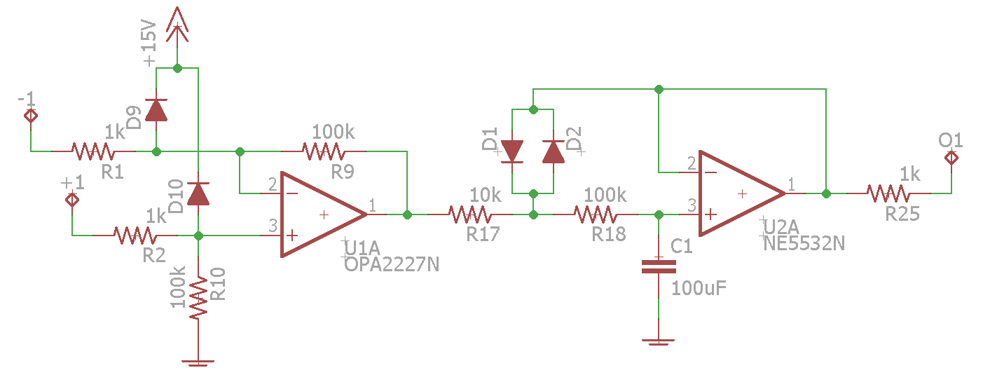

I made some boards very similar to the circuit in post #32 (after buying one of the TentLabs units which is in use in my main hifi amplifier). The circuit works great, I used it in an amp I made for my brother and various bench experiments. The clipper circuit makes the drift very slow and I have observed what I consider to be negligible variations in output even with ear-bleeding levels of sound coming from the amp. The variations were detectible, though. It does drift a little bit. The clipper circuit doesn't totally stop that from happening.
I selected different opamps for the version I made. I think there is room for a lot of improvement over what the circuit calls out, and what was in the TentLabs module. I'd be interested in what chips the other module uses as well. Maybe they found one with better cost/performance tradeoffs than I did. I think the one that I used cost seven bucks or something. I think I went for precision in the amp that does the voltage comparison (precision=$$) and low noise for the other stage.

Here is the version I built. This is one part of a board I made so that I could configure the servo for various purposes with jumper wires. I also wanted to be able to use it to bias voltage amplifier states using a sample of the plate voltage. Obviously, the voltage still needs to be amplified for a power tube. I used a simple pnp transistor amplifier like the circuit referred to earlier but I omitted the npn follower.
I think I used 2-5 Ohm current sensing resistors in the applications that I tested with this.
I'd be interested to see what you come up with in the end. I never simulated or played much with the design, just made some changes that I thought made sense.

I tried to improve auto-bias for convenience sake of a SE output stage, and found that it not worth it. When the output stage approaches clipping it's average current changes. Auto-bias trying to keep it stable causes audible dynamic distortions. The best bias for output stages from sound perspective is independent from current. Constant current bias is the worst scenario. Plain dumb shunted by cap resistor is kind of a compromise, but a part fixed-part cathode resistor bias is a good compromise.
However, if to implement a current sensor in pauses, and S/H when it plays the music, it may work well, even for class AB2 stages.
Well, the amp I tested this on was a (Class AB) push-pull KT88 amp with direct-coupled plate-grid feedback on the output tubes. Bias voltage was to a mosfet buffer gate and was ~-137V when properly set.
With the circuit as I built it, I was getting ~100mV of bias voltage drift after ear-bleedingly loud music passages. Loud electronic music with long, sustained bass notes. This drift was obviously very low frequency and I don't see how it could be audible in any way given the small magnitude compared to the required bias voltage.
