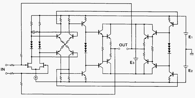

Diamond Differential Balanced Bridge
Below is the "diamond differential" balanced bridge amplifier published by Takahashi and Tanaka for Sansui in 1984. It's fairly elegant and has some things in common with the Hadley and Pass designs mentioned in this thread.
The authors claim it achieves extremely high CMRR, PSRR, and slew rate while being inherently immune to T.I.M. (which was a major worry back in 1984) without needing complex constant current sources for the "diamond" stage. The lack of current sources also allows higher current drive.
