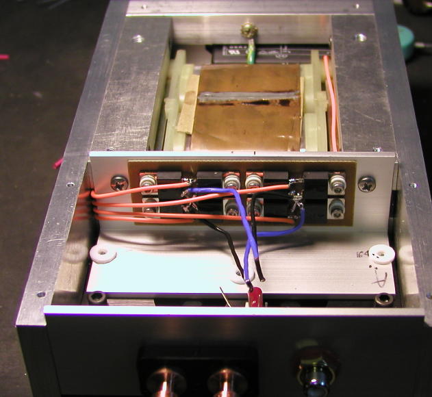

Me again Carlos, I have had my GC monoblocks running continuously for four hours as I am trying to break in my rebuilt Goodmans 201s. When I read your post I went straight over to see if they are hot but they are only very slightly warm and it is very hot here today.
My MUR860's are just glued to a piece of fibreglass.

Here's one of my more recent bridges in GC monoblock. One per rail http://www.diyaudio.com/forums/showthread.php?s=&threadid=13687&highlight=gainclone+monoblocks
they are heatsinked, but because the heat issue isn't that big here I used a piece of thin fiberglass strip for that purpose. If you have enough space this is probably the best way to wire a bridge: outside pins connected together for AC supply, the inside pins crossed connected for ground and DC supply. As you see, no snubbers this time
