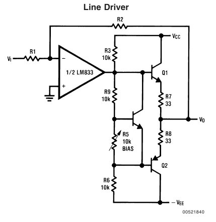

Hope this is the right forum. I am a desing engineer (mostly digital) and I have a problem with an audio circuitthat I kinda designed.
I have a bridge amplifier using BD139-16 and BD140-16 (see simplified rough pic).
It's part of a bigger system and we have made 50 of these. They were all kinda fine when testing the distortion with an AP (audio processor).
Now, another larger batch was made and ALL of them have huge distortion when testing on the AP.
I looked into it today with a signal generator and oscilloscope and I found that the output stage (Headset load = ~100 Ohm) seems to burst into a VERY (YES VERY)!! high fequency oscillation at a certain level and fequency of input. I have attached a rough sketch of what I get on the scope. The osillation is visible in the top half of the output waveform.
I have tried everything I can think of and so has my collegue. We are not able to solve it at this stage and we are desperate.
The oscillation frequency is actually 69.65MHz (!!!!!!!)
It all occurs suddenly when the sine peak reaches around ~1V.
Removing the BD140 transitor solves the problem but then of course, I can't drive the full voltage swing required.
Removing the BD139 makes not much difference.
Touching anything (the op amp output etc) with a 10:1 scope probe, changes the output waveform and it changes the level at which the oscillations occurs.
Lowering the 47 R resistor by adding a 120R in parallel, stops the problem but again, does not allow for the full voltage swing, if lower impedance loads are used.
We have tried caps across the 27k, 47R, output to gnd (47nF gets rid of the HF part but then there is a step in the output waveform). we have also tried various other caps and ideas but nothing helps.
How the heck can such a circuit oscillate at 70MHz???? We suspect the LM833 and that it may not be suitable for a bridge amp like this but then what is the alternative in 8 pin smd?

This looks like a rather crude amplifier!
First thing you should try is to put that integrating (compensating) capacitor to the full loop, i.e. attach the end it to the output (the common emitters) instead of to the output of the opamp.
You could also do a lot better in terms of the zero crossing distortion by adding and biasing the diodes and putting emitter degeneration resistors to the final transistors instead of in series to the output:

Hello all,
Don't shoot it down yet. I have attached the real schematic.
The crossover distortion is not bad as it is and the overall distortion is around 0.05% measured with the AP 70Hz- 10kHz (on the ones that do not have the problem).
I know about biasing and crossover distortion and I did originally have a current source bias network, similar to the ones you showed earlier. It worked fine but did not improve the overall quality/distortion enough to be worthwhile and thus we dunmped it again.
Please do not worry about the audio quality. It is actually quite good for this application.
I also cannot really change 100s of boards to a vastly different design right now.
The problem is the oscillations.
Did I mention 70MegaHz ? (Lower FM radio band)
None of the compnents (specially the LM833) should be capable to oscillate at such a high frequency but somehow they do.
I also know about Zobel networks and I made an attempt to add one as you can see from the 22R and 47n Restor /Cap on the output.

c23,24 are best for stability right where they are – but only effective below the op amp GBW
if the oscillation is really at 70 MHz then the op amp doesn't directly control it - nothing is speced, controlled by the op amp manufacturer at that frequency - changing manufacturer is not a "robust" fix
the likely problem is wiring inductance, parasitic C forming a local single transistor RF oscillator when the current in the Q is high enough to push the ft beyond the trouble frequency
Zobel on the op amp output, damping the Q base circuit is an option but requires decent RF gnd/ps bypass - or you could double the Zobel with one between each base-collector
decent RF ps and gnd, bypass could help - "Zobel" style bypass/damper arrangements can be much better than the naive parallel decade caps advice you often see - high
Q ceramic or film caps can give impedance peaks in the ps rail with the lead, wiring inductance
series base "stopper" R of a few 10s of Ohms is another – just one in series with op amp output could be OK
it may be possible to find a lossy ferrite bead core that could be slipped over the output
Q base leads before assembly
all of these fixes want to be physically, electrically “local” to the output Q

Hello all,
Sorry, the circuit is cut off. I can't show the whole circuit
The right side C27/C28 directly drive a 200 Ohm load, up to ~1Watt.
Both circuit halves behave identical and we can just concentrate on the left half for now. Bioth halves do NOT use the same pcb layout.
@geraldfryjr
Waveforms shown earlier, were taken with C109 / C110 removed.
When fitted, the output waveform changes. the HF oscillation is then no longer visible but in its exact place, one can see a drop / step in the sinewave. (sort of like the attached sketch).
@jcx
I sort of agree but not fully (see last paragraph on reason).
It all points to an oscillation caused directly by the output stage transistor(s). More so, I removed the collector on the upper transistor and the problem continued.
I also removed the collector of the lower transistor and I still saw a very similar problem. When I completely removed the lower ransistor, the problem was gone. It appeared to me that the base / emiiter junction of the lower transitor has something to do with it. - Not 100% sure.
HOWEVER:
Also seperately interesting: I had the same op amp as a spare, in another part of this circuit. It was connected as a voltage follower with the input connected with a 22k resistor to Vcc/2. I measured a strong EMC/EMI radiation from that chip peaking at 110Mhz. I picked it up after we failed the EMC test and I measured it with a near field probe on the EMC analyzer.
I was never able to measure it with a scope as it simply disappeared whenever measured. The only solution there was to remove the resistor and replace it with a link directly to VCC/2. Again, no caps and nothing helped.
So we can't rule out the op amp itself completely in the above problem asI have seen something similar before.

I haven't seen op amps oscillate at higher than their GBW - but it could be possible that the op amp's output Q have problems when combined with RF ps/gnd issues
supply, gnd bypass/damping, output series R or Zobel should help in that unlikely case
looking up the series: http://www.analogzone.com/acqt0814.pdf could be helpful
I wouldn't use the LM833 in any event - they were likely pushing the process capability before really good complementary/isolated processes matured
anything that can be driven to ordinary op amp ps/output V thru 22 Ohms in series per your schematic can be driven with some modern DSL driver op amps without external Q buffering - at low product volumes I don't count pennies (or even few $) in parts cost
