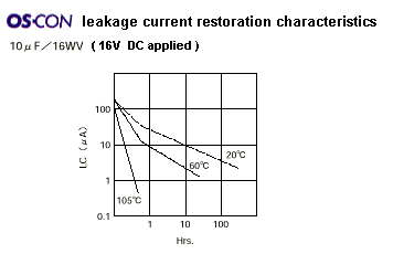

I just spoke to a cap manufacturer. He states that film caps, if made OK, should NOT need any extra break-in. HOWEVER, polar or aluminum caps need to be 'aged'. Usually full or more rated voltage AND heat. Now I know why my JC-1 caps take so long to break-in, they are so big. Thanks Bas Lim!
Hi John,
High voltage and heat are exactly the recommended treatment for leakage current, given in the Sanyo OS-CON Technical Book.
The picture shows the relationship of leakage current settling-time with temperature (full rated voltage applied). Still falling, even after 100 hours at room temperature.
More interestingly, the book advises that the high starting-value of leakage shown here may be provoked simply by (correctly-controlled) soldering, as well as temperature cycling, or higher temperatures (even with no load).
Soldering a capacitor of this kind into a circuit is enough to bring on a high leakage current, which remains, or worsens, while the amp is en route to the listener - unless you can treat it to a luxury heat bath of 60-70 deg. C for a couple of hours.
